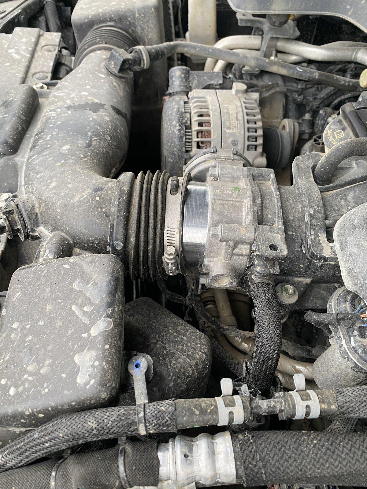

My JT sport (manual transmission) Has been throwing a few codes (mainly p000b/d, but a few others have popped up) just got back from dealership from repairing/replacing the rear seal, which I was hoping could somehow be the cause of the CEL since it was leaking oil/losing pressure. Got it back today, vehicle inspection sheet showed all in the green, but got in and found CEL still on but had to go ahead and go home due to needing to get back to work. After work, I inspected and found the intake hose was only halfway attached at the motor, reset cel and test drove but cel came back on, throwing p000d only. Definitely feels like a loss of power, hopefully can get it back to dealer tomorrow for further troubleshooting.

Code P000d is a pcm code and not a misfire code..
Could be related but if so I would think you would also have a misfire code. Seems you may have an entirely different issue.

Apologies for the mispost, I saw posts related to the camshaft and that’s what mine is associated to, so I figured it was similar. Thank you for clarifying!
