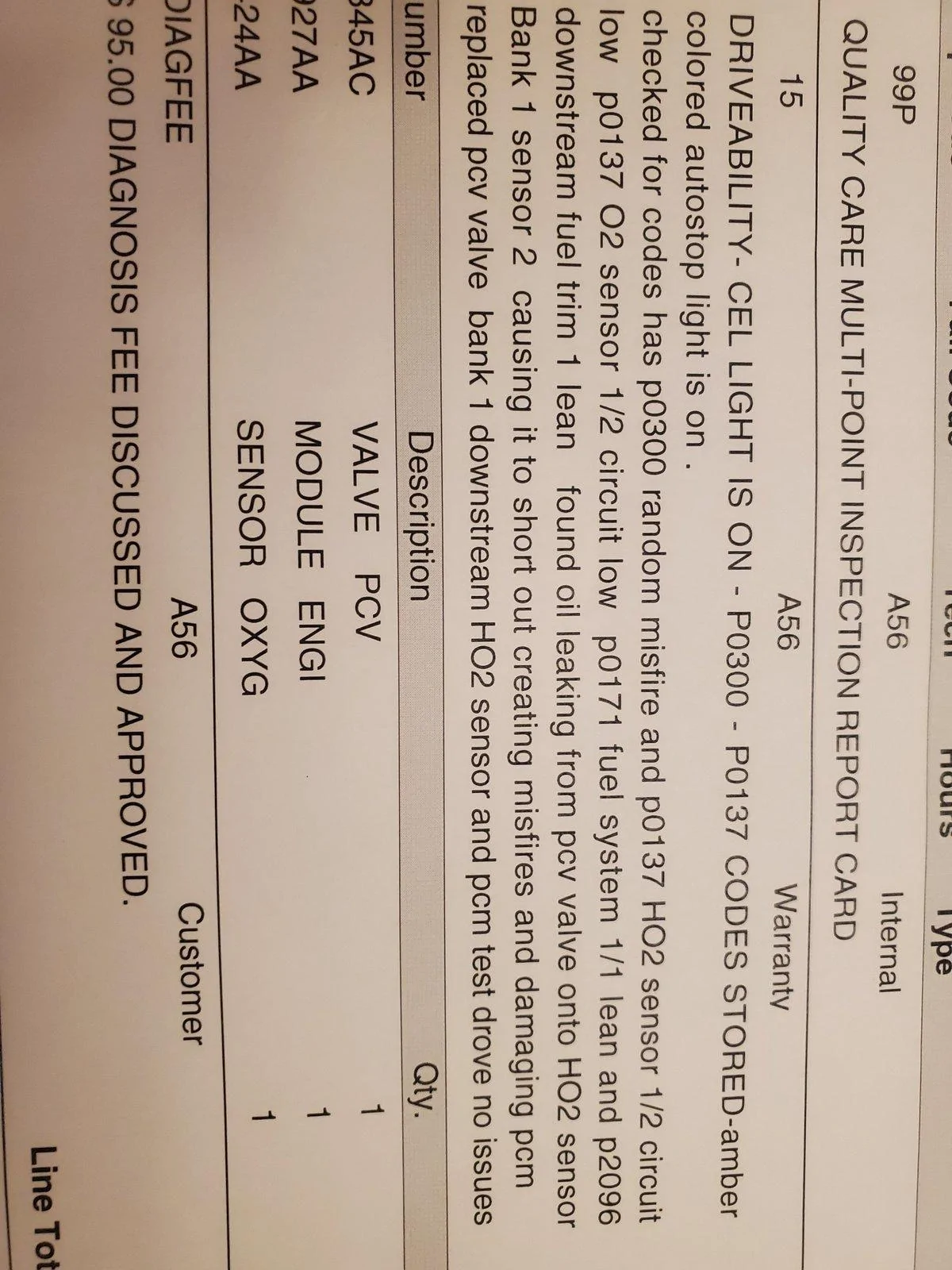

My 2020 Gladiator Overland purchased 9/12/2019 Stop/Go Light came on within the first week.. Then the check engine light came on. Misfire code detected and dealer cleared thinking bad gas. Then December 2019 same thing and dealer replaced all the rocker arms and one side of the head, keeping the Jeep from Jan 2 until Jan 10. Feb 15 on trip the Stop/GO light came on and started running rough and check engine light came on. Engine ran so rough it would hardly run and the check engine light started blinking. Called a nearby dealer who said blinking light and other symptoms made the car dangerous to drive. We left it at the dealer and continued our trip in a loaner. So far nothing useful from Jeep. Dealer thinks replacing engine will be required. I do not believe the engine is the problem. I think it is computer related. I have seen other posts where the engine was replaced and the problem reoccurred. The dealers have contacted Chrysler and followed instructions. Clearly Chrysler does not know what is causing this.
We thought the same thing. Replaced the ecm, but no change. Seems to have fixed the auto start/stop thing though.

If you have had the CEL light come on with misfire codes, please respond to this thread.
Build date: 8/16/19, 2020 Gladiator Overland, Delivery Date 9/12/2019 140 miles
Mileage when it first occurred: (1) Under 500, Dealer Reset Said Bad GAS, (2) 7108 on 12/18/2019 (3)10,000 =/- on 2/15/2020
How many times has it occurred: Currently 2nd major occurrence at out of town dealer since 2/15/2020
What exact codes did it throw: P0300
Is the issue on going? Yes
If so, what has been done to try to solve the issue? Currently replacing rocker arms and tappets, second 1/2 head and broken cam shaft. Dealer not cofident this will fix it.
Was the issue ever fully resolved? No
Stop/Start Failure warning light comes on every time. Check engine light5 follows and stays on. The last time 2/15 extreme misfires made engine nearly inoperable. Finally check engine light started blinging. Dealer said that was very dangerous.
Also, can anyone comment on the impact of oil pressure on every stop start incident? It loos like the oil pressure would drop at every stop and lag behind the engine restart.
