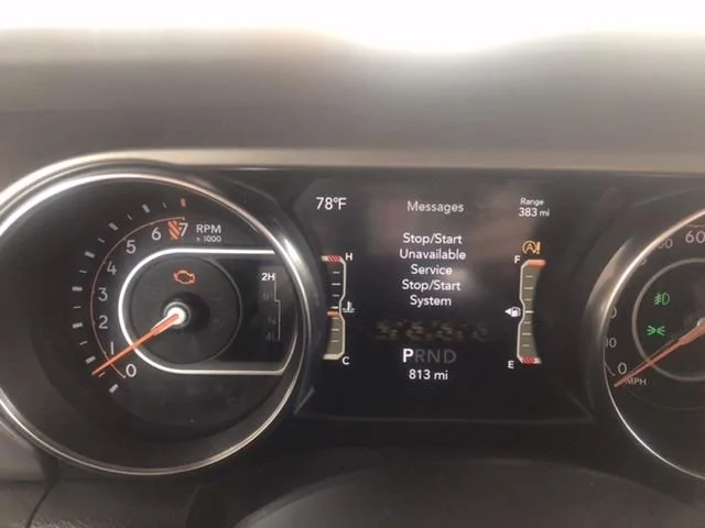

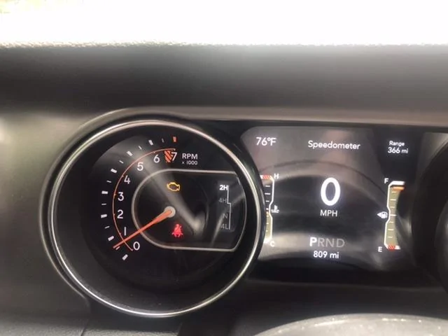

Build date: 12/2019
Mileage when it first occurred: 809
How many times has it occurred: 1
What exact codes did it throw: Not sure have service appointment today.
Is the issue on going? Y
If so, what has been done to try to solve the issue? Will hopefully find out today.
Was the issue ever fully resolved? Bought this vehicle on May 1st, 2020. Let’s hope we can get this resolved. My issue started the same way as many others here. Yesterday the CEL came on. I did the tightening the gas cap thing. Then I got the service the auto start warning. I remote started it as I left the office last night and it cut off in less than a minute. My hunch is that it will throw a misfire code. I love the truck. I will update. @JeepCares This is happening a lot on very low mileage Gladiators. How can we work with our dealerships to make sure the real issue gets addressed?
