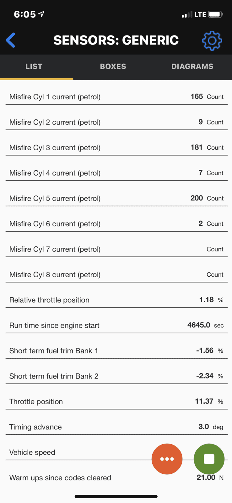

Tvose are very much in the normal range. You will get a few every now and then as the truck ahiftout of a high gear to accelerate. Or if you are doing 30 to 40 percent throttle pulls from a light. High load low rpm. With high compression you will see these numbers especially with low octane fuel.
Thank you for this info. I had been asking what is a acceptable normal amount of missfires. Like others who are heading down this road I have been data logging and seeing minimal missfires on 1 bank ( single digits) and multiple hundreds on the other but couldn’t find out what is normal in a modern engine.

I looked at some data just recently that leads to believe the injector trims may be a contribution fo this issue, explaining why you only see it on certain cylinders.

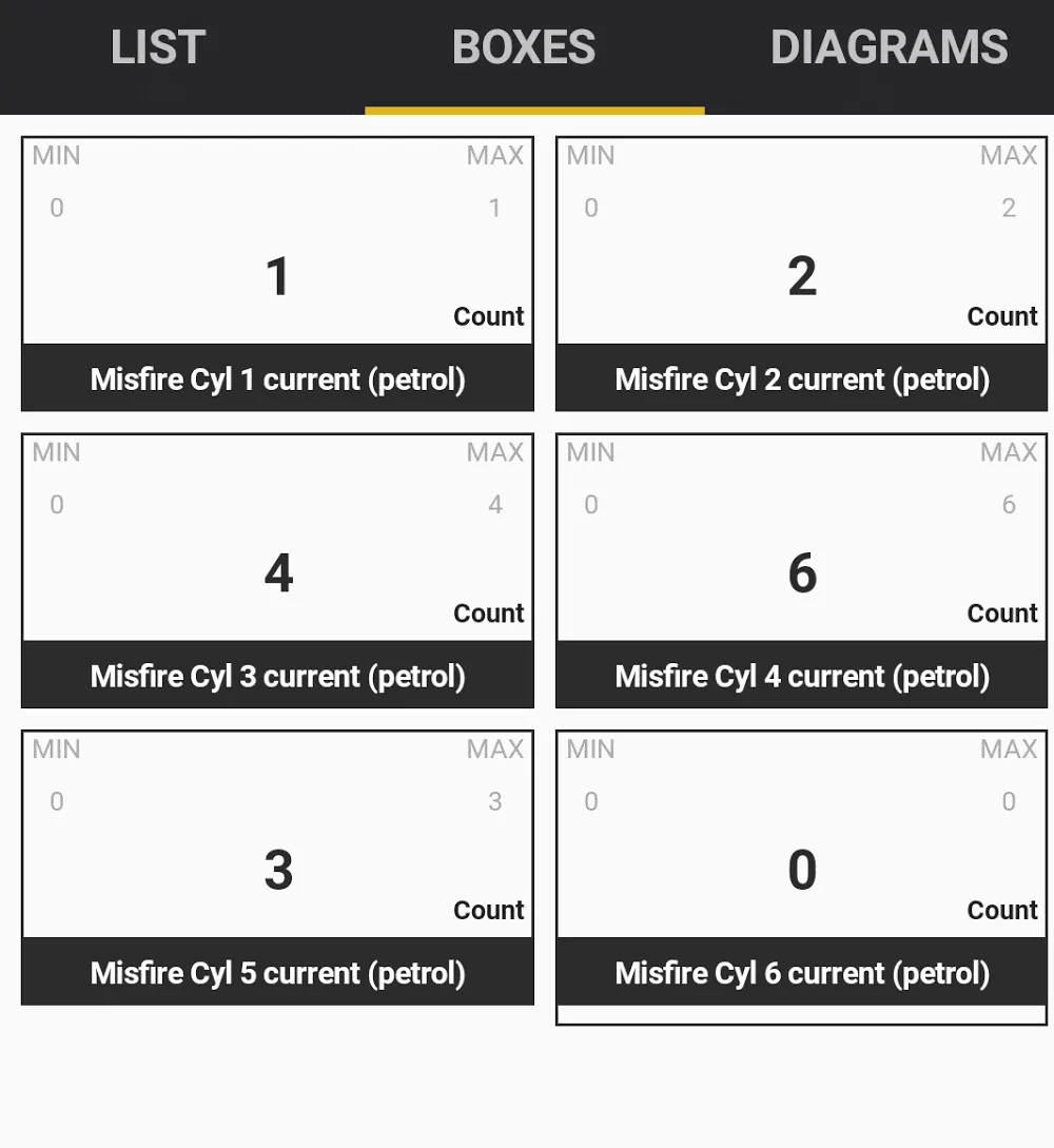

How many misfires are to many? This is from a 6.5 mile trip up to the store. The numbers were a little lower on the return trip. This is after the flash and replacing parts. I have not gotten a CEL or ESS light since the update but I have had times I would feel a stumble. Decided to log and see what I got.
Just curious what you're using to monitor the misfires while driving. Is it JSCAN type device or a handheld OBD2 scanner?
Thanks
Thanks
I’m using Jscan. The data is there but looks a little different
Yep, JScan. Just on the "Boxes" tab instead "List".
