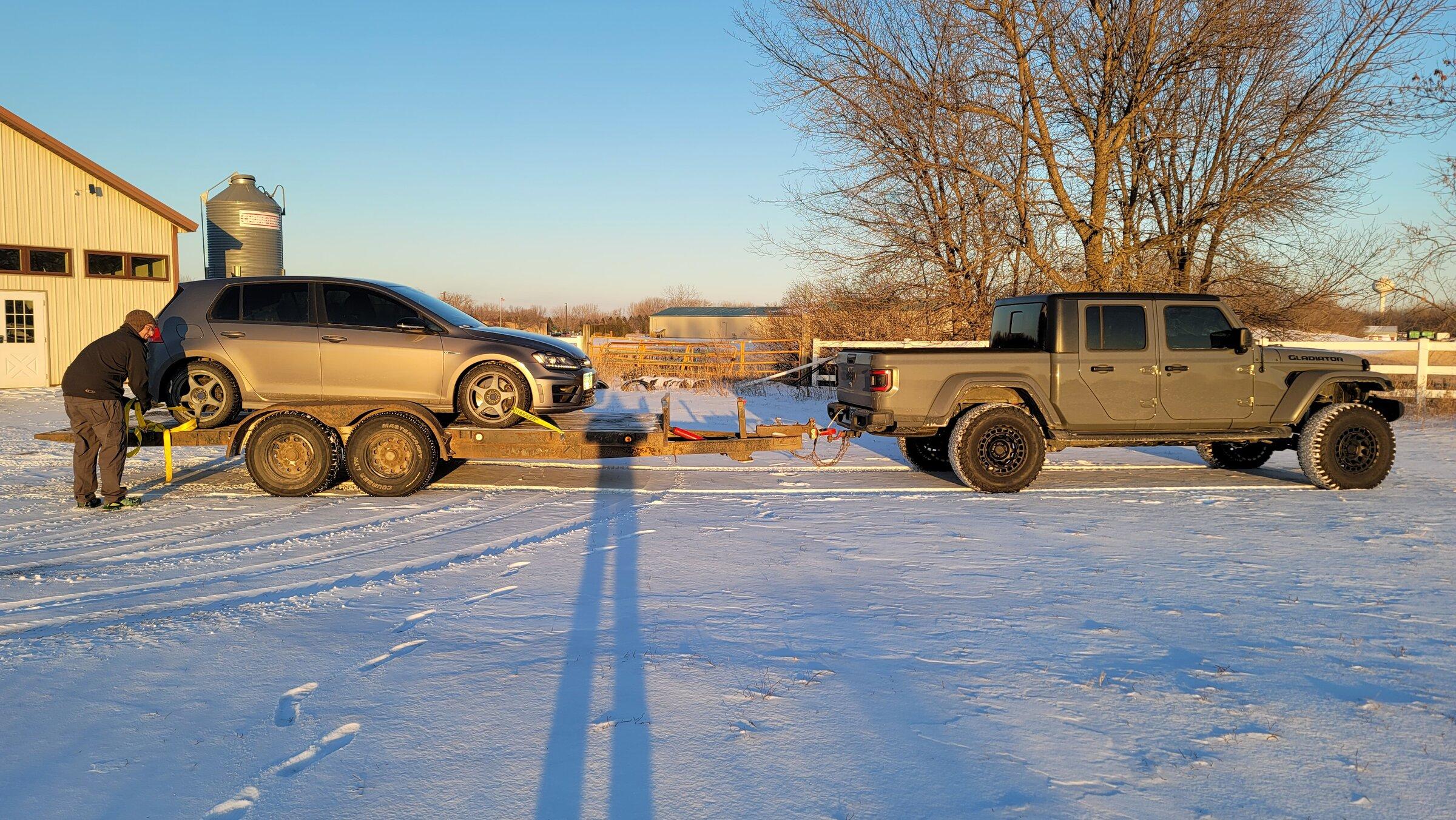

I had the serendipitous opportunity to do a short haul, and not having to dig deep into the RPMs was sure nice, much to Kurt's points above. I am loving the Gladiator more and more!
I will be doing a more comprehensive comparison by the end of the week.

Which tune where you on ?. You should tell these guys what gears your packing and towing like that.
Guys I am not advertising this as the saviour of motors. It MORE POWER and who doesn't like that.
And as a 45 year old father of two with a family, I know the importance, of not cashing out a 50K plus investment used as a daily driver. I have made my calibration as safe as I know how. There are anomolies and the download process is not as straight forward as I would like it. With that said I try to offer everyone as much assistance as possible as I am not in this to make money at this point.
If you want to move faster, tow better, and generally play offroad with more torque. I believe, I have a very viable alternative. Thats all.
I was running your latest P2 tune and I am running 3.73 gears with 35" tires. I had previously towed similar loads on the other kit with 33" tires, it had power but always felt like

3.73s and 35s? Now I'm really impressed.

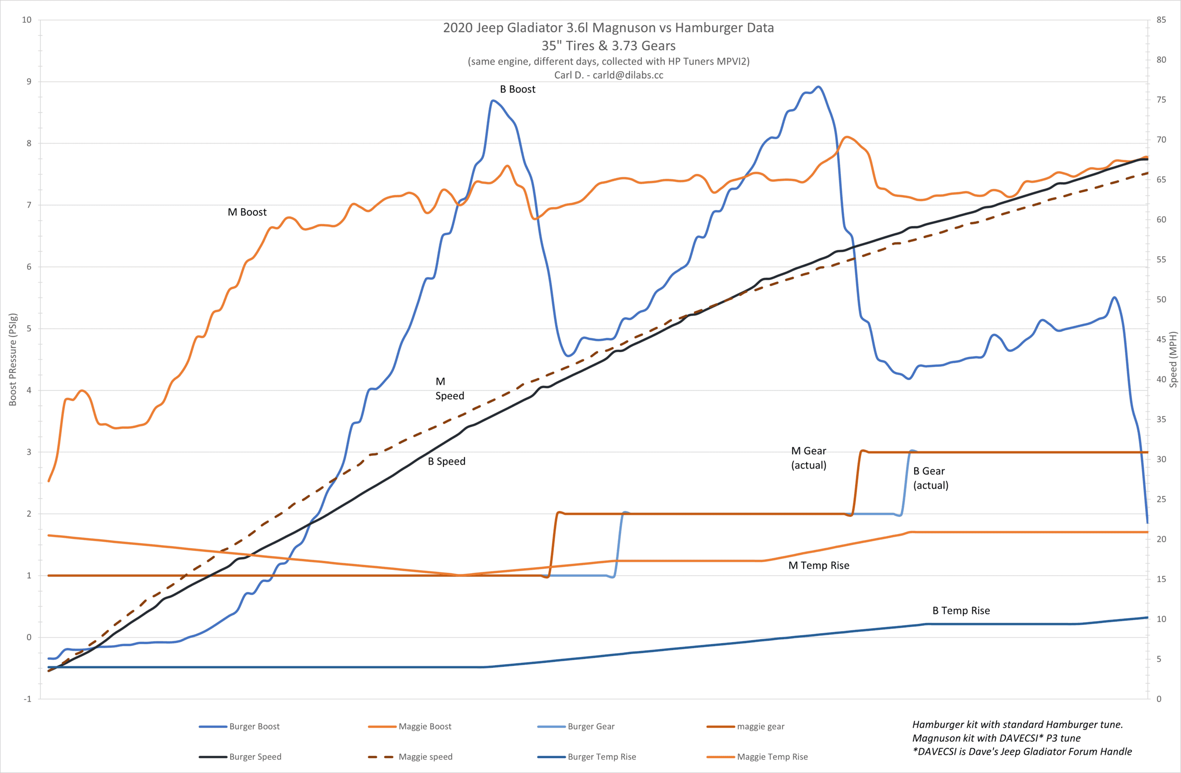

I am still working on my comparison but I wanted to share a graph comparison of both kits. I wish I had a dyno but in lieu of that, I logged some parameters I thought might be of value. The attached graph shows a comparison of the Magnuson to the Hamburger kit for boost pressure, speed, temperature rise, and gear. I wish I had been more thoughtful and methodical in my data logging for the burger kit, but as they say, hindsight is 20:20.
I had to align the two graphs as best I could. I haven't analyzed the data beyond creating the matchup, I am sure folks smarter and more experienced than I will spot obvious findings, beyond the differences in boost profile.
Our trucks aren't meant for WOT acceleration but this chart is still helpful IMHO. I recorded a 0-60 time of about 6.7s with the Magnuson, 35s, and 3.73 gears. Pretty surprising to me.
By the way, the X-axis is time, "B" references Hamburger and "M" is Magnuson.

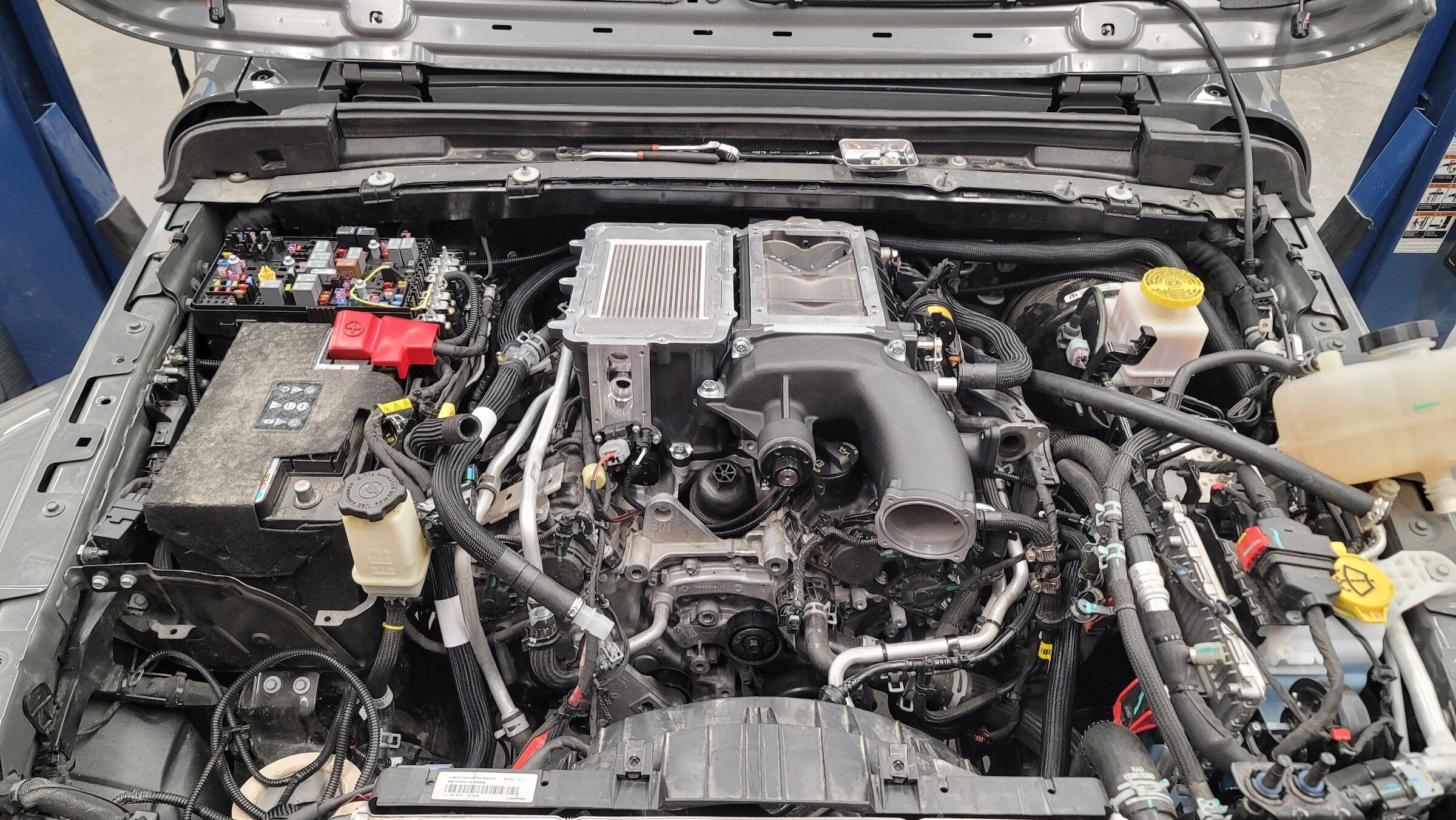

It’s important to understand where I am coming from to help put my perspective in context. I bought the Gladiator in May of 2020 because I needed the utility and tow capability of a pickup. I really liked the Gladiator. My daily driver was a high hp Audi S6 and I really liked the idea of having a vehicle under warranty. I bought the Overland because I don’t rock crawl and didn’t need the panache or utility of the Rubicon or Mojave.
With the exception of a 2500 Duramax and a few Jeeps, most of my vehicles have been either Audi or VW. None of them remained stock. From engine builds to transmission swaps to turbos, everything eventually gets modified. Having a few bad experiences with OEM and independent shops, I do all the work myself, except tuning, because the work done by others typically needs to be redone. The closest I have gotten to tuning was recoding an Audi S8 ECU for a manual trans. It was a mind-bending and time-consuming effort. I learned tuning is not my gift.
The initial selection
After a few thousand miles on the Gladiator, I found the power delivery to be uninspiring at best. I felt I needed to wind it out to accelerate, pass, and tow. On top of that, the engine sounded terrible at higher RPMs. I wanted a power adder and a warranty, so I narrowed options down to the Hamburger and Magnuson kits. I decided on Hamburger in June 2020 because they agreed to honor the warranty with a self-install, Magnuson didn’t and there were reported drivability issues with the Maggie.
The repower

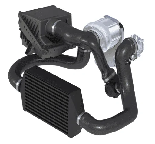

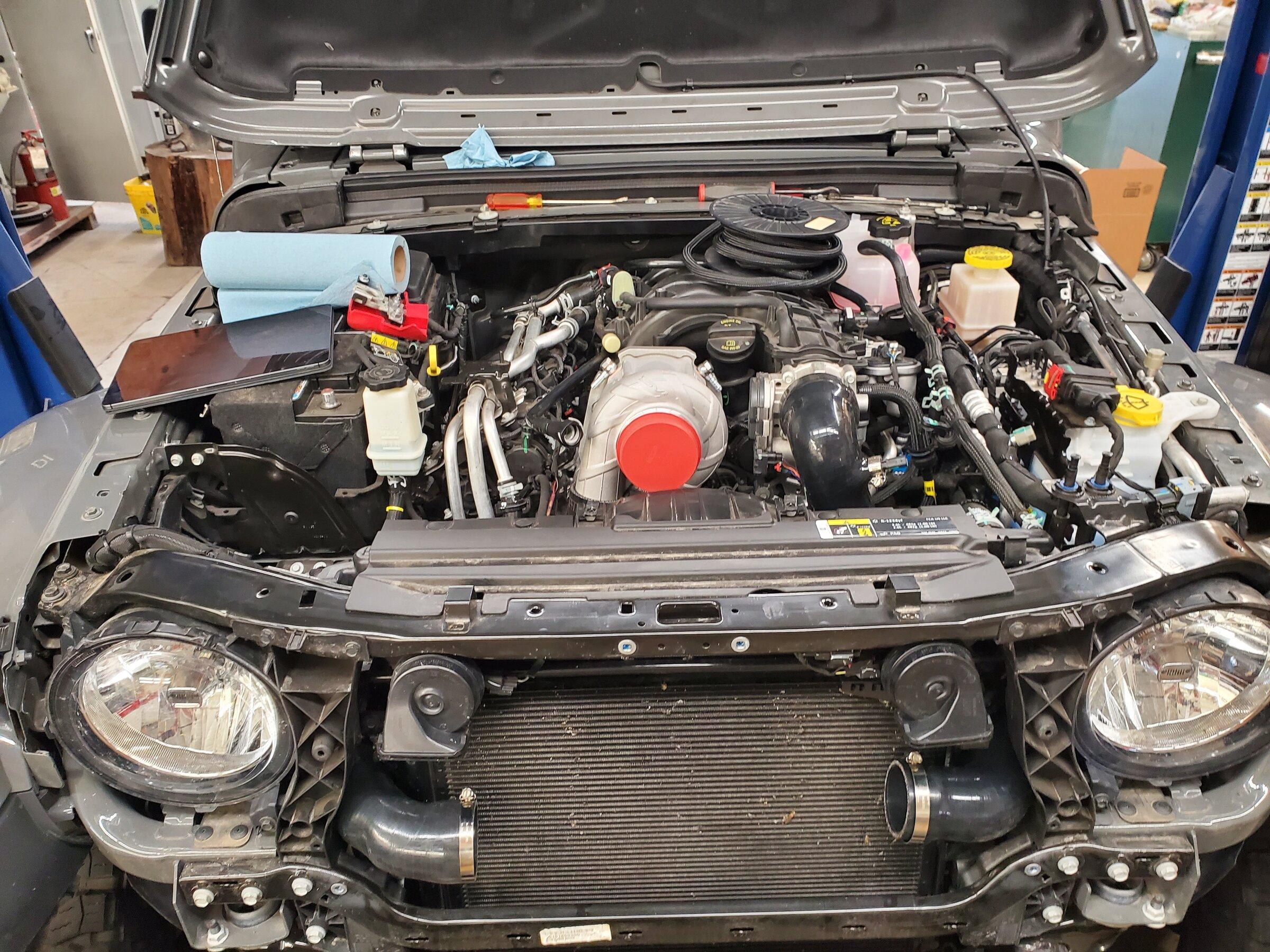

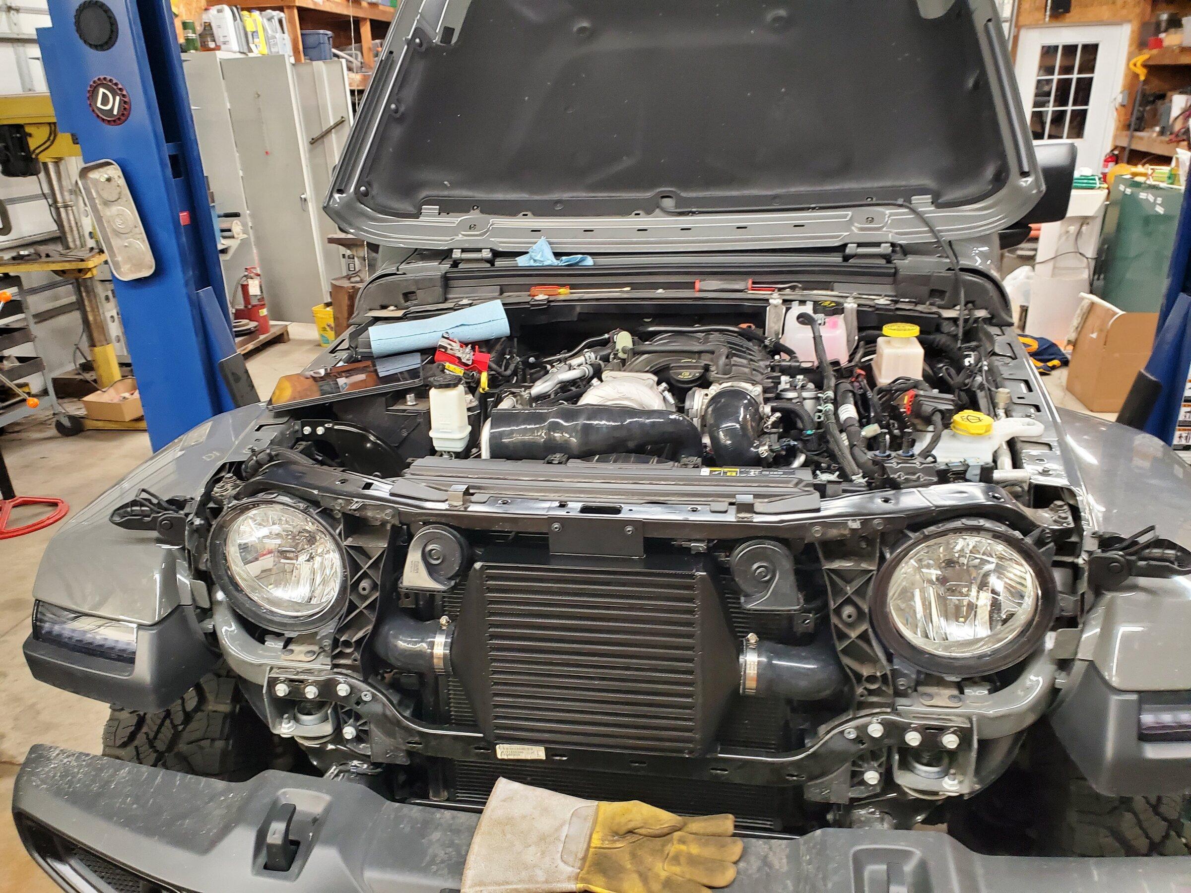

After a year of the Hamburger kit, I decided I wanted a better power delivery (low rpm power). I kinda considered trading for a diesel and seriously considered a Hemi swap both as a DIY and having it done. I did a ton of research and nearly called to make an appointment and came across Dave’s Magnuson crib notes with the updated tunes and smaller pulley details. So I decided to try the Maggie.

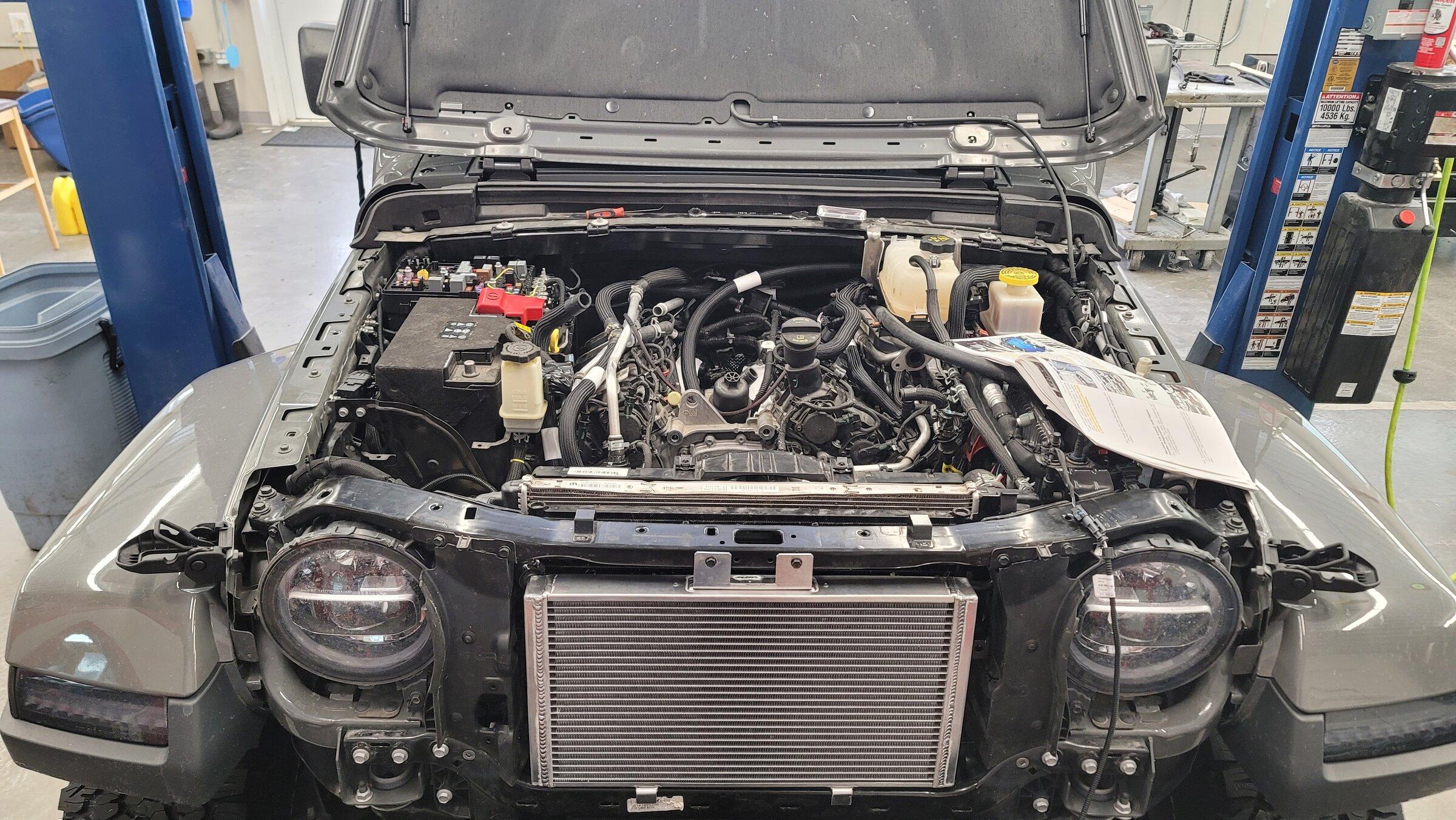

The Hamburger Install
The installation of the Hamburger kit is straightforward. There is some trimming of factory parts (airbox, radiator support, fan shroud), and while this sucks it’s not that big a deal. There are fewer components to the Hamburger kit and it is easier to install than the Magnuson. However, the installed product is not as OEM feeling as the Magnuson. Everything can be removed and the Jeep returned to stock but there are birthmarks left. The alternator wiring harness is modified for the relocation, I am replacing the modified wiring with a stock harness.
The instructions are okay but there are some unclear aspects and in a few cases I thought there were better ways to approach certain activities. All of the individual hardware and components were bagged and lettered, the included packing list was a great reference.
Jeep Gladiator Switching from Hamburgers to Magnuson Picture1
Jeep Gladiator Switching from Hamburgers to Magnuson 2020-07-18 10.17.10
Jeep Gladiator Switching from Hamburgers to Magnuson 2020-07-18 20.15.03
Jeep Gladiator Switching from Hamburgers to Magnuson 2020-07-18 21.38.42

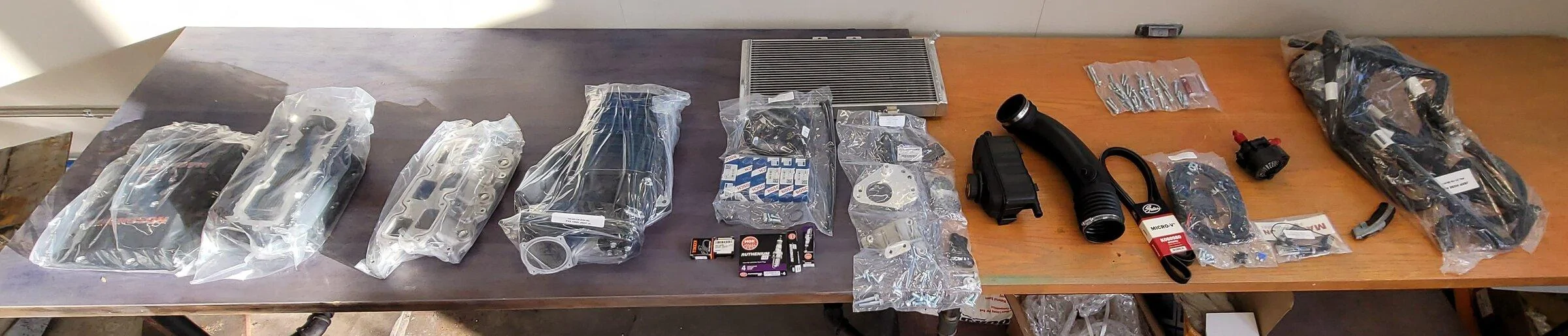

The Magnuson Install

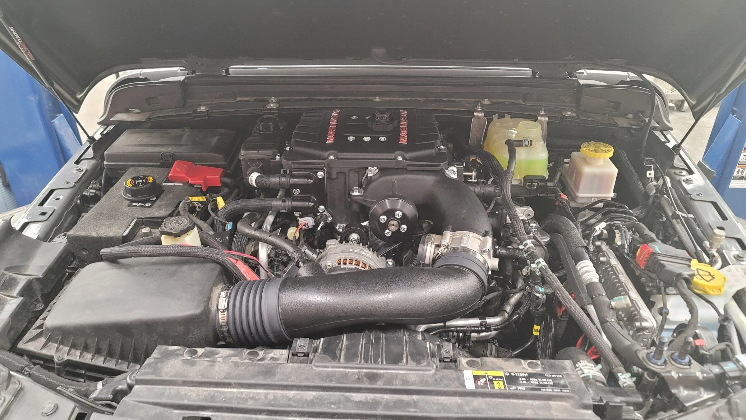

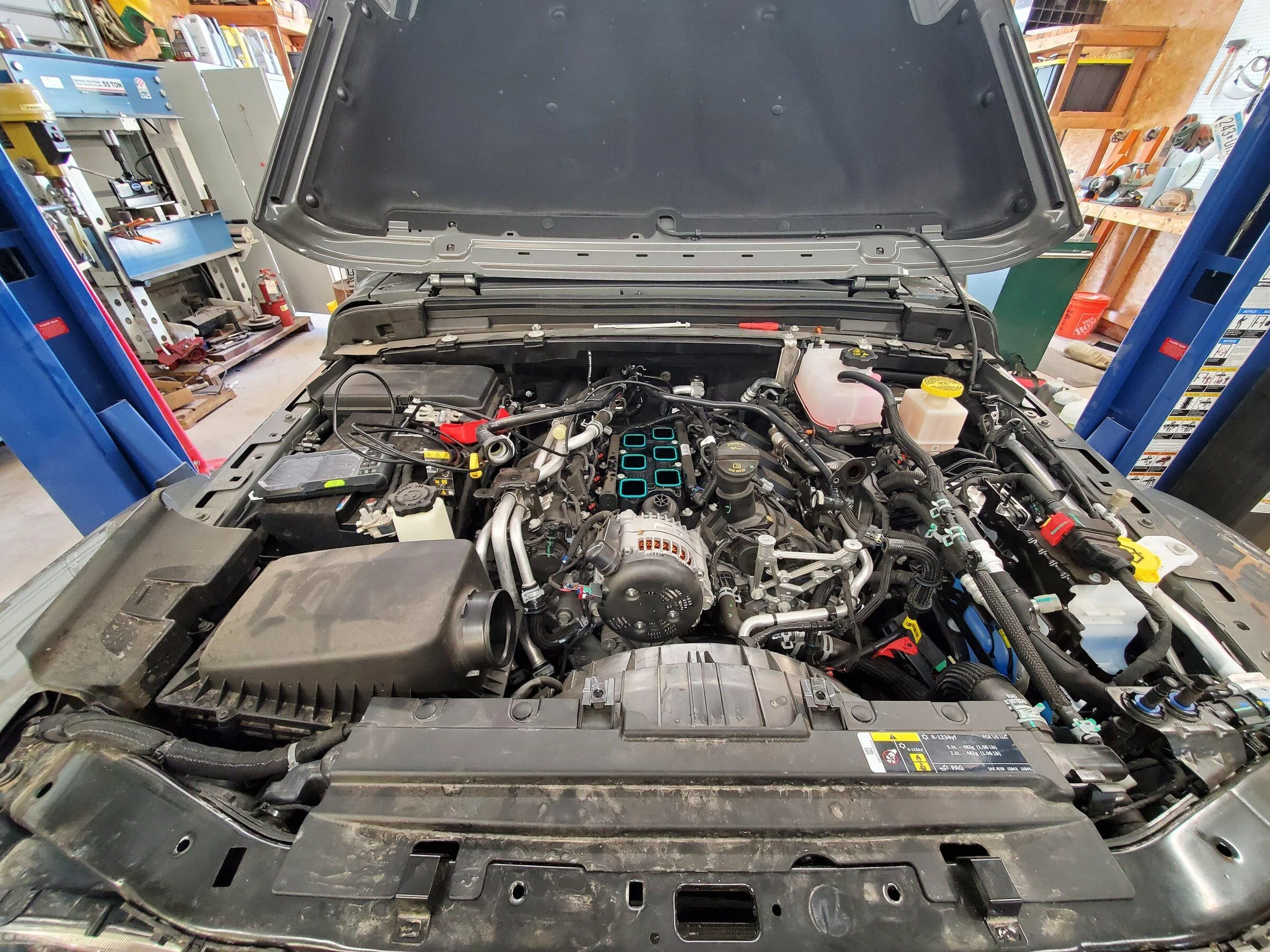

The Magnuson kit was packaged extremely well, all of the hardware was segmented in heat-sealed bags. The Magnuson components just look amazing, it all felt like it came from the factory (or better). The installation was straightforward but time-consuming, I got the install done in a day. The removal of the Hamburger kit was about 6 hours. Removal and installation were both done in a methodical and comfortable pace. Dave’s crib notes were very helpful for early upgrades of the pulley bearings, plugs, and sensor positioning. My only gripe would be that the hardware (nuts & bolts) packaging wasn’t labeled. This is a simple but meaningful thing that Magnuson should do.
I found the instructions to be well-constructed and thorough. A couple of the photos in the instructions were at weird angles or perspectives which required a little creative orientation.
Jeep Gladiator Switching from Hamburgers to Magnuson Maggie Parts cropped
Jeep Gladiator Switching from Hamburgers to Magnuson 2021-12-19 14.36.26
Jeep Gladiator Switching from Hamburgers to Magnuson 2021-12-19 16.22.17
Jeep Gladiator Switching from Hamburgers to Magnuson 2021-12-19 19.37.36
Install Comparison:
Either kit can be installed by a competent or experienced shade tree mechanic in my opinion. However, this is not a job for a minimalist tool collection. Having a proper set of mechanics tools and accessories is important. The Hamburger is “easier” to install but the Magnuson looks more polished.
Driving Comparison:
This comes down to preference and usage. I felt the Hamburger kit was powerful but always required a gear change to get boost. It was nearly always in vacuum unless I was WOT or pushing it. The Magnuson is pushing boost most of the time (for my driving style). I love that going up an incline or accelerating with the Magnuson results in boost pressure then shift, if necessary. I have seen a couple of lbs of boost all the way down below 1,500 RPM (of course this is the nature of the beast). I towed a ~6,000 lb load with the Magnuson this week and I appreciated the ability to modulate boost pressure with the right foot without requiring a shift and high RPM. It made for a more docile experience, which is exactly what I wanted.
It is too early to make an mpg claim, but it seems the Magnuson setup is thirstier. However, it might just be my ears prefer the whine and shift sound more ?. I suspect there won’t be a major difference in gas mileage between the two in the long run.
I was happy with the Hamburger but I am happier with the Magnuson. As shown in the graphs in the previous post, the WOT acceleration nets about the same result between the two kits. There are pros and cons of each configuration.
