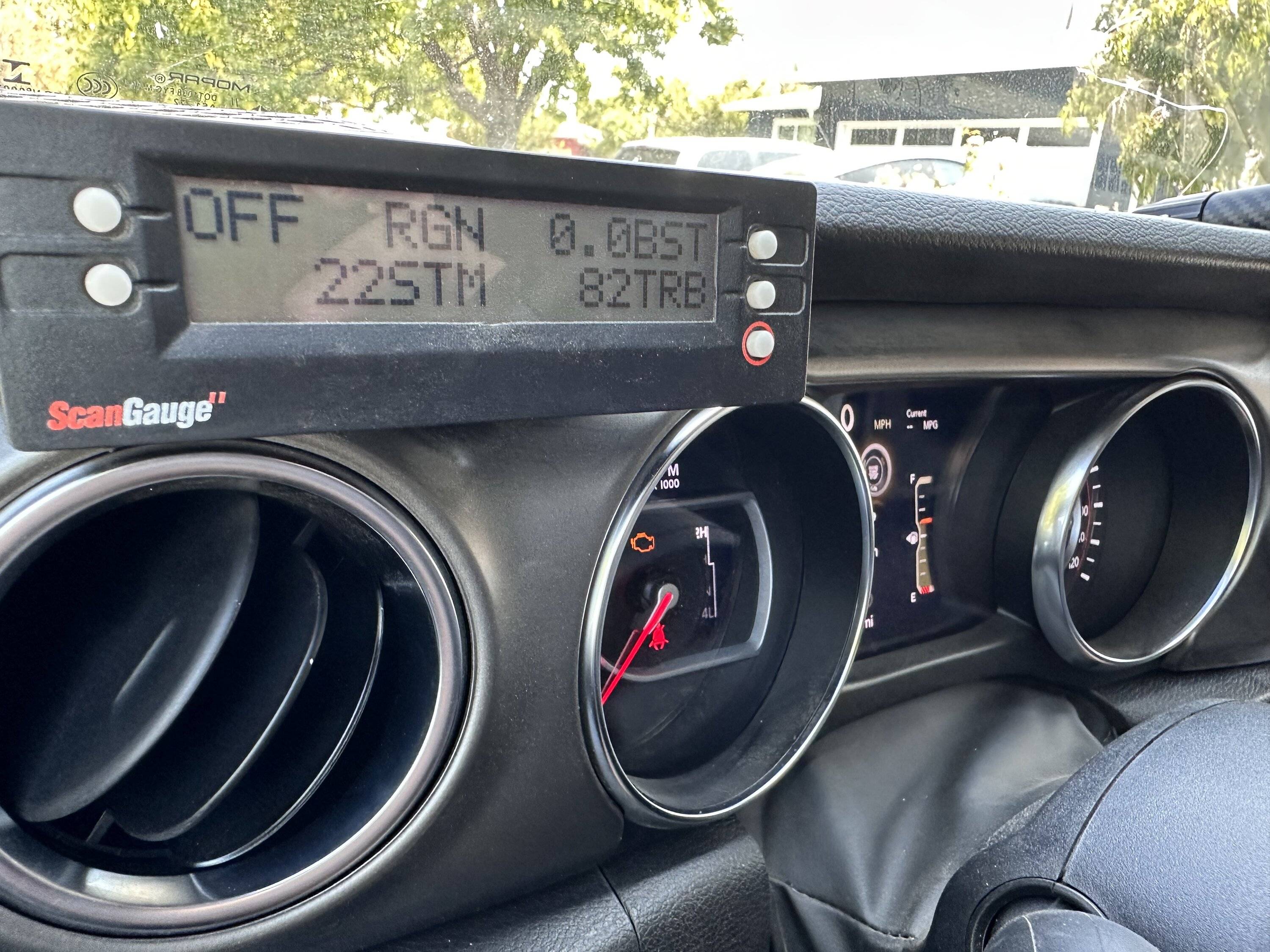

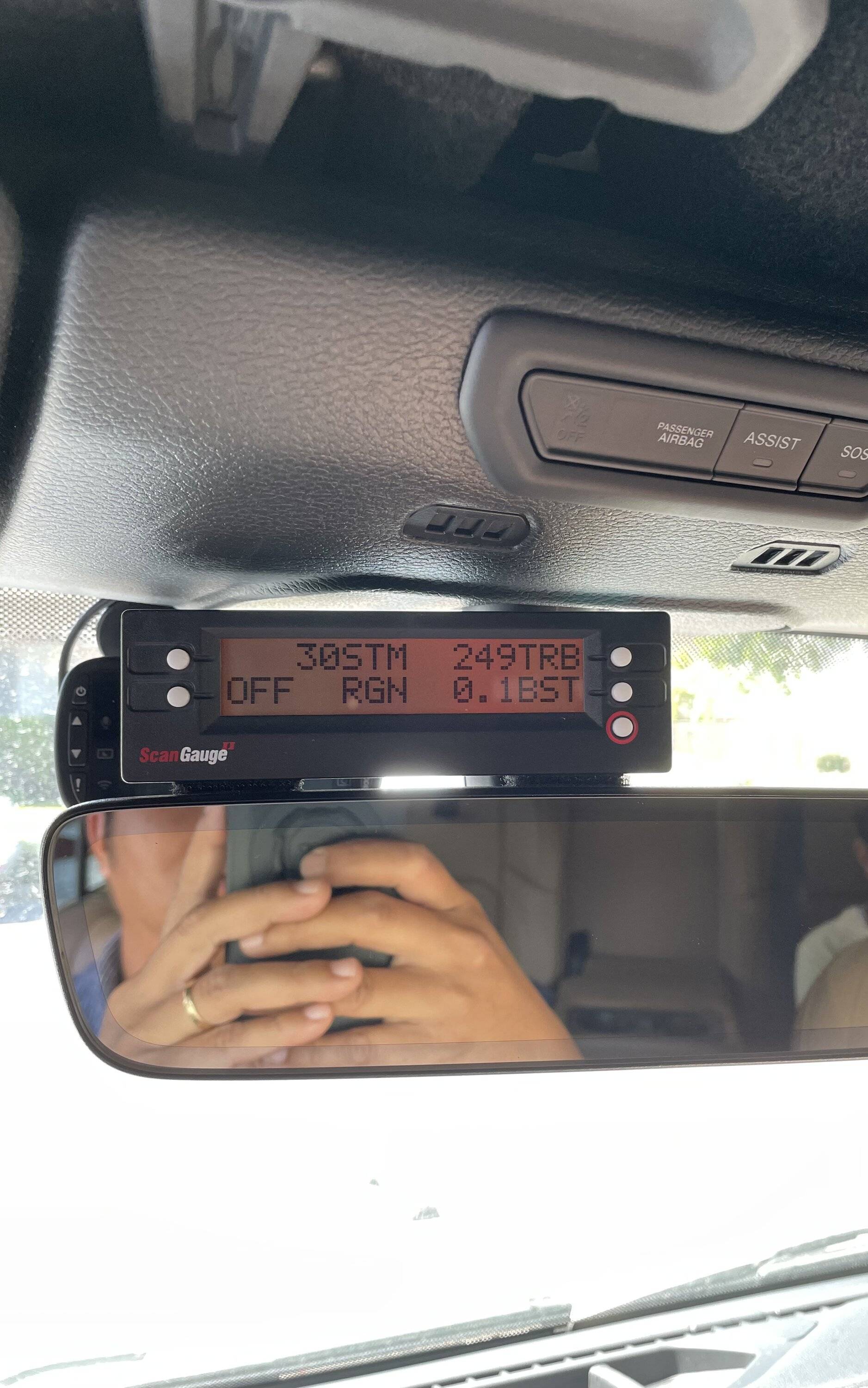

I set up the same four: regen on/off, soot mass percent full (STM), boost (BST), turbo housing temp (TRB)
I started with the scangauge on top of the dash. Worked for me but blocked some visibility for my shorter lady. I like this spot, very inconspicuous and install is super easy

Im looking at the scangauge III... but it's atleast $120. more than the Scangauge II. Currently trying to figure out if the nice color touch screen, multiple page views and added functionality are worth it. The more user friendly and convenient, the more likely I would use it as designed... so leaning towards biting the bullet and paying extra for the SG3.
Anyone have any experience with both versions ? The SG3, comes with a window suction mount, so it will tuck away nicely up in the left corner of the dash, just in front of the dash speaker...
Anyone have Pics of the Scangauge III mounted up ?

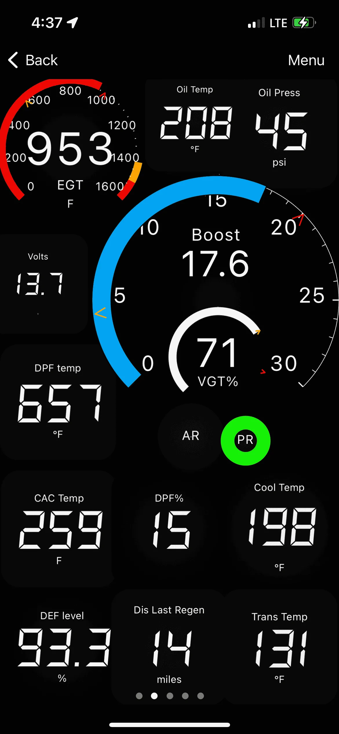

I used OBD Fusion app and the Veepeak OBD adapter. Total cost $40. Easy option. When the active regen (AR) light comes on I keep driving until it’s done. That simple.

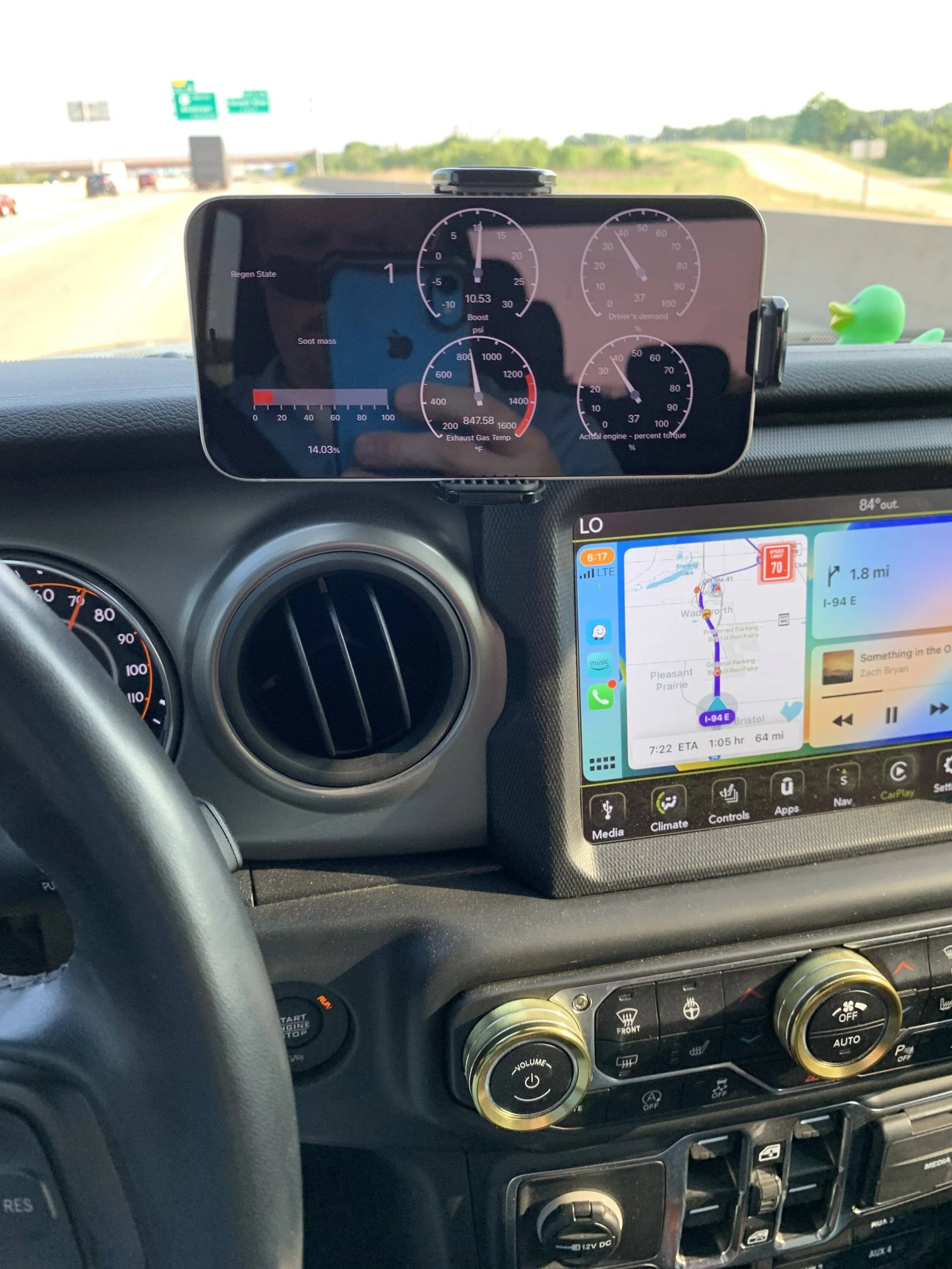

Do you ever have any "connection" issues ? I have read ghat the Bluetooth adapter/app method has connection and information lag issues. This is why I was leaning towards a direct connection.
The question wasn’t for me but I have no connection issues whatsoever with the adapter I use. Connects quick and is almost in lockstep with oem gauges for the same data points. Nice thing about the Bluetooth route is flexibility, there when I want to use it and easy to put away if not.
What app are you running ? I have my phone mounted like you, so no need to make any adjustments. Could you possibly gice a clear shot of your screen and explain what you are displaying ? Thanks
