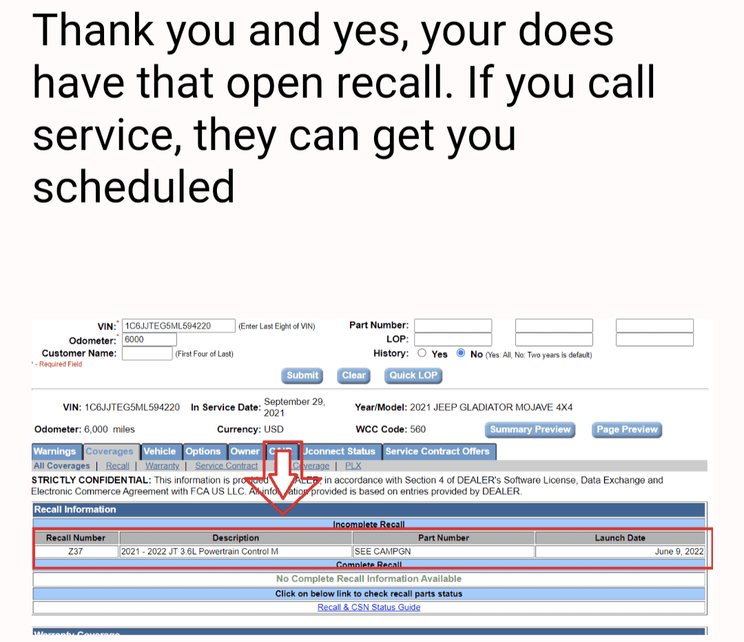

I had shared this with my dealer yesterday and they followed this today and just called me and I am picking up my truck tomorrow! I provided it to them before they saw it.

Well sharing my PCM plight on this Gladiator Forum paid off. The bulletin someone shared yesterday I provided to my dealer and they followed the bulletin and I am picking up the Gladiator tomorrow. Thanks to the person that shared this...
Case Number: S2218000012
Release Date: June 2022
Symptom/Vehicle Issue: While performing the PCM reprogramming portion of Recall
Z37, the process fails at approximately 20% progress.
Discussion: If PCM reprogramming fails, please remove the radio fuse (F97 in under
hood PDC) and attempt the PCM reprogramming process again.
