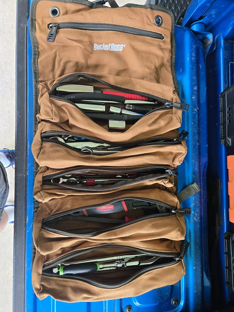

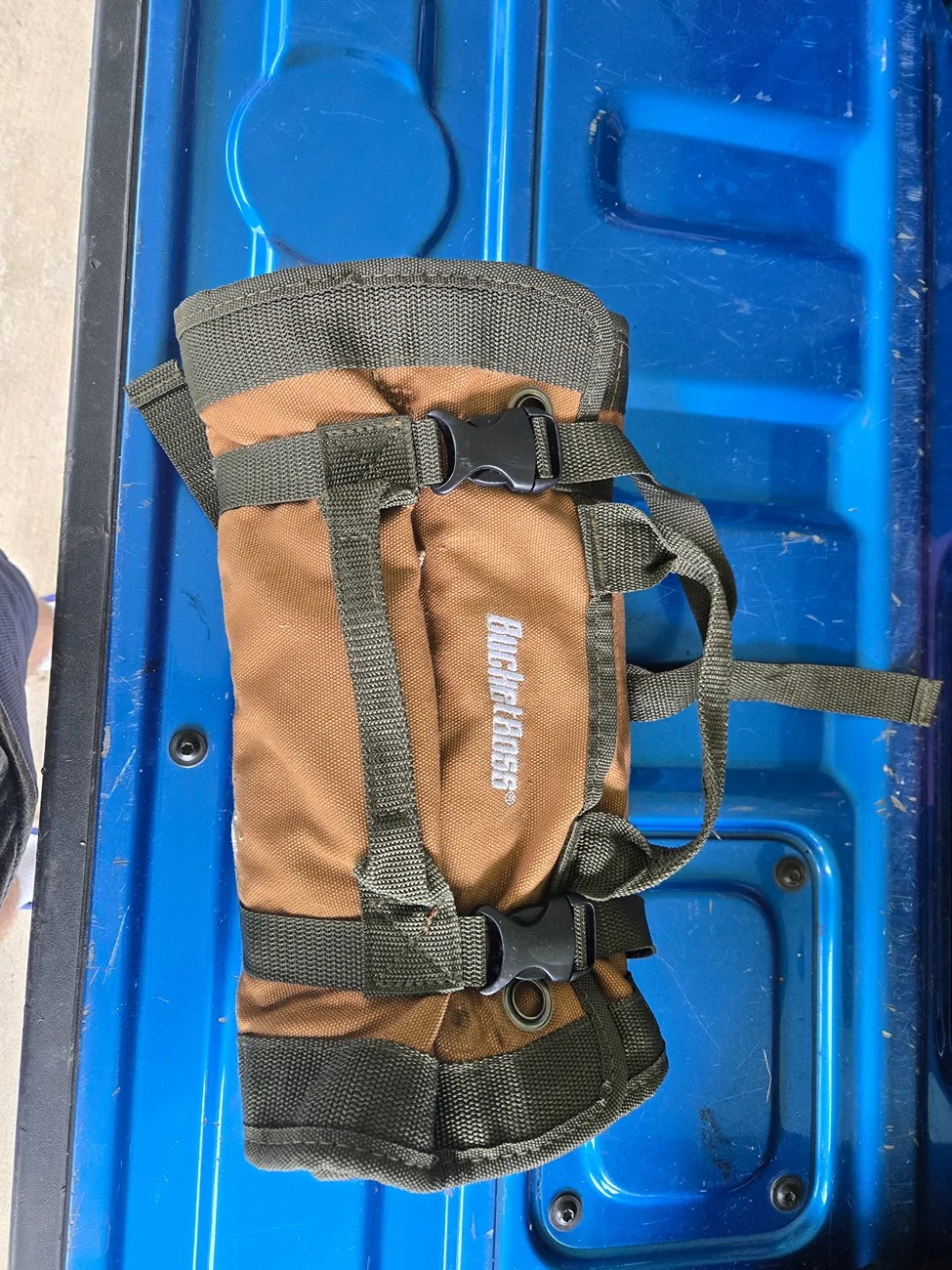

I've been using one of these for the past few years, and it has held up pretty well.
https://a.co/d/03s9qXNF
The only issue I have with it is the depth of the wrench pockets on the back. Some of the larger sizes get to be too long, so I ended up moving those to a front pouch. I keep a complete set of standard and metric wrenches in the back.
On the front, from the bottom small pocket up is:
1. 1/4 drive sockets, socket wrench, 3" extension, 6" extension, allen wrench set, and torx set
2. swivel head 3/8 socket wrench, 3" extension, 6" extension, 10" extension, 12" extension, and the 3 wrenches that don't fit in back. (I carry a 3/8 Quinn socket set separately as its significantly easier to keep organized)
3. complete set of phillips drivers
4. complete set of flat drivers
5. 2 adjustable wrenches, channel locks, vice grips, needle nose, snap ring plies, 6" pry bar, and a handle that holds saws-all blades that folds up like a pocket knife.
It's pretty heavy, but it covers 80% of my needs

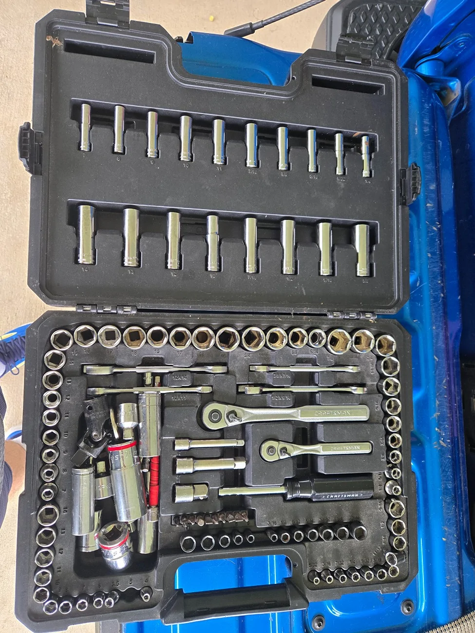

I have Quinn and Pittsburg for sockets, pliers, and wrenches. Icon is a 1/2” driver that I really don’t want to break. It’s big and beefy and if I lose that doing trail repairs then I’m blind. Hammer is a mallet I picked up somewhere at some time and I don’t even know the brand. It won’t do for framing all day but it’ll whack a Jeep back into compliance.
I bought a Quinn set. I do not like their arrangement in the plastic case. It is also not a complete set for ¼ ⅜ and ½ drives. They are okay however, just a bit better than HF sets.
To the OP, Quinn and HF sockets are perfect tools for the trail. You will not think twice about that missing 10mm. HF wrenches are awful. Go to yard sales and get some used Craftsman wrenches.

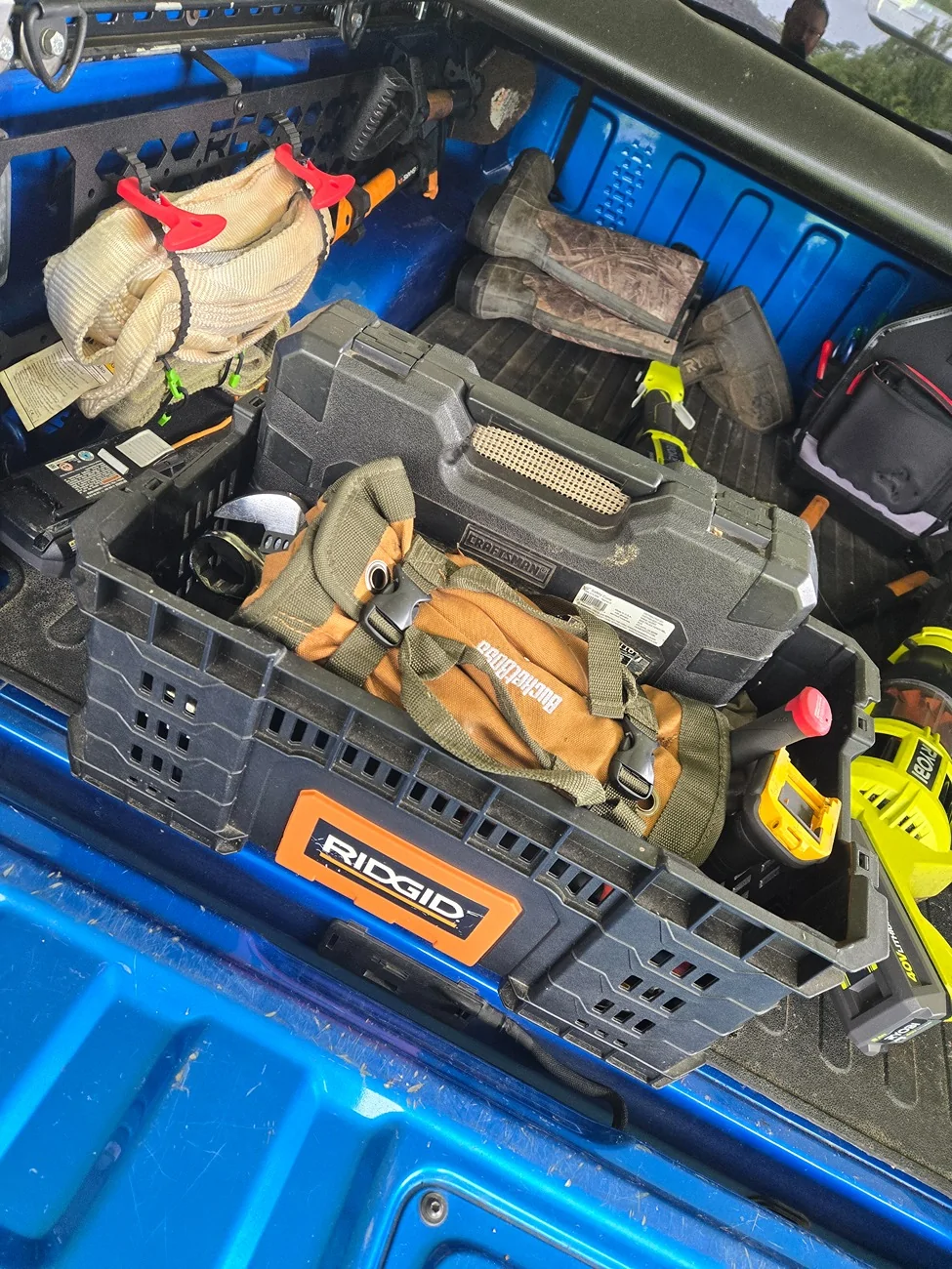

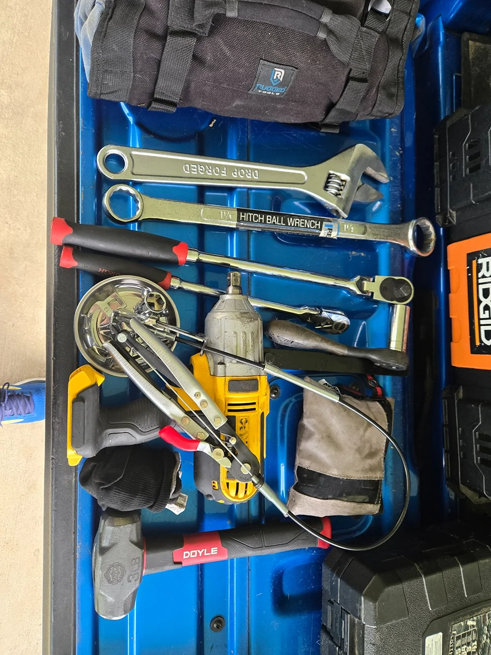

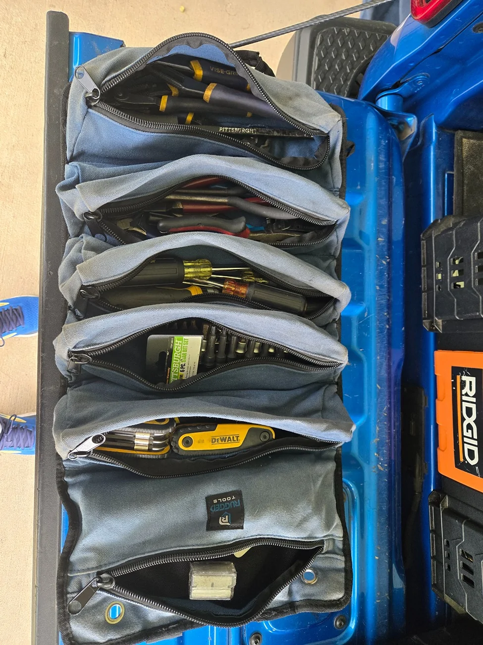

There are some duplicate / redundant tools in there - i'll sort that out before the Moab trip next month.
Or maybe not. It hasnt hurt me to have them yet.

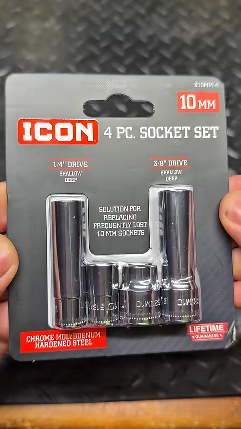

biodiesel
Dec 8, 2018
2,552
3,316
New Mexico
2015 Ram 1500 Ecodiesel
And if it's a 10mm? Doesn't even need to move, you take your eyes off it for a second and it's vanished...
That's why Harbor Freight sells the Icon 10mm socket set, which they just gave out for free this past weekend. I think I have three free sets.
