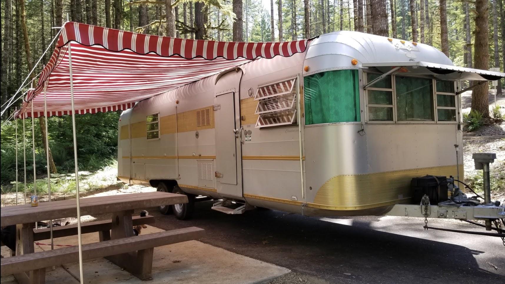

We have a vintage '31 Silver Streak trailer that maybe weighs about 7,100 lbs, fully loaded. We currently pull it with an old '99 Suburban 2500 with the 7.4L / 454. Due to the 3.73 gear ratio, tow capacity is at 8k. Tows the trailer with no problem at all.

Can't help with your questions, but what a beauty of a camper! A lot of love apparent in that one. Very nice.

That's a nice trailer, and they I'm sure you know have a following and command a premium, so if you're not attached to it........

Thanks. Yeah, it's been a bit of work. But pretty fun. And doesn't look like EVERY other trailer in the campgrounds.
I'd buy a Power Wagon.
I've considered a Tundra for a new tow rig, but they're not made to take the top and doors off! If don't end up keeping this trailer, we'd probably sell it and buy a slightly shorter / lighter version without too much additional investment. We've put a lot of work into fixing this one up, so it'd be nice to just keep it.
