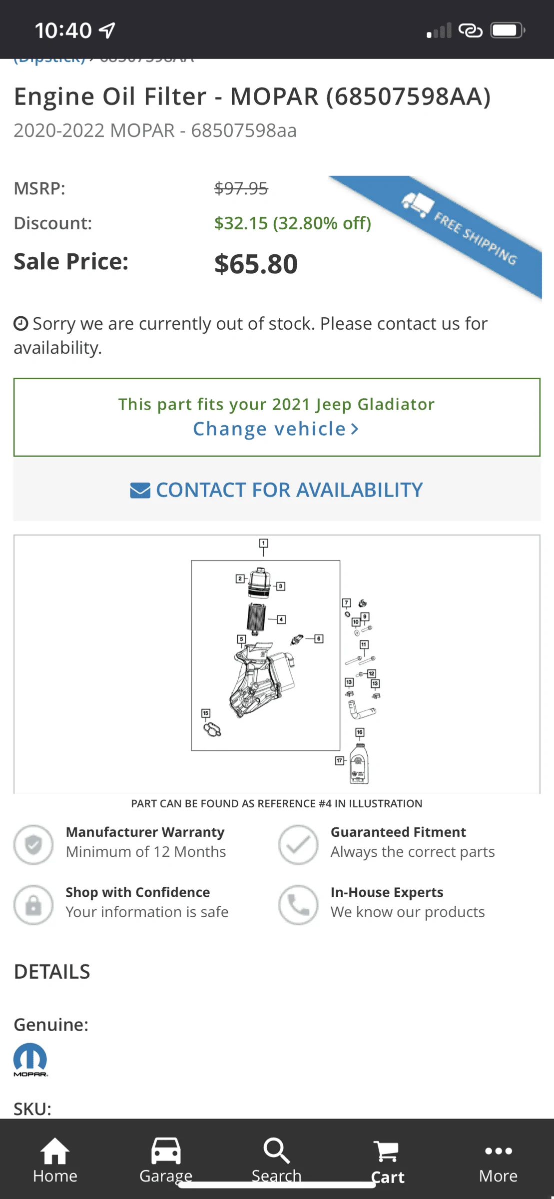

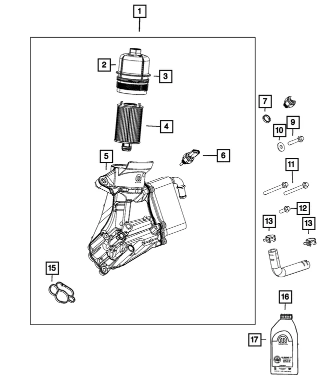

Question:
This auto parts store said they could order filters for $14ish. The filter does not come with the filter cap. If the filter cartridge or element can be removed and a new one be installed is there an issue?

Guys, you cannot, I repeat cannot use the older filters and cap on the new EcoDiesel gen 3. They are totally different. FCA has put out service bulletins to there dealers on this. The filter is a different diameter and height and the bypass valve is totally different. If you use the older filter you will actually be bypassing the filter and putting "contaminants" into your sump. The older filter is not even the same connection points in the cap. If you cannot get a filter from your dealer use the only other filter on the market the ECOGUARD S11880. I truly believe they are the same filter. Both are made in the same plant in Asia. I have used the mopar and ecoguard and they came in the same box!!
