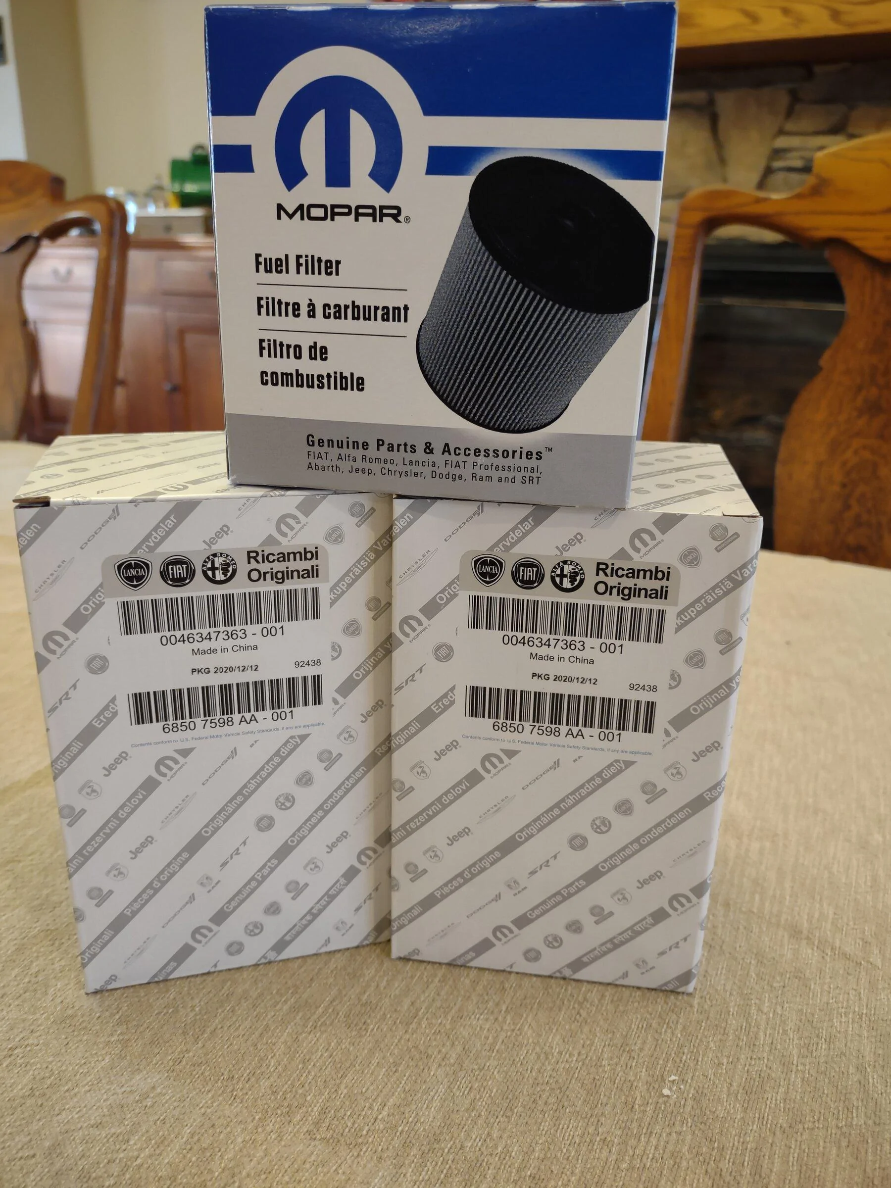

I do my own changes. I’m able to source genuine mopar filters and Valvoline 0w20 full synthetic from Autozone. I also added an oil pan valve to make it effortless with no mess.

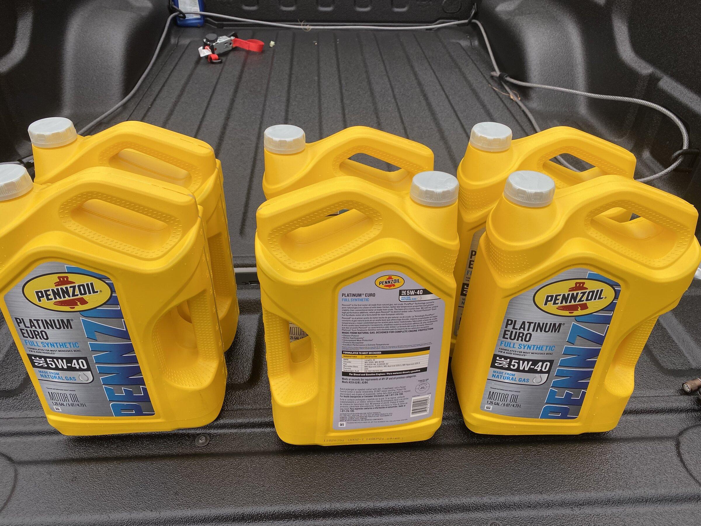

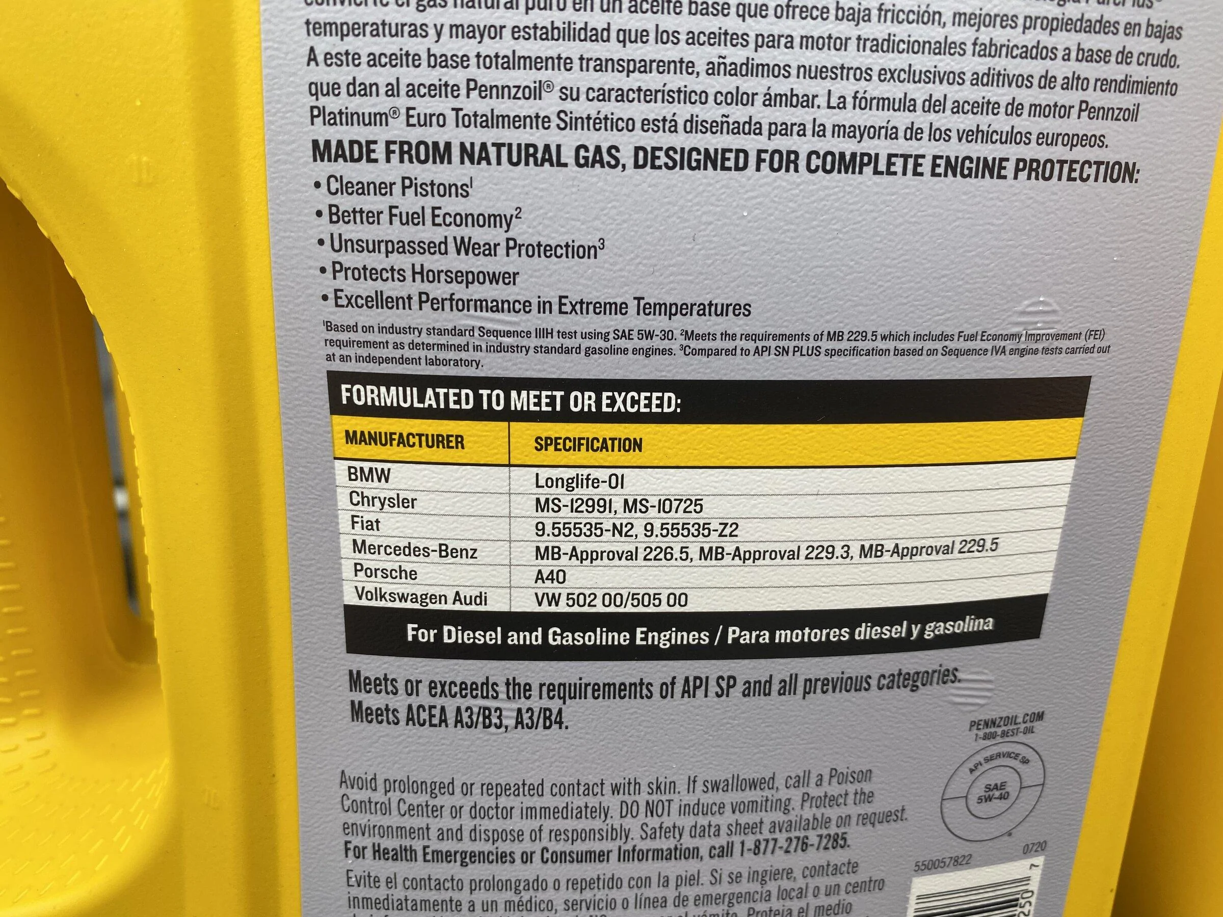

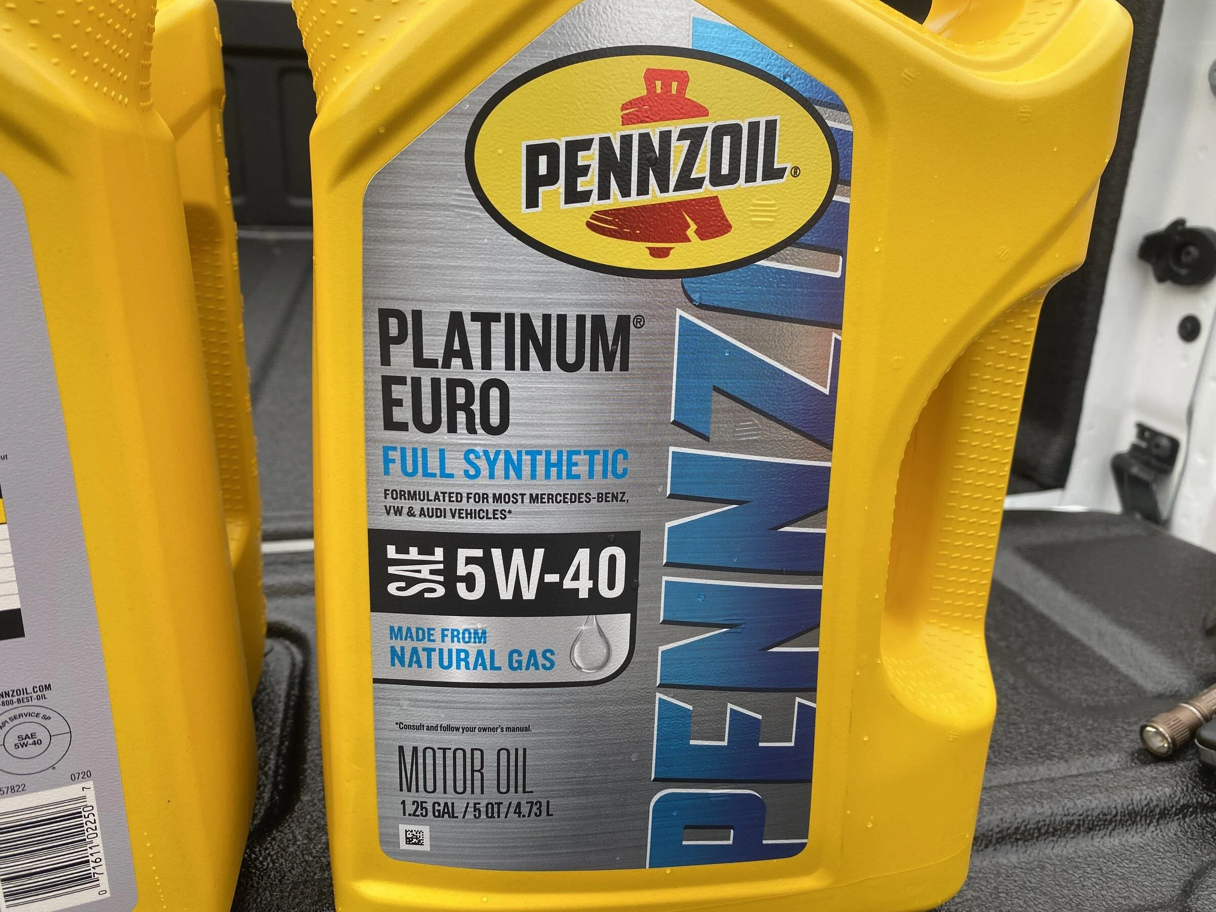

Score!!!! The only thing I don’t like is that it doesn’t say for Diesel engine. Granted…it doesn’t say for gas either. It just has the MS-12991 certification on it. Am I okay?
