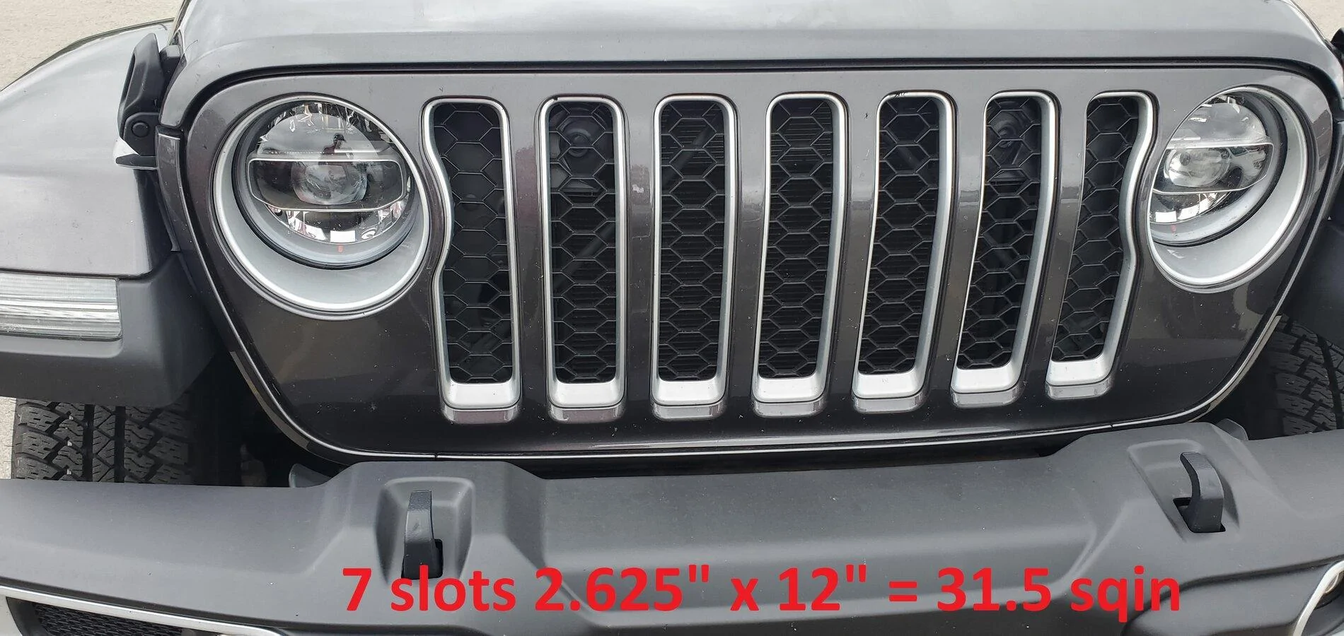

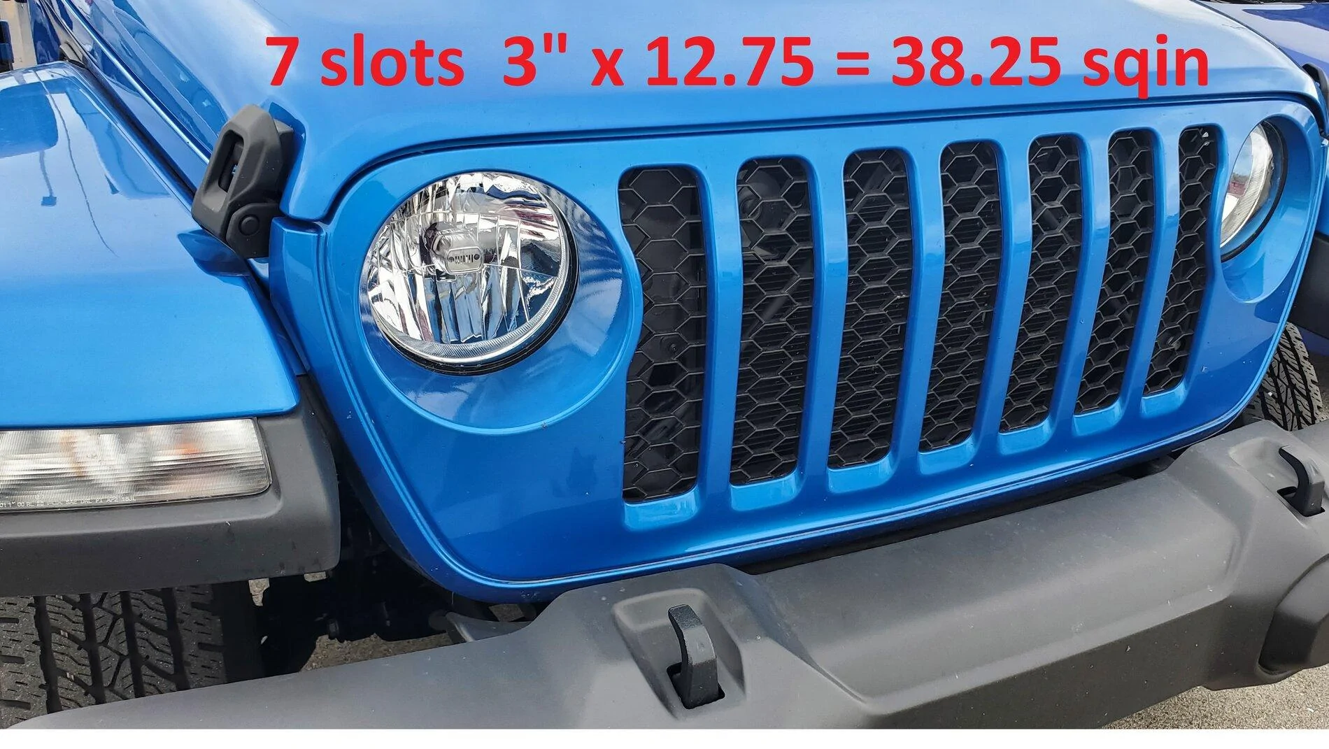

Grill is the only thing I can know of differently on the diesels.
Jeep Gladiator Warranty denied due to trailer frontal area? Overland grill
Jeep Gladiator Warranty denied due to trailer frontal area? Sport grill
Labswine
Steven
Jun 18, 2020
1,148
1,761
West Chester, Pennsylvania
Retired Chemist
Yeah the diesel requires extra cooling capacity because of the turbo but, these trailer frontal area figures posted in the graphic by the OP were for both the 3.6L gas and the diesel, both with automatic and the trailer package. Plus, only 7 sq.in. of grill area ain't that much...shouldn't be enough to account for a 15 sq.ft. difference in trailer frontal area ? ? ?
