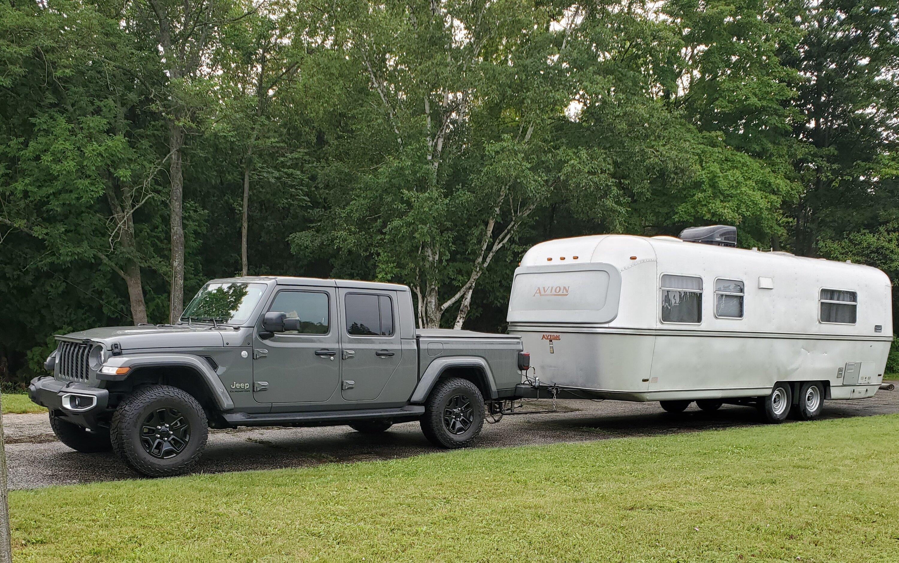

So, if optioned as such...heated seats/steering wheel, power windows, factory bed liner and tonneau cover, the 8.4" with Nav, and a few other goodies which weigh, what? 60 lbs tops? Would result in a 15 sq.ft. less frontal area towing ability? There's something a bit awry here ?
I can see if you have a totally flat front trailer with the aerodynamics of a brick but, most travel trailers these days have a curved front which does allow the air to flow better over the front of the trailer. I know that the calculation is simply width x height which in my case puts my trailer at ~50 sq.ft. frontal area BUT, it's also curved. If I wanted to actually do the calculus, that'd probably add a few more square feet to the equation but, like I said, it's curved ergo, more aerodynamic.
Besides, my Overland has no issues towing my trailer...27' and around 5,100 lbs with all our stuff we want or need. Yeah, it does remind me it's only a V-6 on occasion so I sometimes have to drop from 7th to 6th to maintain or regain speed (n.g.t. 65 MPH) on an upgrade but still...she handles the whole schmegeggie with aplomb :rock::rock::rock:

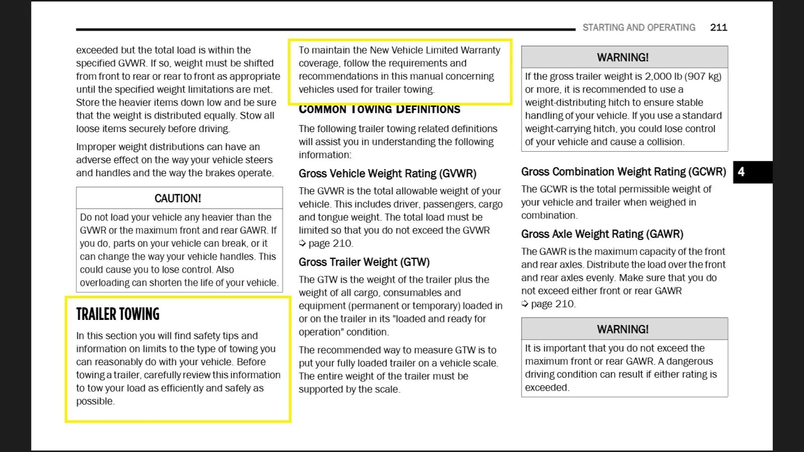

Keep in mind that Frontal Area isn't the same kind of spec as tow rating or the like. It's a recommended guideline to stay within if you want to avoid reduced vehicle performance.
I really wish I could prove that this was a "recommended guideline". The manual is very vague on this and I could not find any details stating it was anything but a "limit".
That's just the thing: you don't have to prove anything. Jeep does.
I think by trying to prove something like this on your own, with sketchy information, and a game of telephone to your "friend", you're getting yourself, or your "friend", stuck too far in the details that you can't see the forest for the trees.
Again, FA isn't the same type of thing as GVWR or GCWR. Don't try to apply the same logic, and don't let yourself get consumed by something that isn't your case to make. Remember, the problem here isn't about dissecting Jeep's manual, the problem here is getting your Jeep fixed. Forget the nuances of the manual and splitting hairs on it; just get it fixed!
