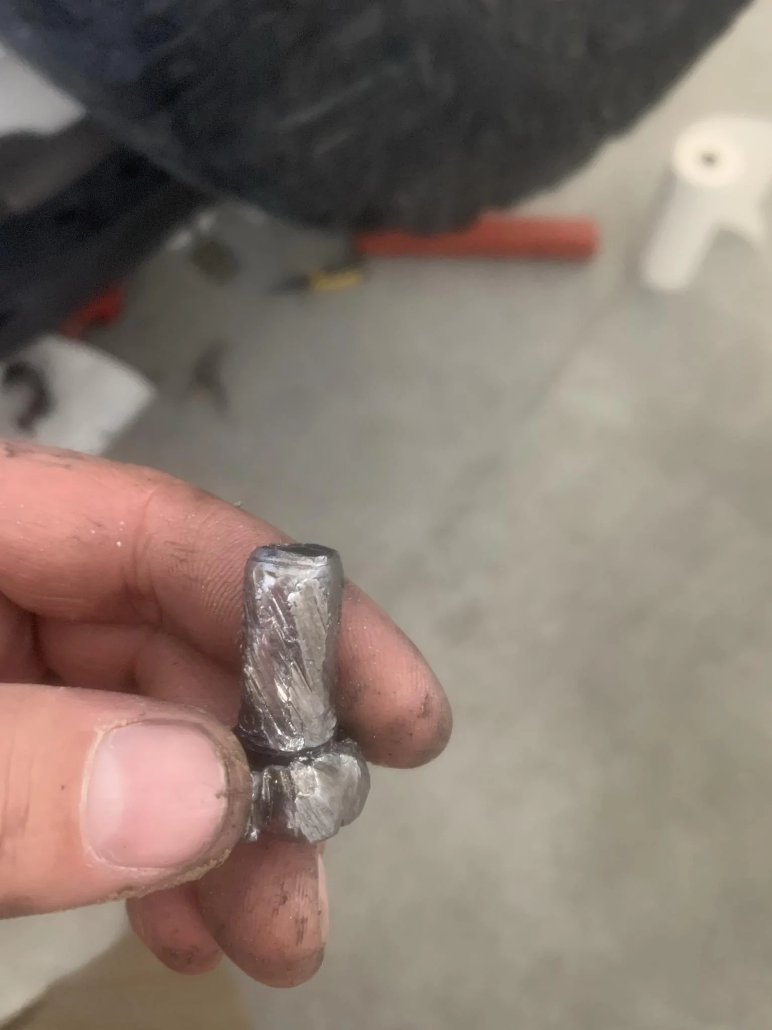

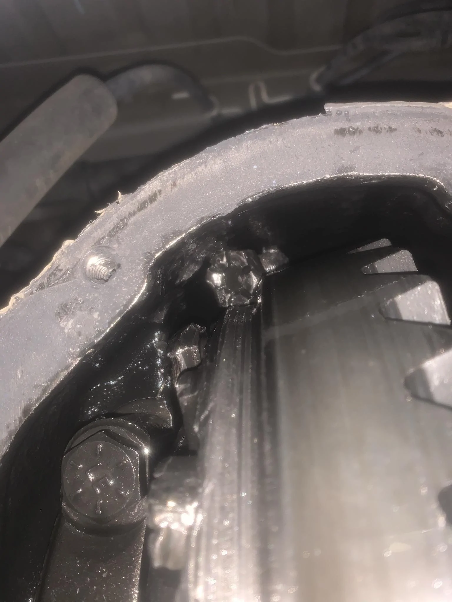

Did you remember to lock tight the ring gear bolts?
Edit-- yes I did.

I want to say yes, but I didn't. Fuck. Ugh g-D son of a B.

You don’t necessarily have to pull the carrier to pull the ring gear bolts out one by one and apply.
The photos I put up were from my JK…. 🤯🍺
More beer and BSing was commencing upon reassembly than should have been…. Couple thousand miles in felt/found this.
It’s worth the extra time and effort to apply it…. I know a guy 🤣😂🤣
After your post I texted my F-I-L who was helping me. He did loctite the ring gear bolts while I was looking for the torque wrench. Whew. We both got annoyed at the XX/lbs feet plus 45 degree thing on the ring gear bolts.
Great news. Beats ordering a new set and going one by one in the Jeep! 🤣😂🍺
