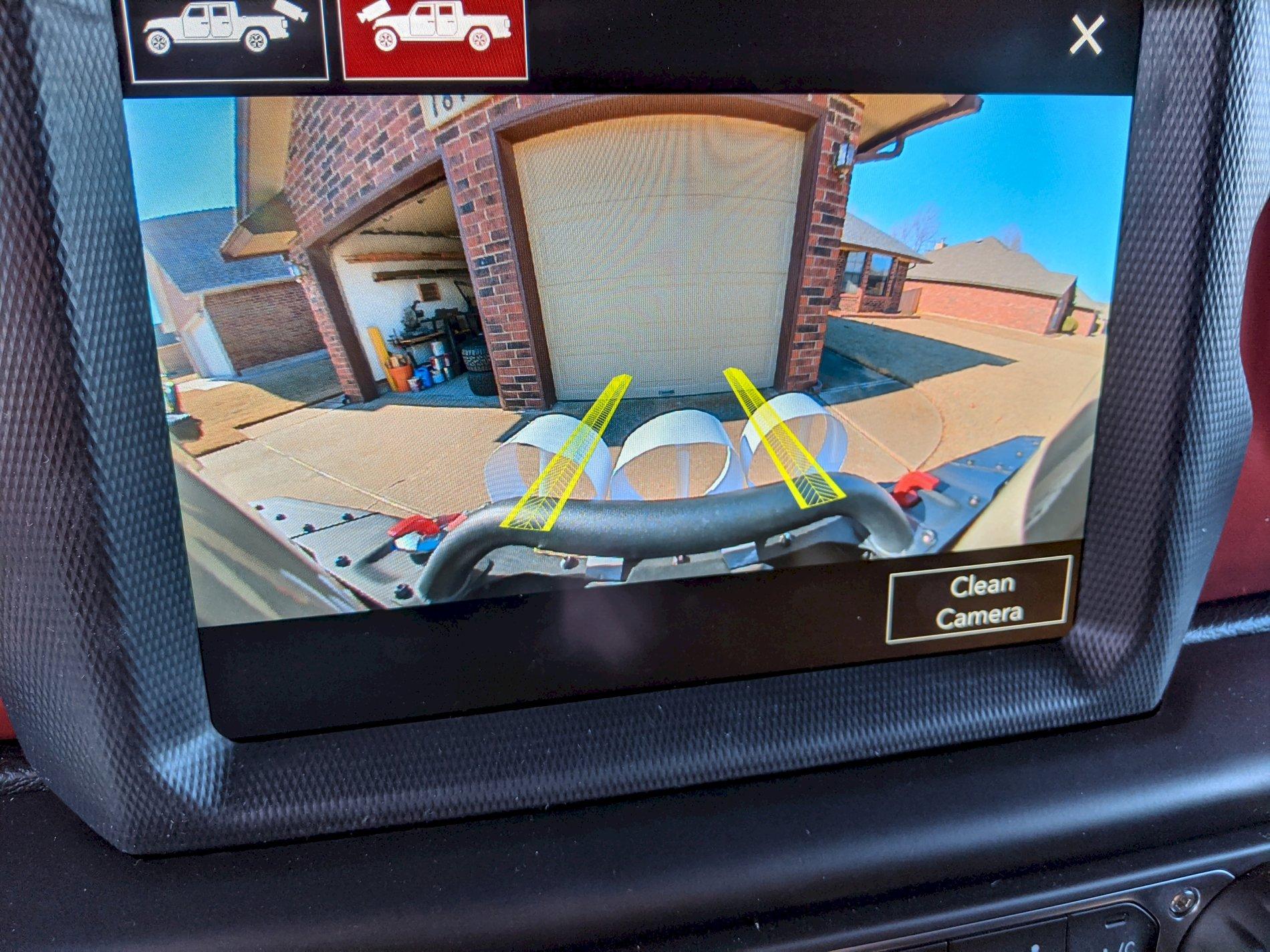

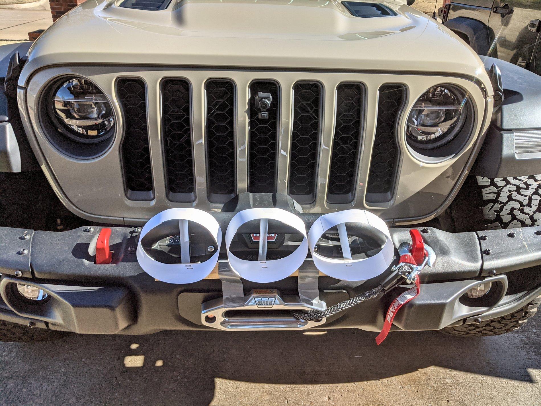

Here, I hope, is some related info that may prove useful to you. I was concerned about the trail camera blockage installing lights on the steel OEM bumper. So, I mocked up a couple options for lighting. There is already a winch (Warn 10S) installed, along with the OEM winch hoop. It was necessary for me to remove that winch hoop once I did the actual lights install--no big deal. But, these should give you an idea of what to expect after mounting a winch and other accessories ...
Three simulated KC 6" LED Slimlites ...
Jeep Gladiator Wench Gladiator, Jan 20, CP_122442, Three Mock SlimLites (Front View)
Jeep Gladiator Wench Gladiator, Jan 20, CP_122630, Three Mock SlimLites (Trail Cam View)

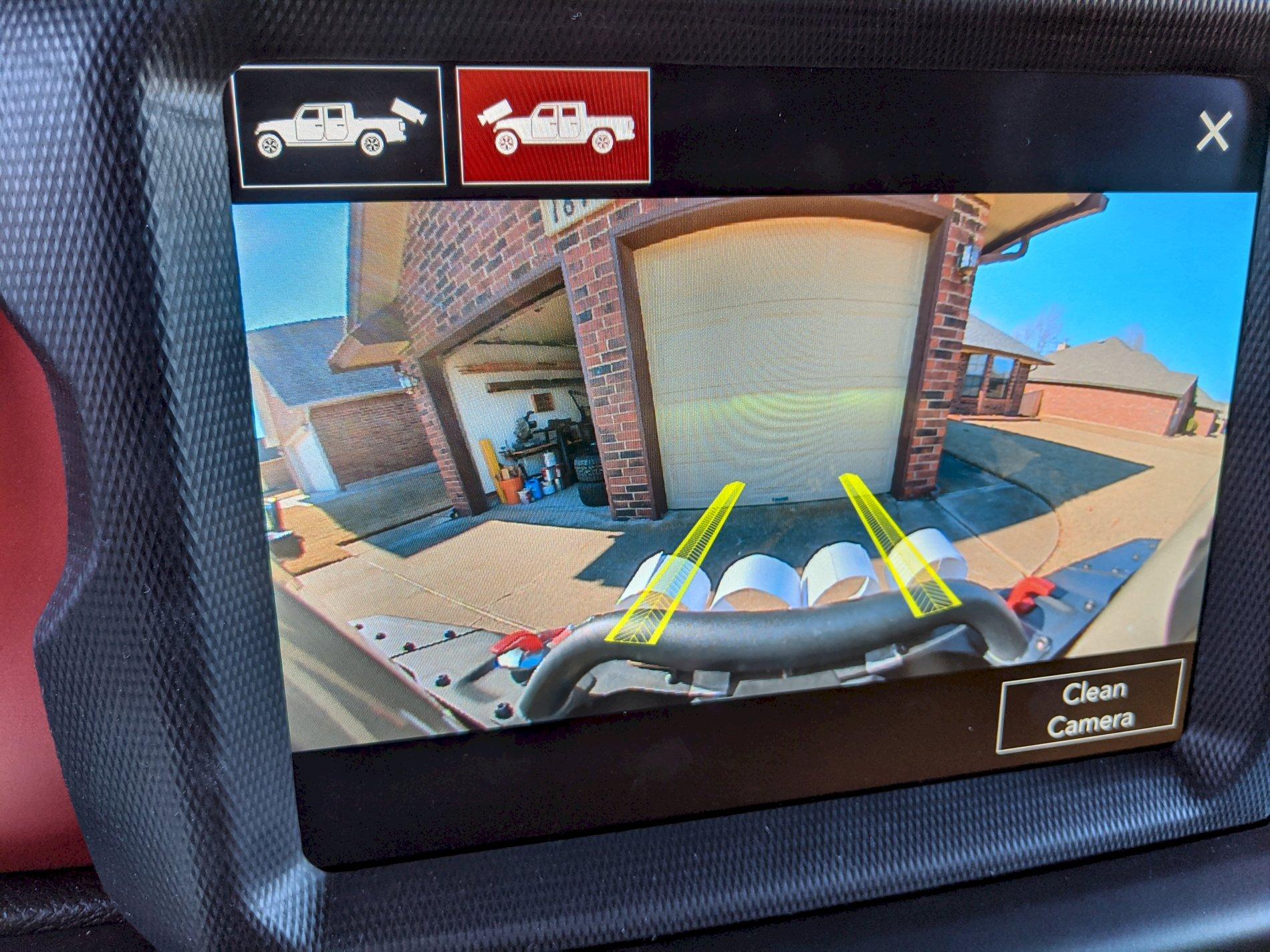

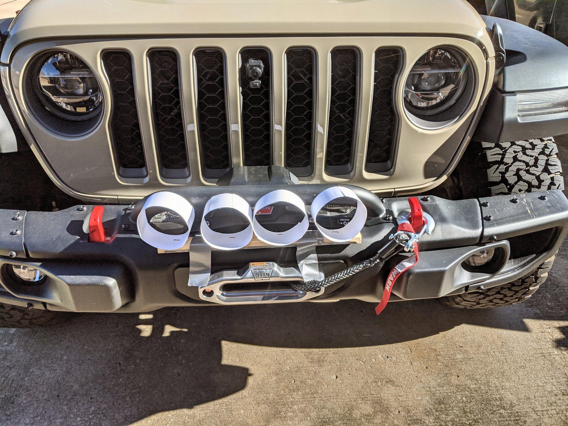

Four simulated KC 4" LZR lights ...
Jeep Gladiator Wench Gladiator, Jan 20, CP_124322, Three Mock LZR Lites (Front View)
Jeep Gladiator Wench Gladiator, Jan 20, CP_124354, Three Mock LZR Lites (Trail Cam View)

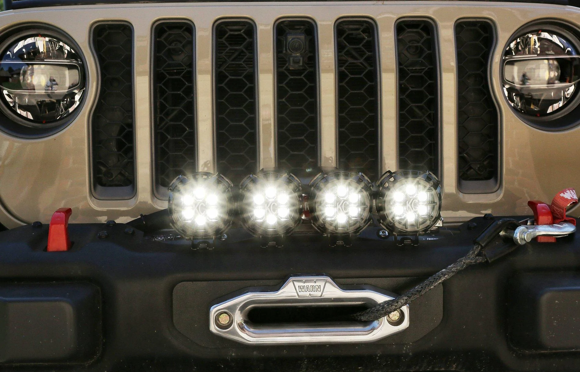

Based on those mock-ups, I ended up going with the LZR lights.
Jeep Gladiator Wench Gladiator, Jun 20, 5_5347, They Work Through Aux Switch!

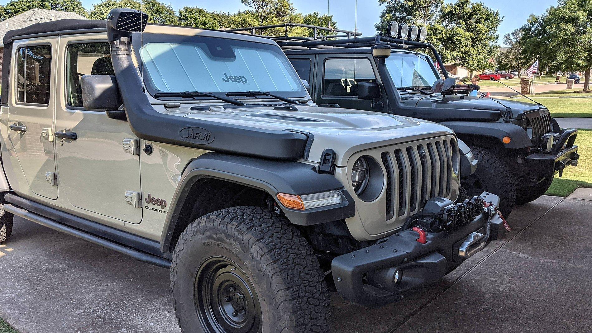

FYI, some bumpers mount the winch up high. I don't care for that style of mount because the greatest strength for hard pulls is lower, between the frame rails. Hard pulls also require a proper winch plate and skid plate to reinforce the winch mounting. So, if someone is looking at something that puts a winch that is more than trips-to-Starbucks decoration up high, I encourage them to keep looking. Also, some winches are pretty tall. The Warn 10S is one of the lower height ones. The PowerPlant on my Wrangler is significantly taller ...
Jeep Gladiator Wench Gladiator, Jun 20, CP_171435, 12 Hours After Start
