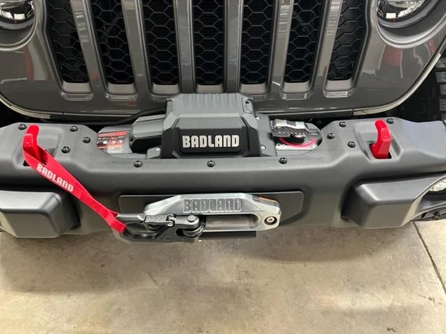

Your winch should be reflective of what you plan to use it for. Are you going to do a lot of wheeling/recovery, or pulling out tree stumps? Remember, the 12K rating is the pulling power of the winch, not the physical size. I added the Badland to my JTR because 1) it was the best deal for the money, 2) it has more than enough pulling power for my use, and 3) it only added a few pounds more weight than winches rated at lesser lbs. Note also, that a synthetic cable will weigh less than a steel cable (which is where most of the weight comes from). Since you have a JTO, you'll have to change bumpers to add a winch, so there are additional weight considerations with that as well. Here's a pic of a Badland 12K on my 2020 JTR so you can get a visual of size. The entire set-up (winch plate etc) added approx 87lbs to the front of the JTR and dropped the front end about 1/2 inch, (I have a teraflex spacer in front which minimized drop). Gas mileage took a hit due to added weight, but who cares at this point, it's a Jeep. Lots of decisions with a winch that only you can make, but why not get the most pulling power for your $$, than to get stuck and wish you had a bigger winch? Good luck.
