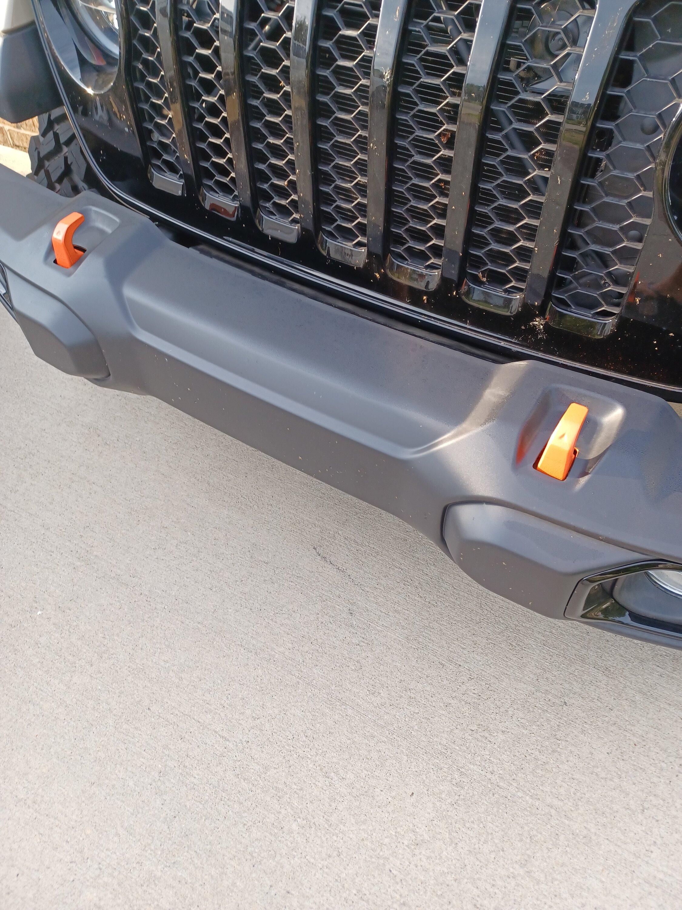

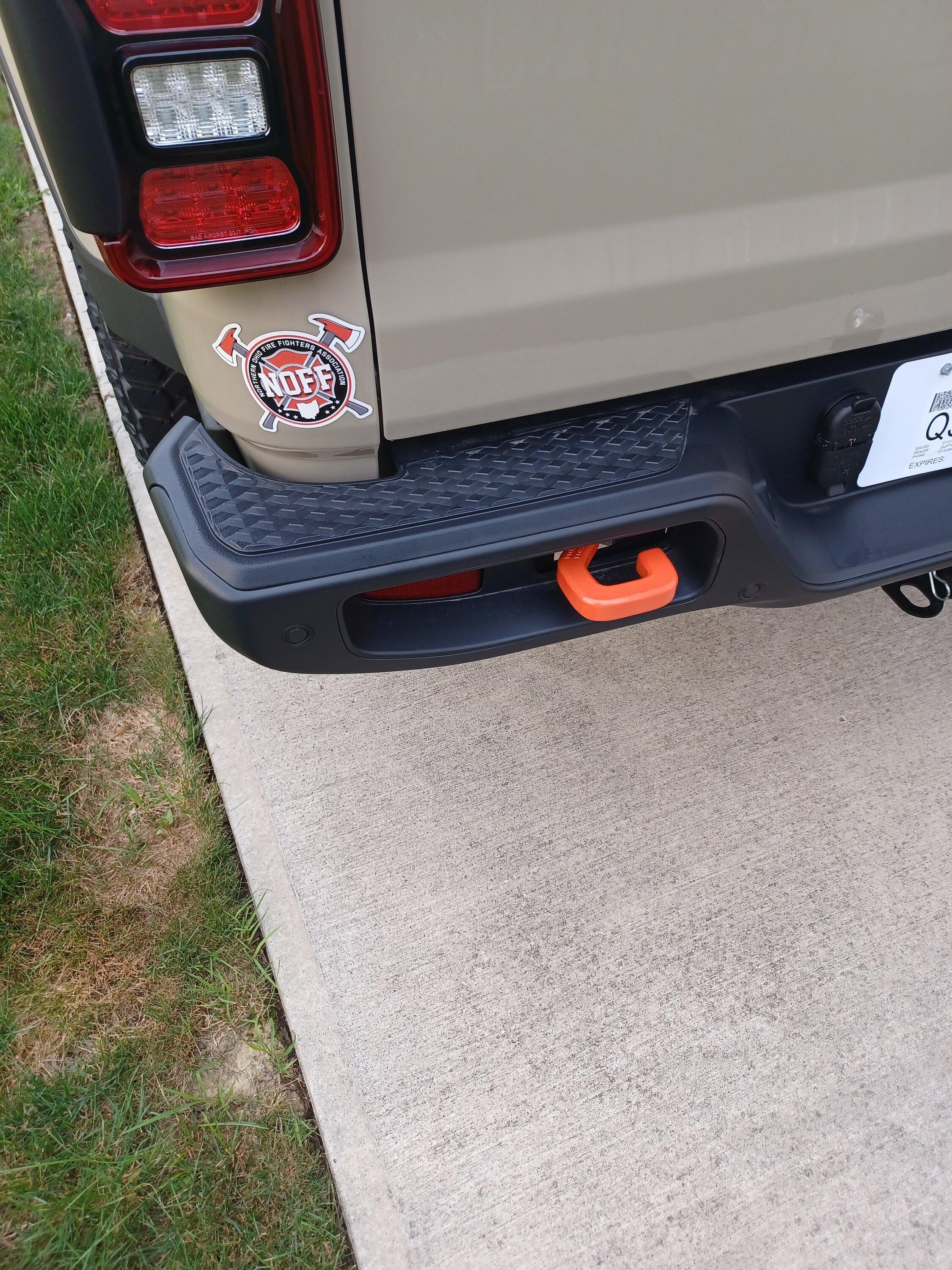

Very minor, just looking for a pop of color. I painted my Tacoma Recovery Hooks orange. Not super happy with the shade of orange here, may try this with a different product.

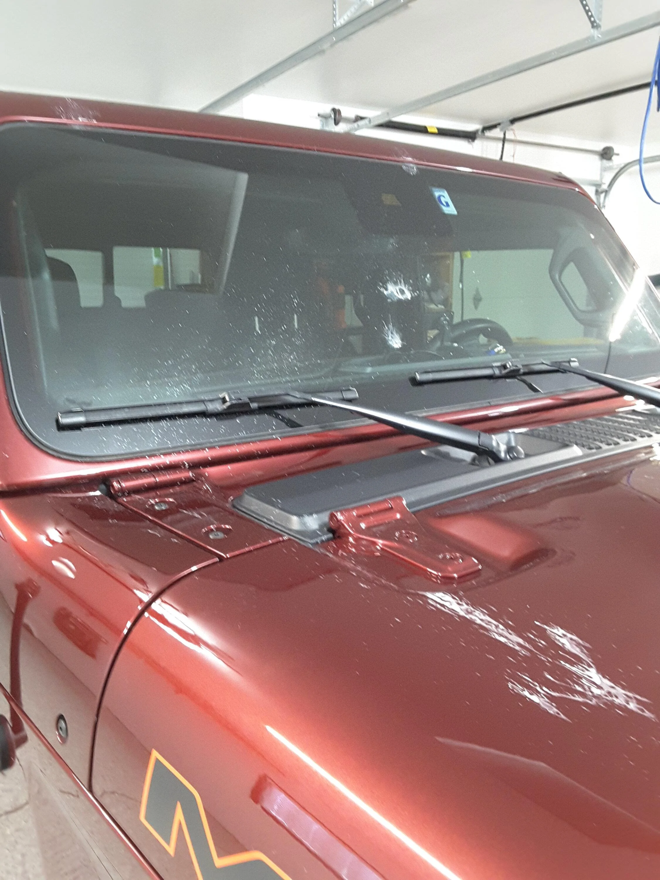

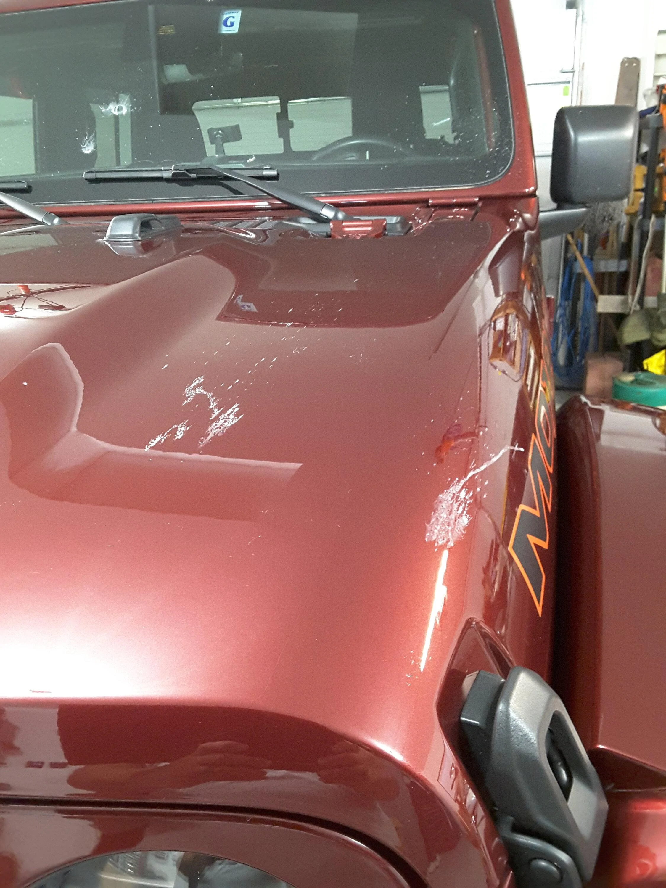

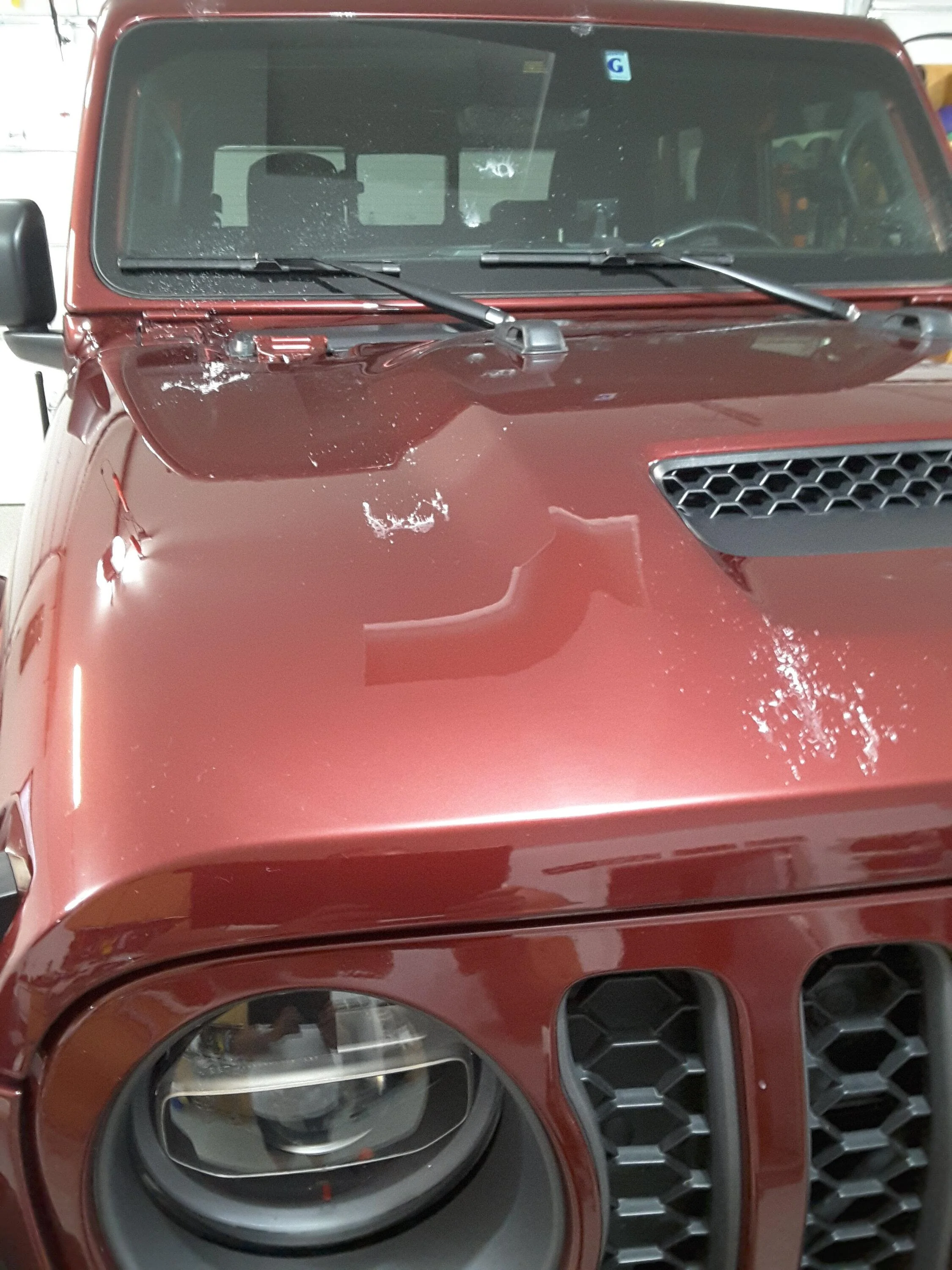

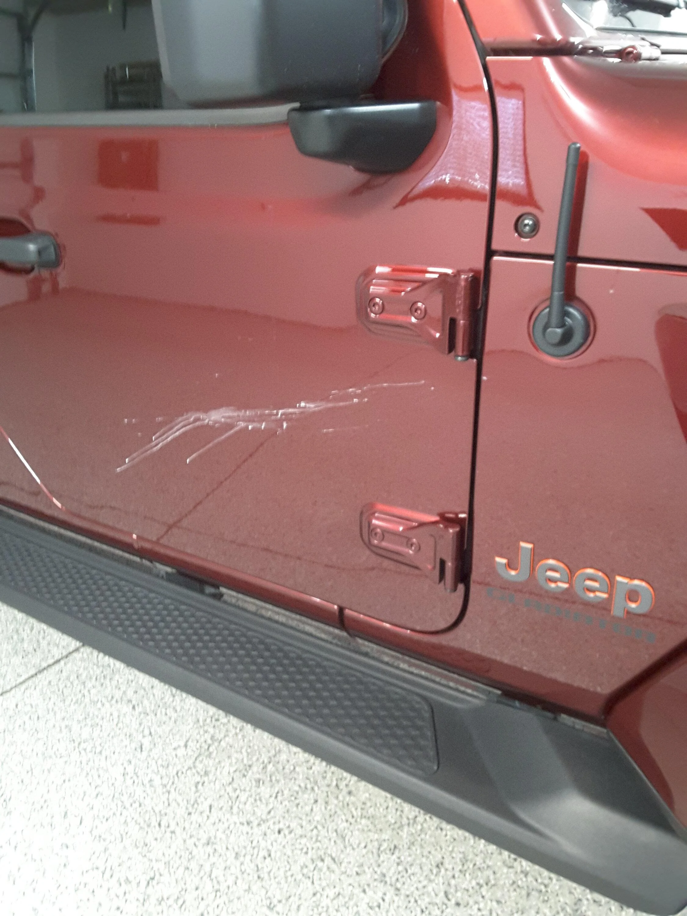

Washed it TWICE!! ( Damn geese)
Within an hour of the first wash a squadron of geese took direct aim at Mo!
The side door! How does one shit on a side door at 55mph?
Time to take up goose hunting again!!!!!!
They straight up B-52'd your ass. Tasty little critters though... tad on the greasy side.

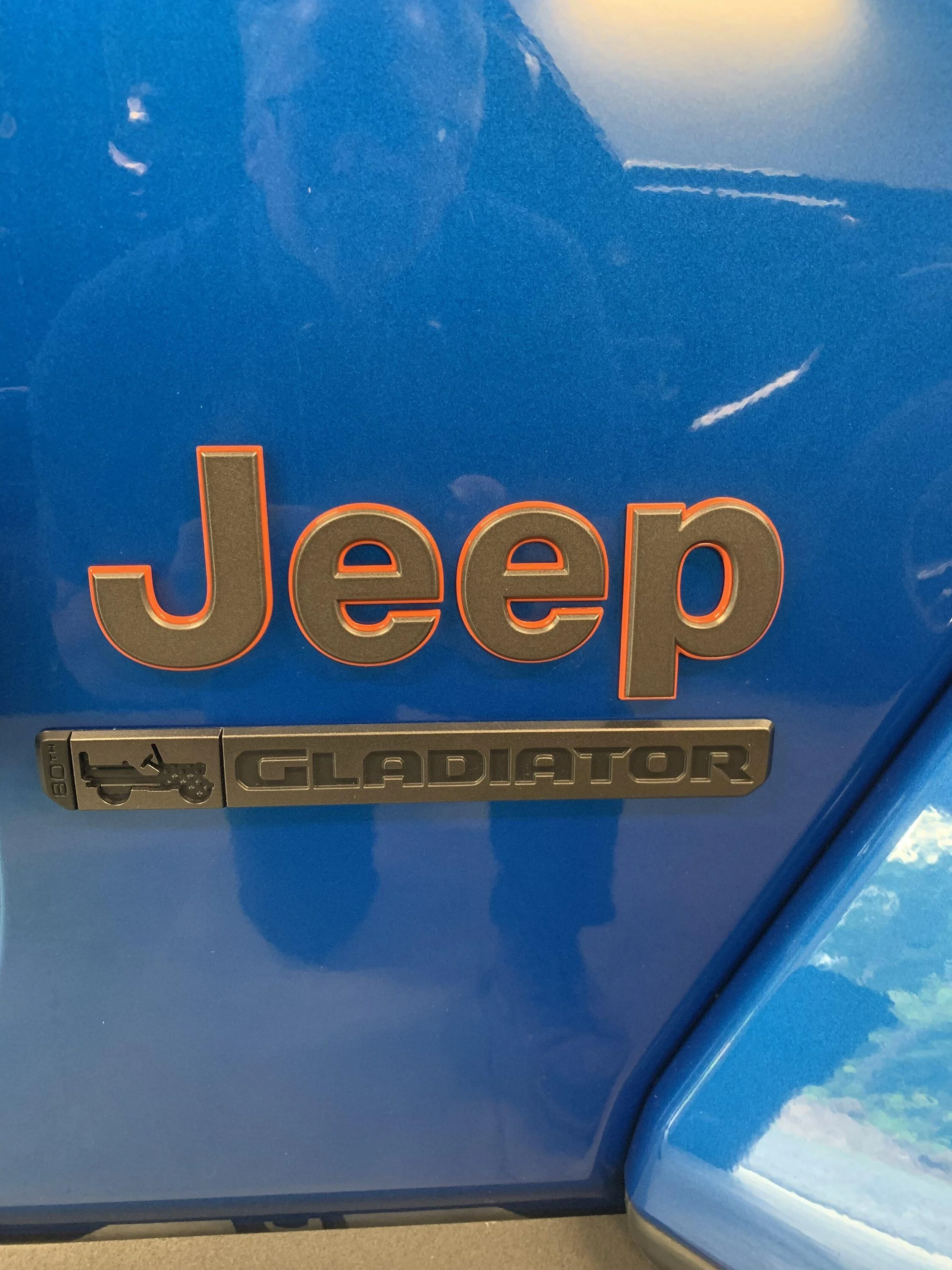

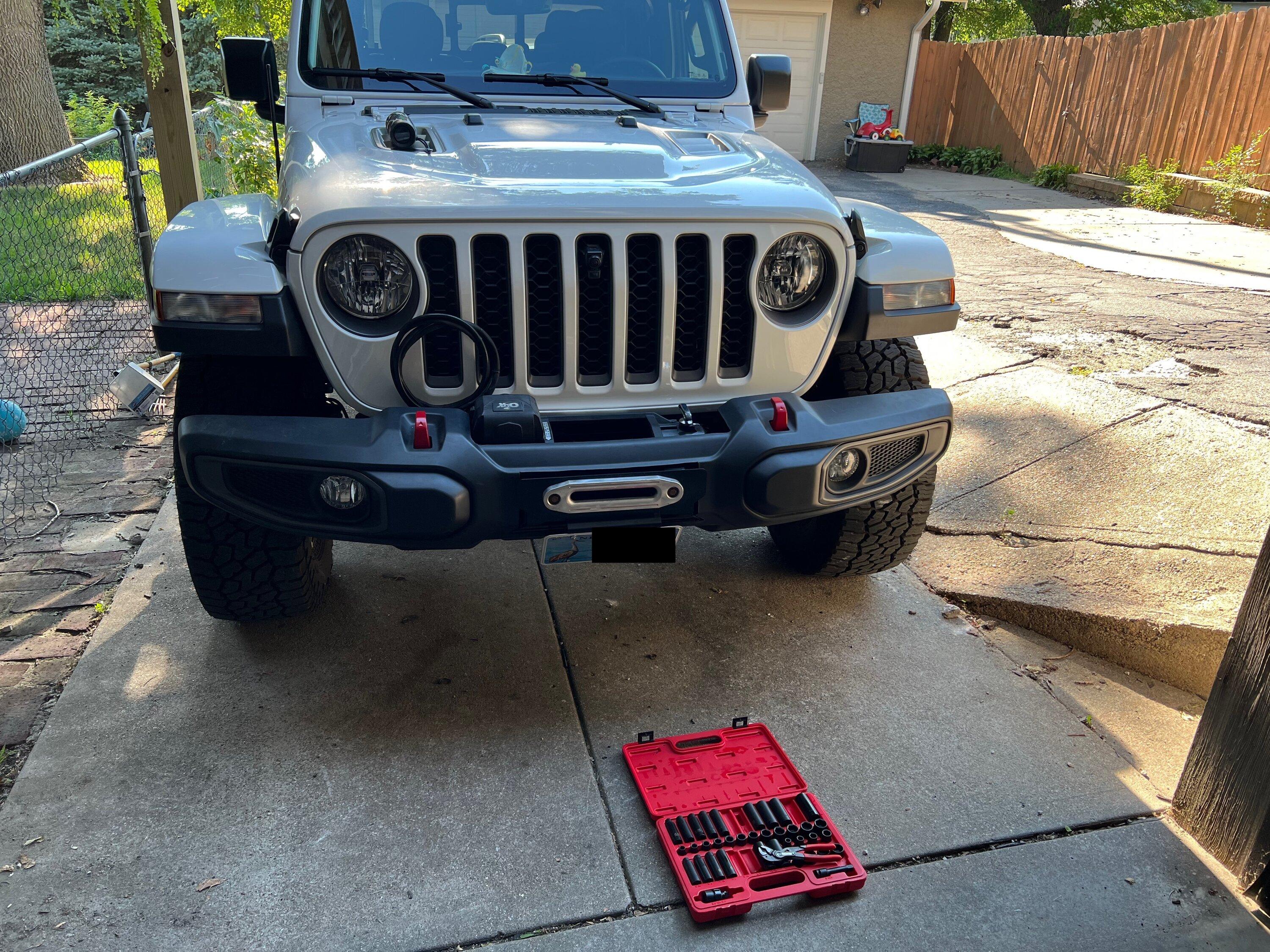

WelI finally did it, put something on the Jeep that does nothing to support it’s mission or do anything ………but, but…
Jeep Gladiator What did you do TO your Gladiator today? [ADMIN WARNING: NO POLITICS, NO GUN TALK] 14445B07-6ED2-42F2-9F96-CDB9A207D050
….but look bitchin! It even has sparkles in the plastic like the Mojave dash does! 80th anniversary badges, but mine is a 2021, so also in 80th year!….Jack

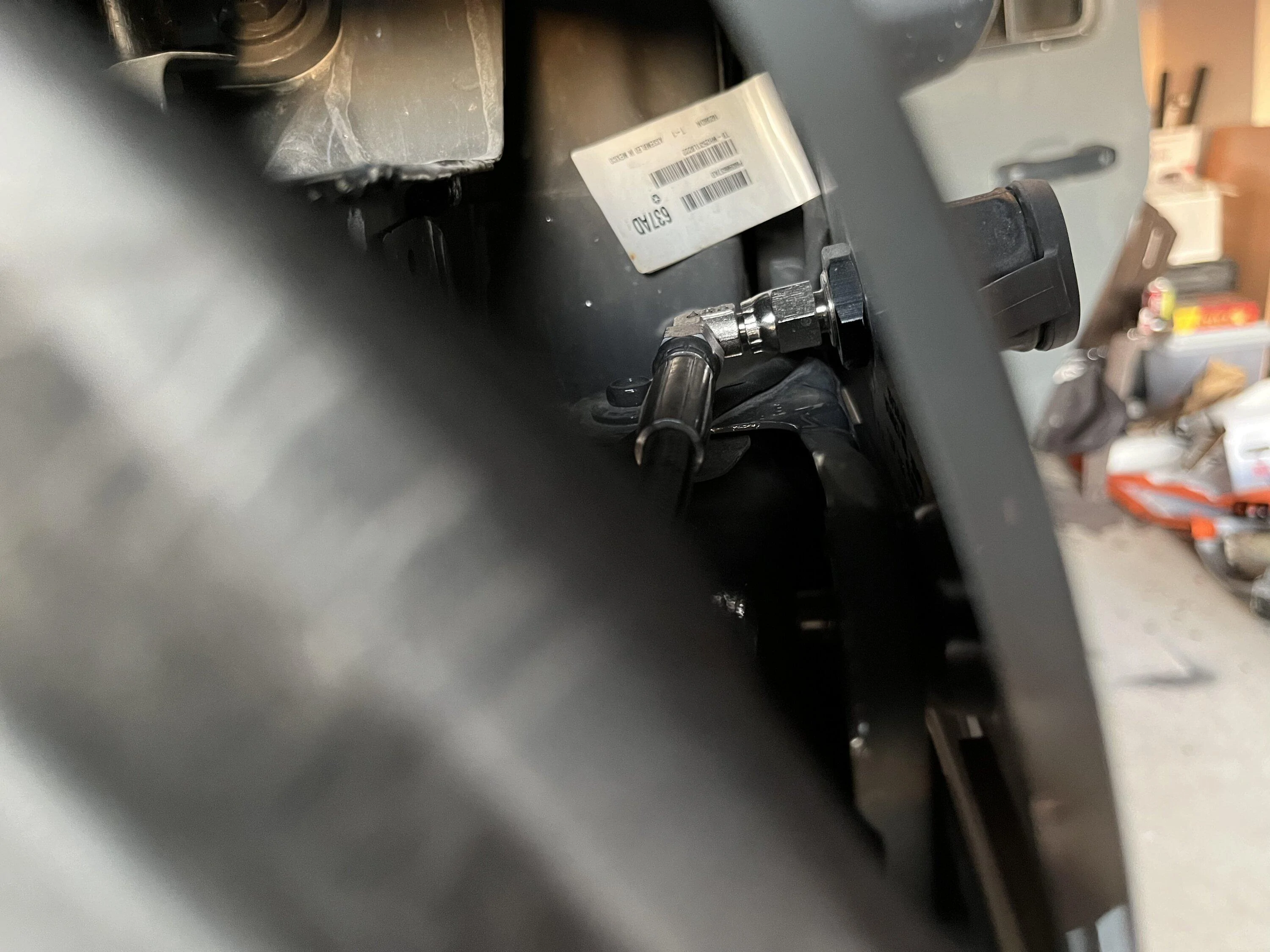

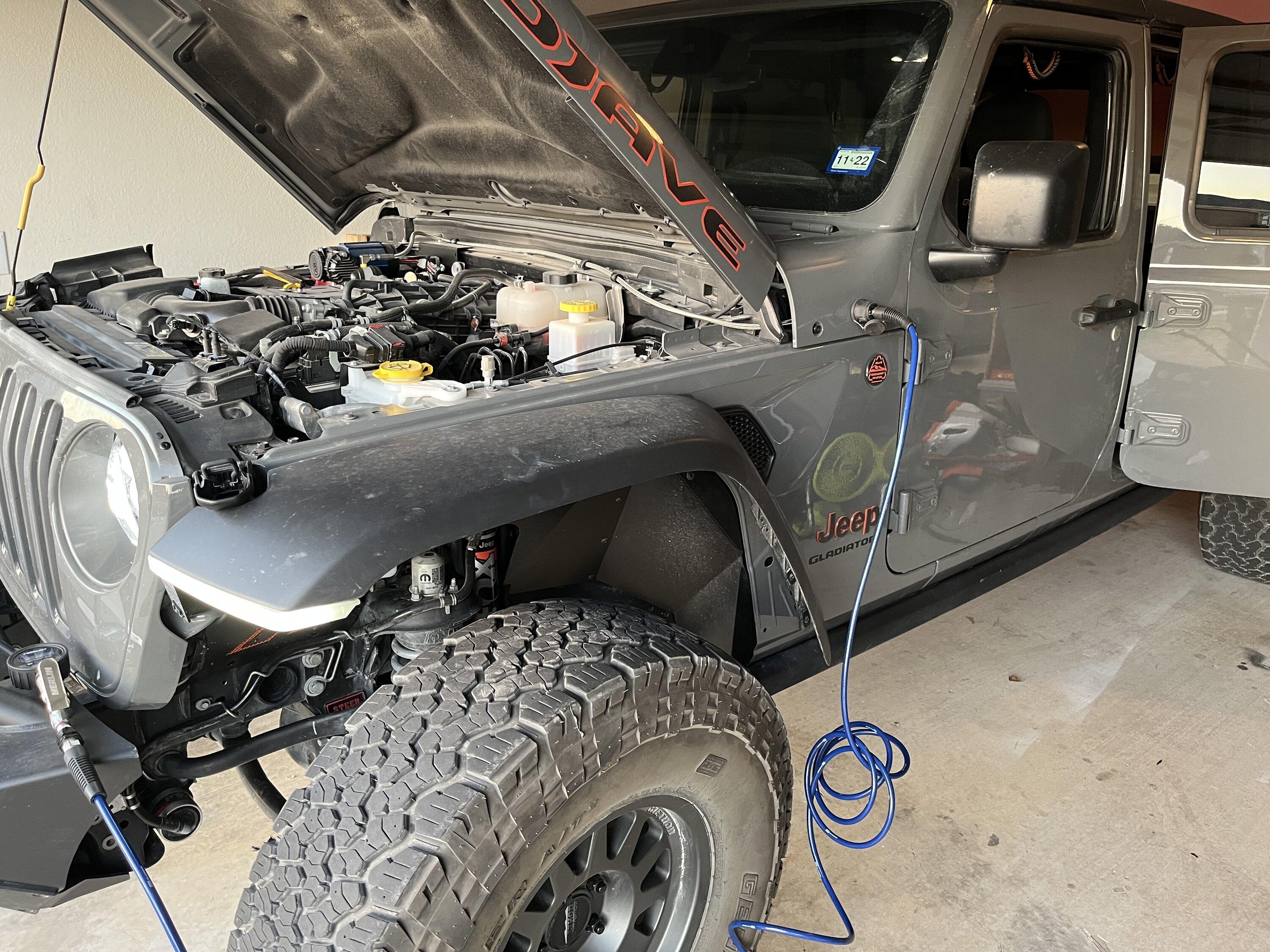

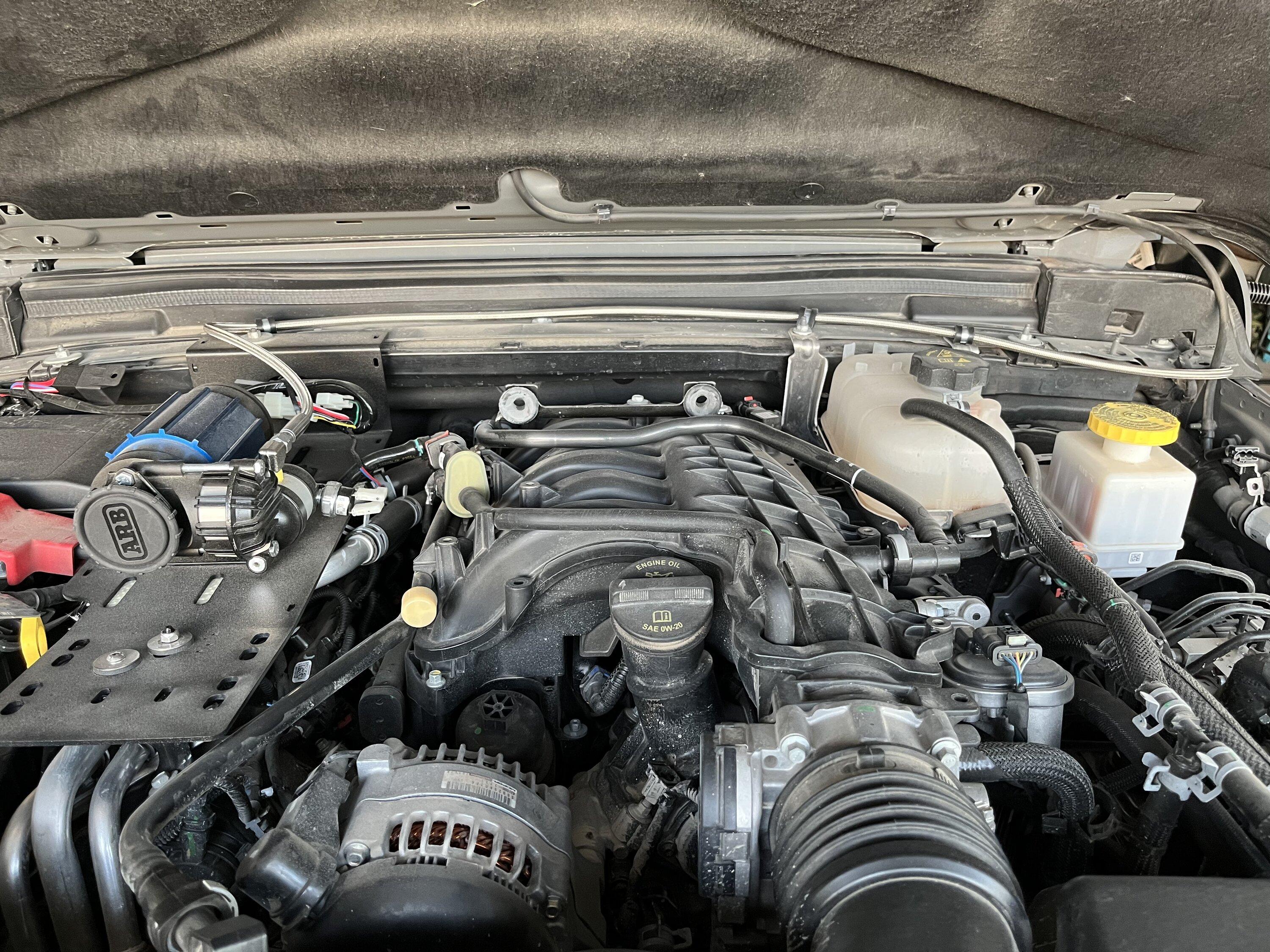

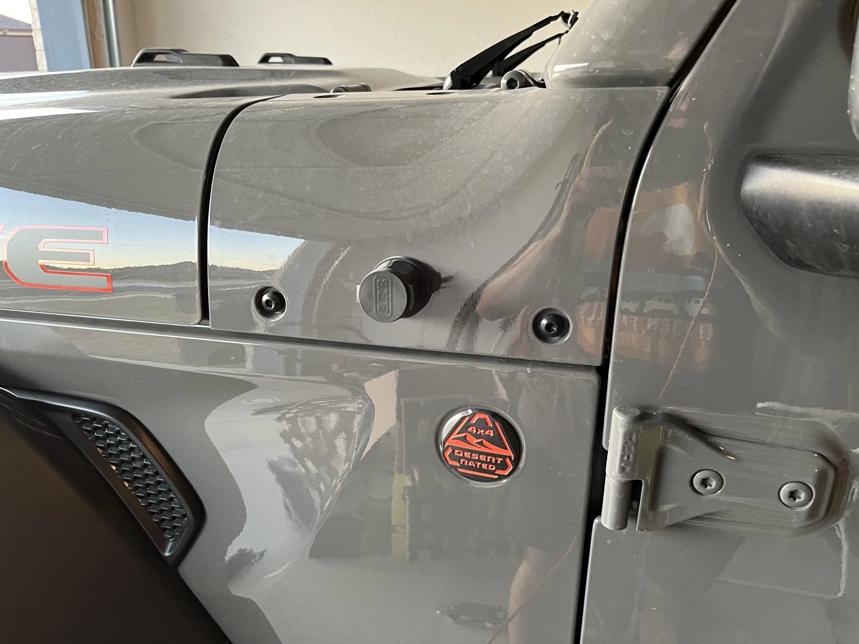

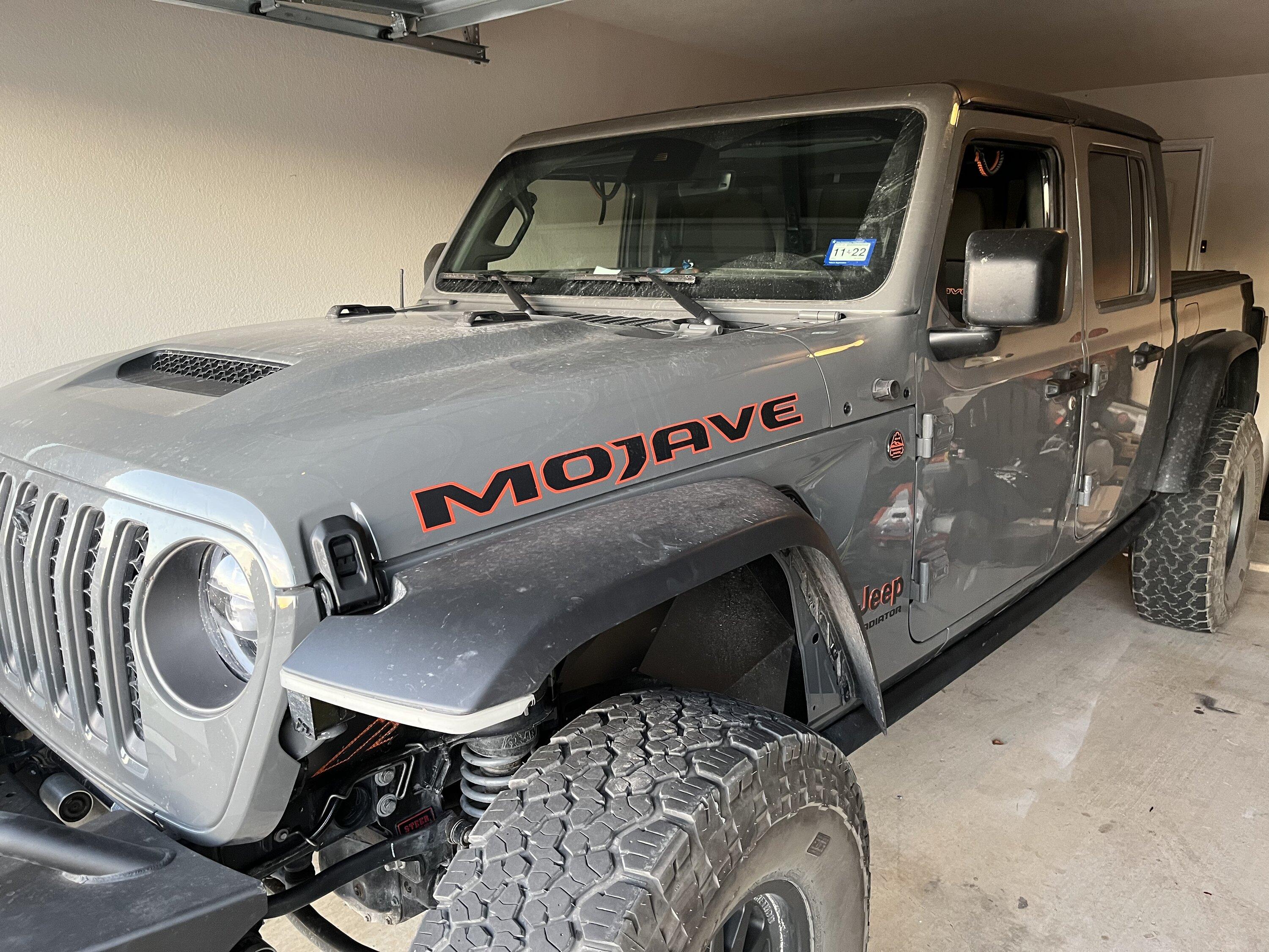

Put the finishing touches on my ARB on-board install.
I originally bought an ABR single portable kit that comes in a box with alligator battery clips, thinking I wouldn’t use air a lot, but then I started wheeling my Jeep a ton. Bought a bunch of supplies, an @813 Fabrication & Design under hood mount, and took apart and reassembled my portable kit into an on board setup.
I wanted an external or easily accessible air chuck that wasn’t under the hood and was far away from the compressor heat, but I didn’t want to do something low around the bumper area that would get grimy and dirty. I’ve see a couple awesome uses of the 4XE cowl door, but 1) it doesn’t fit the Mojave hood, and 2) seems like a ton of money for what it is. So, drill baby drill into the factory cowl!
Also, tested it this weekend while wheeling, and tested my DIY 4-tire inflation System. The ARB simultaneously filled all four 37x12.5 from 18psi to 38psi in 14 minutes. Not bad!

Nice, looks good!

You should post this over on the Tacoma World Forum. Those Taco fanboys would have a conniption fit ?
