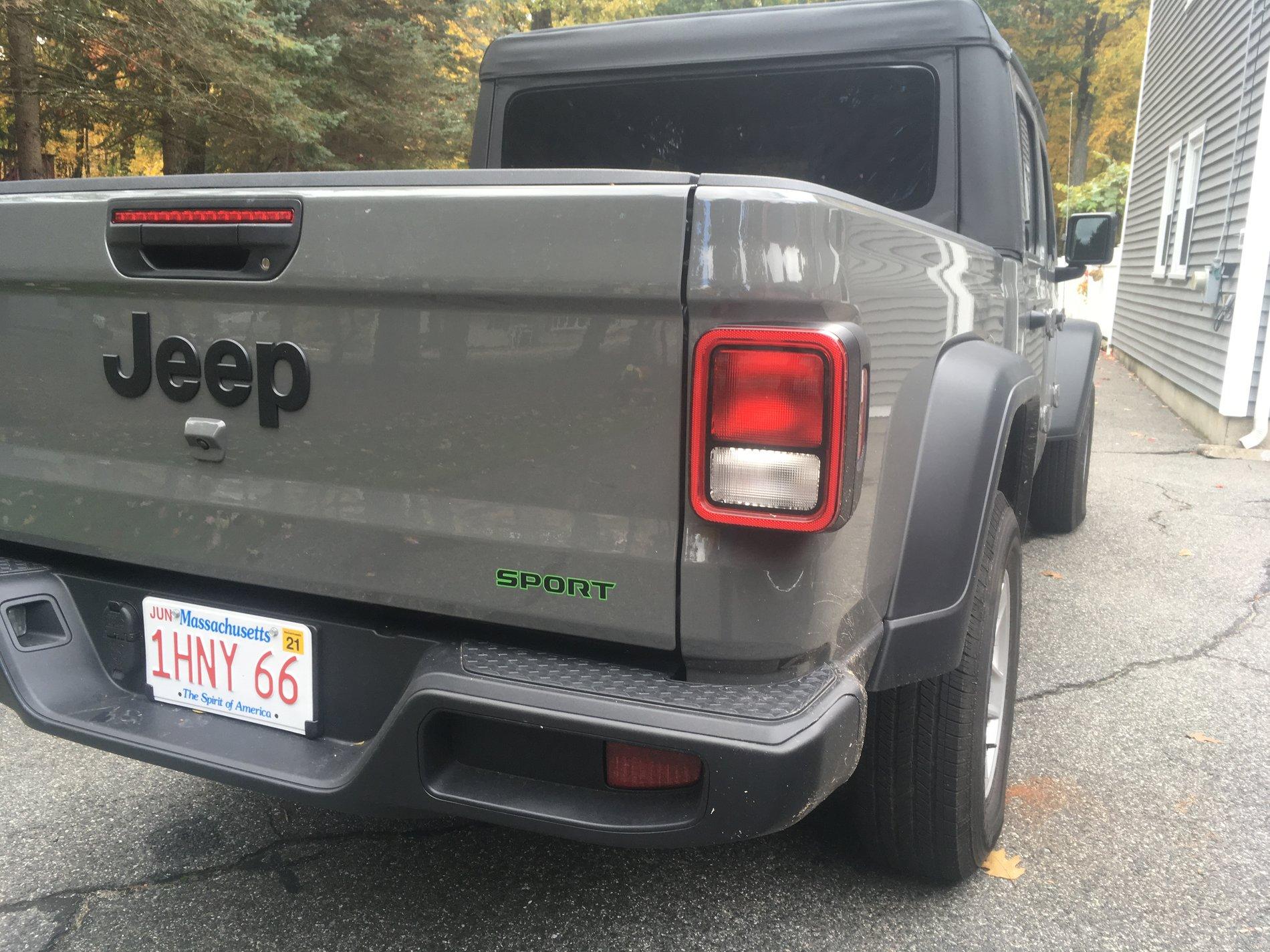

What are those lights for? Are they normally just reflectors? I gotta look at my truck.

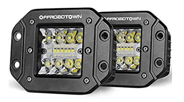

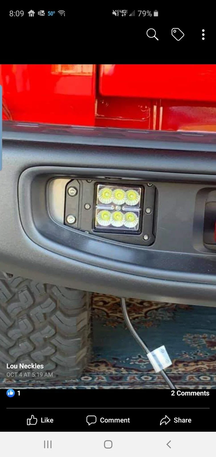

I've been looking to do this exact mod.... taking measurements and looking at light options.... Now I know it'll work out... thanks for posting this!

yeah and those amazon lights are only $30. think i'm trying this sometime soon.

are there any laws about having too bright of back up light?
I'm sure there are. This is America land of the regulations.
I plan on hooking them up to my AUX switch for now. I want them for off road lights and to light up my back up cam when needed.
Hell, for me, less than that.
I have a set I ordered when I had the ZR2 and never installed.
My issue is removing the reflectors that I've thought is the best design feature of the rear bumper.

I just REALLY like those reflectors built in.
Different from all the other truck's 'plain' ones, but one of the first things that made me go, "dayum, that was smart chit right there".

It will definitely fit if you don’t use the face plate. I plan on cutting a pice of aluminum that will bolt right up to the reflector mount holes and mounting the lights right to that using the faceplate as a temples for the holes. I think this will give a much cleaner look and I will be able to center the light up much easier.

I had already looked at those lights and figured they could be trimmed to fit in the existing space... ordering them today and will begin mock up once they arrive..... picked up and 9" LED light bar from harbor freight and mounted it on my roller fairlead.... decent lighting for the price... and the AUX wiring is easy peasy! Have some ideas for a Chase bar,/rack behind the cab..... gonna do some cardboard mock ups once i clear some other projects....
