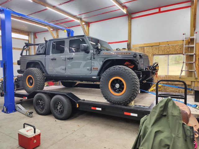

Loaded it on the trailer ready to head down to Windrock in the morning.
Checked all the fluids before and found PSC power steering was almost 1 quart low, maybe this is why my low rpm turning was a little choppy. Never made a noise and drove great at speed, guess we will find out tomorrow.
