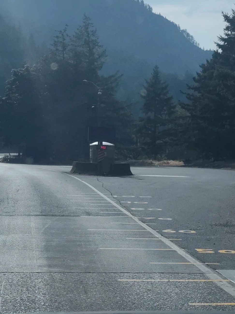

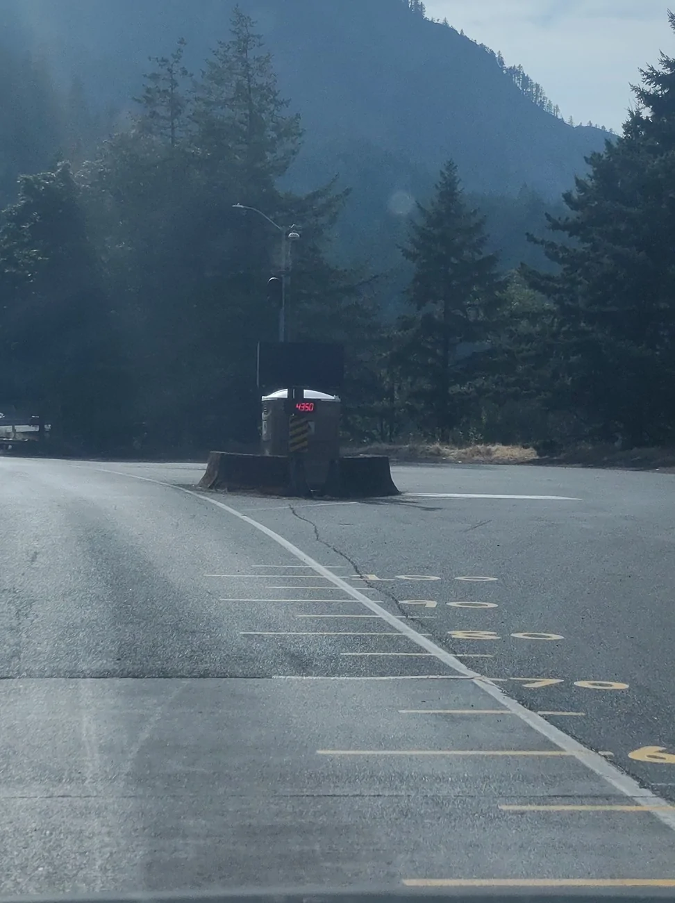

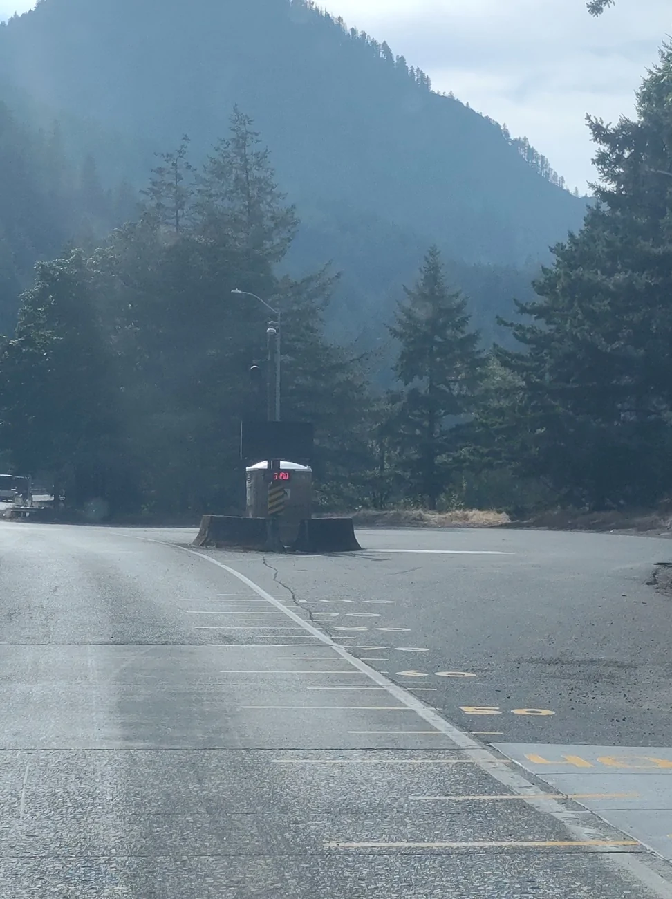

Last summer fully loaded
Jeep Gladiator What does the ole Girl weigh? IMG_20250901_165408809
Jeep Gladiator What does the ole Girl weigh? IMG_20250901_165424766
Jeep Gladiator What does the ole Girl weigh? IMG_20250901_165441887
