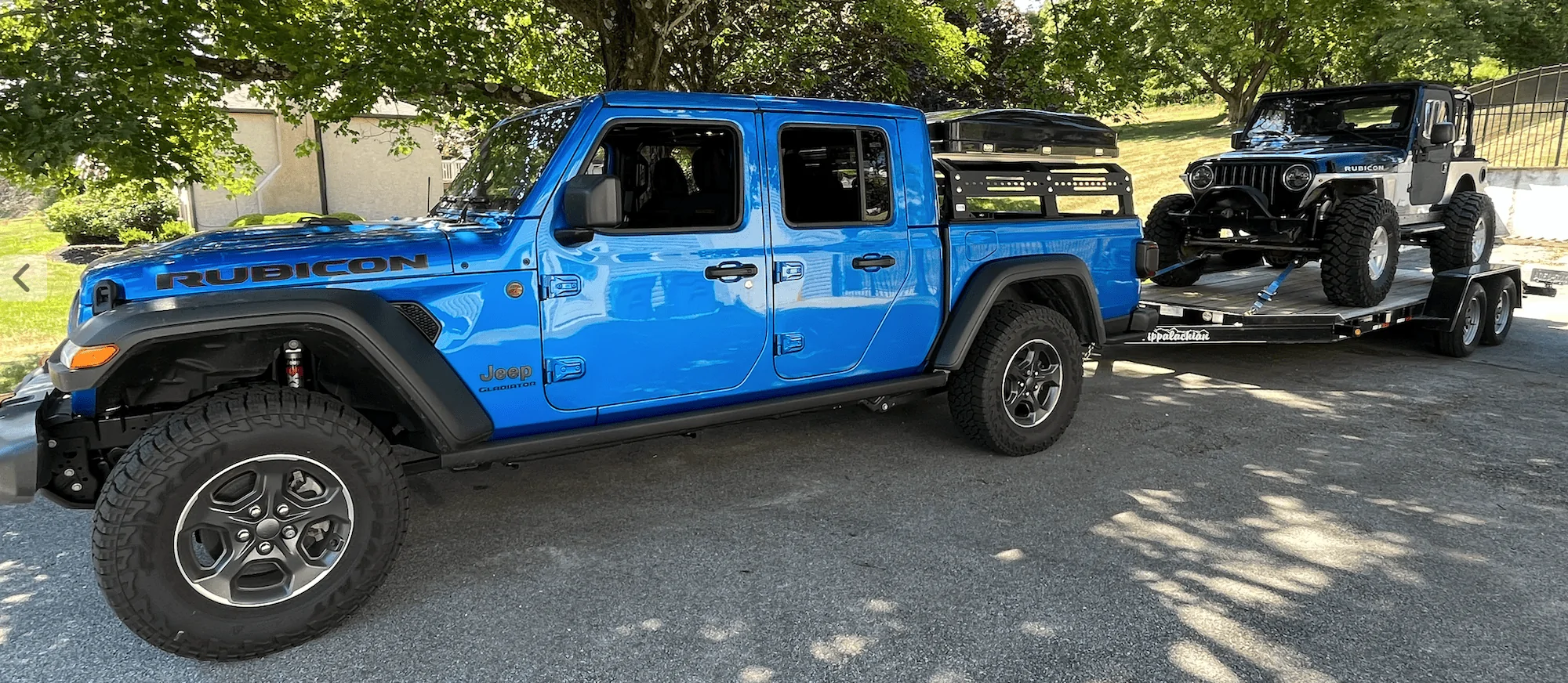

My only concern is the Tongue weight.
I tow with this setup at least once a month and have zero issues.
Jeep Gladiator What Reduction To Payload Does Each Option Cause? 1662916578209-png
RTT is 125lbs.
Fishbone rack is 115lbs
Trailer is 2100lbs
TJ is 4000lbs-ish

With my new 2022 Overland, when I have my trailer in tow with a load on it, that's 500 pounds tongue weight. Add me to the mix and I have just enough left for some odds and ends.
If I towed my car, with me, my wife and maybe a suite case, I'm done.

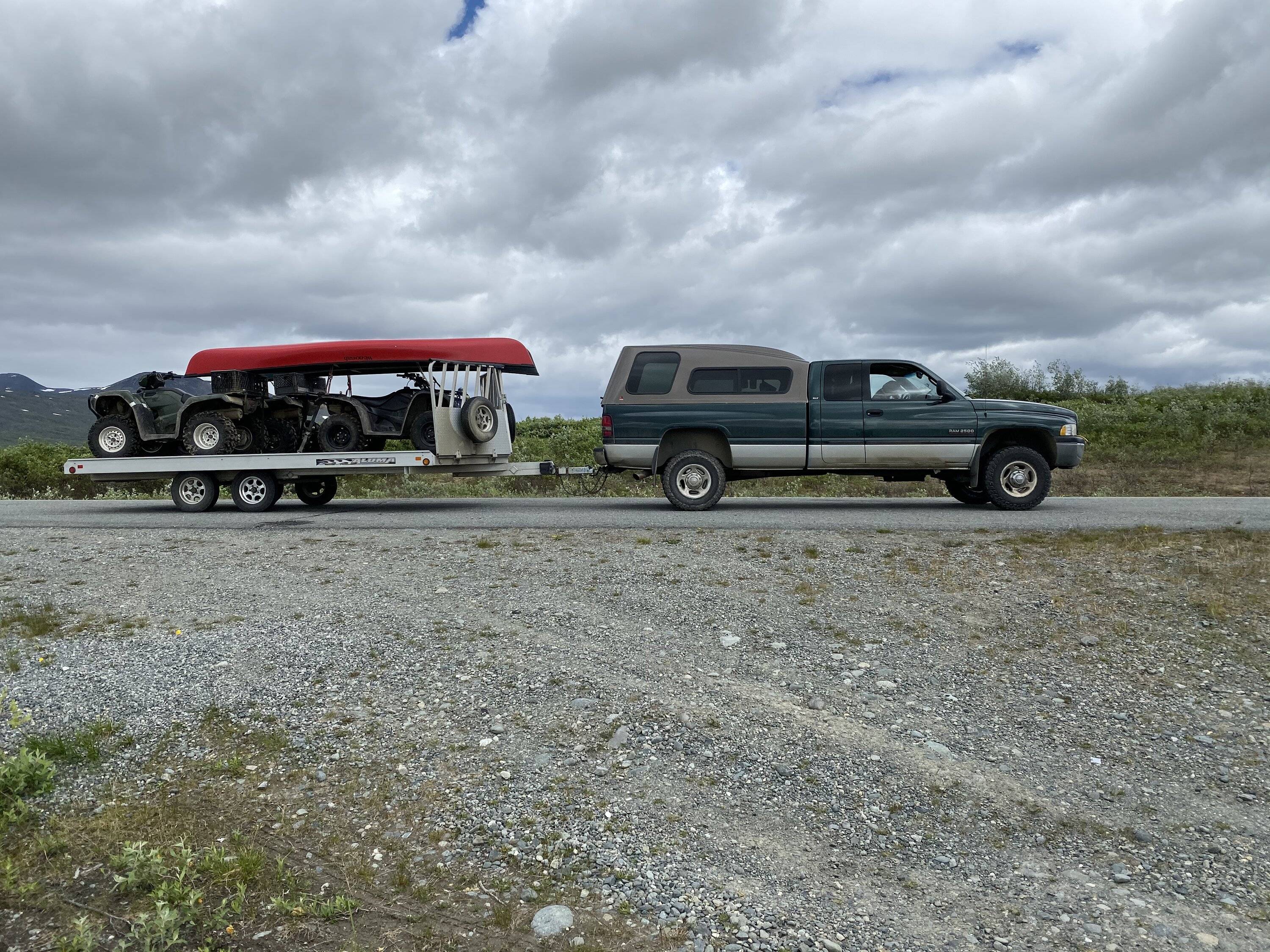

that’s why I hung on to my 2001 dodge cummins, the gladiator is good to go on the aluminum trailers…You best be paying attention to the loads though…
