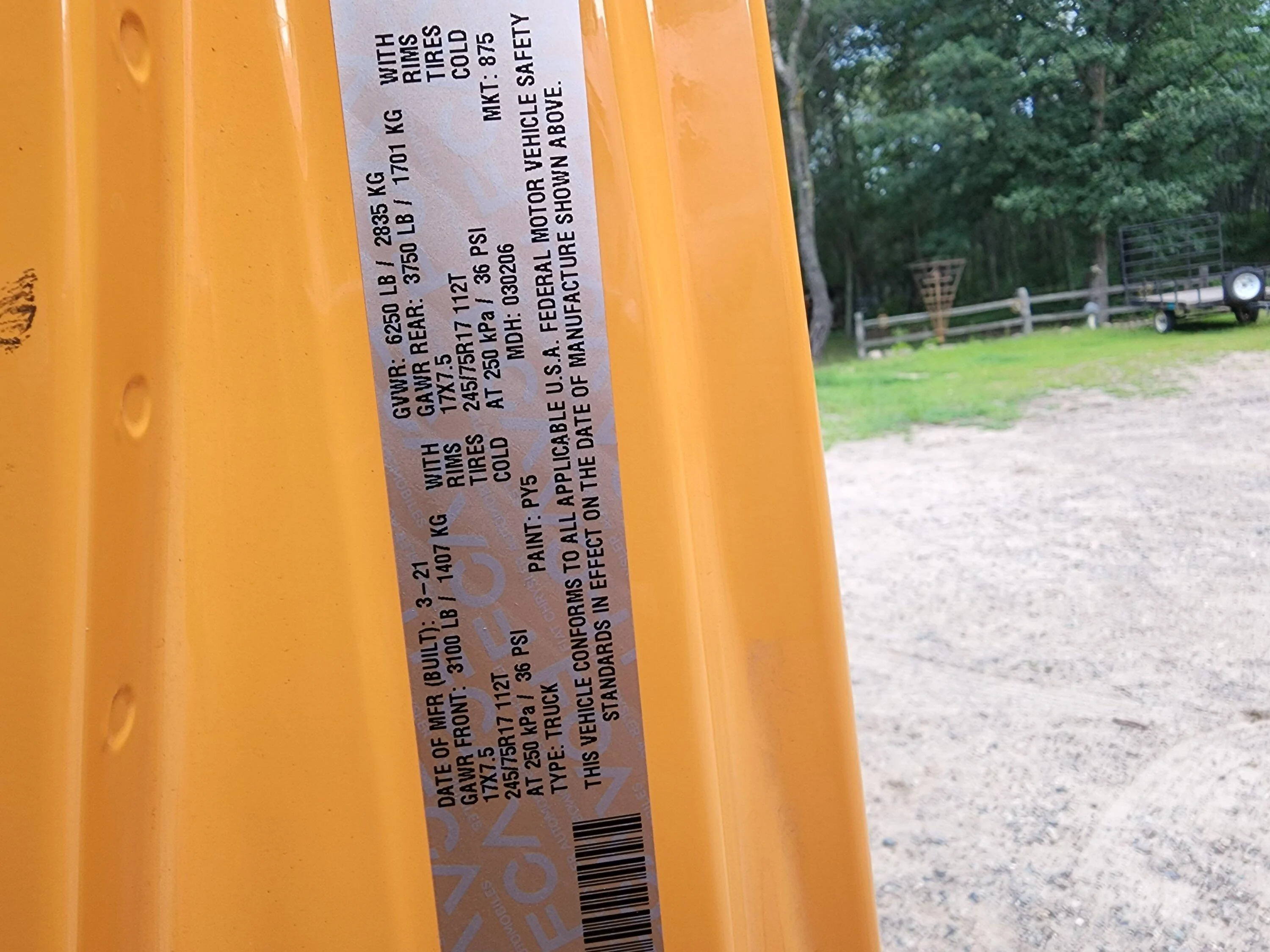

Here's a max tow door sticker 21 model for reference.

The little one?
Showed 1500ish or so. Didn't give me a trailer rating though ?
The stickers don't show a trailer rating. You need to go to the owner's manual for that and look up your model in the table on either page 214 or 215 (page numbers per the electronic pdf file I downloaded).

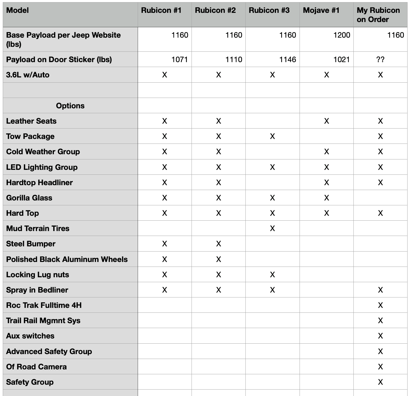

Still trying to answer my original question... so I compiled data from 4 Gladiators on my dealer's lot. Attached is a table with the numbers. What did it tell me? Unknown factors influence the payload number. Rubicon #1 and #2 are outfitted the same (except for paint color) and their payload numbers differ by 49 lbs. Skipping the leather seats, the cold weather group, the steel bumper and the headliner might save something like 30 to 70 lbs, per Rubicon #3. The Mojave has the fewest options but the biggest payload loss, which again points to random unknown factors. I'm guessing my number will be 1100 lbs +/-50. As @dcmdon pointed out, I'm worrying the small stuff. Where I'm at relative to the GCWR is the main thing to keep an eye on.

Everything has a weight cost. You're spending time trying derive an answer to a question that can't be answered. You ordered a truck with the options you wanted. It's possibly the wrong truck for your needs, but that's something you have to decide. The payload capacity will be automatically determined, based on the build, by the computer at the factory. The choices in options may make a difference of a hundred pounds. It's something you can't control. Unless you order a stripped down model, it won't be a significant difference, and that would just leave you with an uncomfortable vehicle to travel in. Based on the information already provided, you are going to be at the limit, or over. You'll have to learn how to be a slower vehicle in the right lane, and drive as safely as possible. Don't plan to be in any hurry when towing.
It's pretty clear that the capacity is not automatically determined by option list. There are some other factors involved. This seems clear by Rubicon #1 and #2 data. By the way, I'm confident I won't be over the GCWR. The GVWR is another story. I'll likely be over by 5-10%. Been there before and it should be ok. If not then I downsize the trailer or do something else.....
