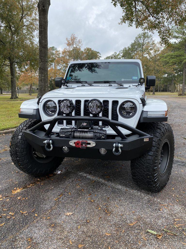

Jeep Gladiator What winch? 88937554-0C6D-4880-AFCD-0CF06A6BABC2
