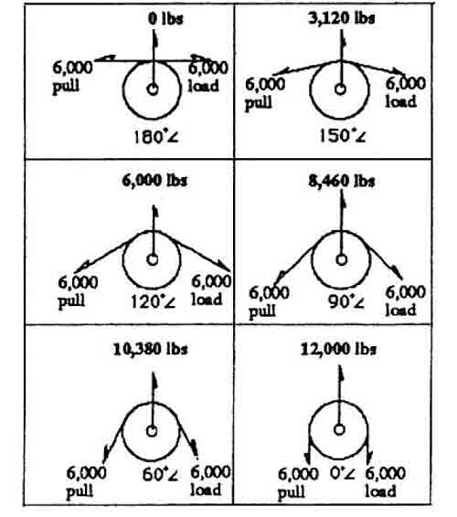

Now on the winch size needed the old norm was 1 1/2 times weight of vehicle. The military cheaped out at first and had 6k winches on HUMMVE. Now everyone is going "big" more for show than need, but on new Jeep's it might not be a bad idea... Lower AMP draw, the big reason I got a new winch and a 12 k one, next part that was touched on what is the winch mounted on rating? That's really important!! Will I ever need 12 k pulling power not likely if so I will be using a snatch block(s) why to spread the load out.
Use of snatch block winch to it and back to your vehicle double capacity - 10% for friction loss per military recovery manual. I'll try to photo of pages when I get a chance to.

No, this isn't right. The pulley doubles the total work capacity, but the load on the line doesn't change.
Your name must be Ed Zachary... Because you are EdZachary right. It doubles the overall strength, but straight line is still whatever the winch is rated for. So my Warn 9.5XP is rated @ 9,500 lbs. straight line pull...Add a snatchblock to the tree-side and run it directly back to the front bumper, and it will handle something that holds up to 19,000 lbs. of dead weight, because the pulley eases the load, but the winch will still only pull @ 9,500 lbs. The snatchblock just helps increase the ability to pull something heavier or with more force being exerted upon it (mud suction, etc...) than what the winch is rated for.

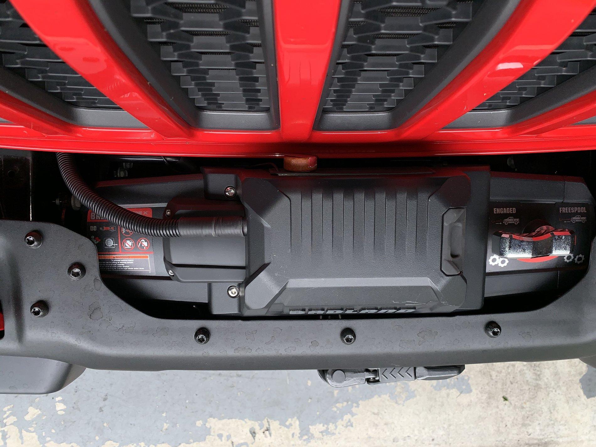

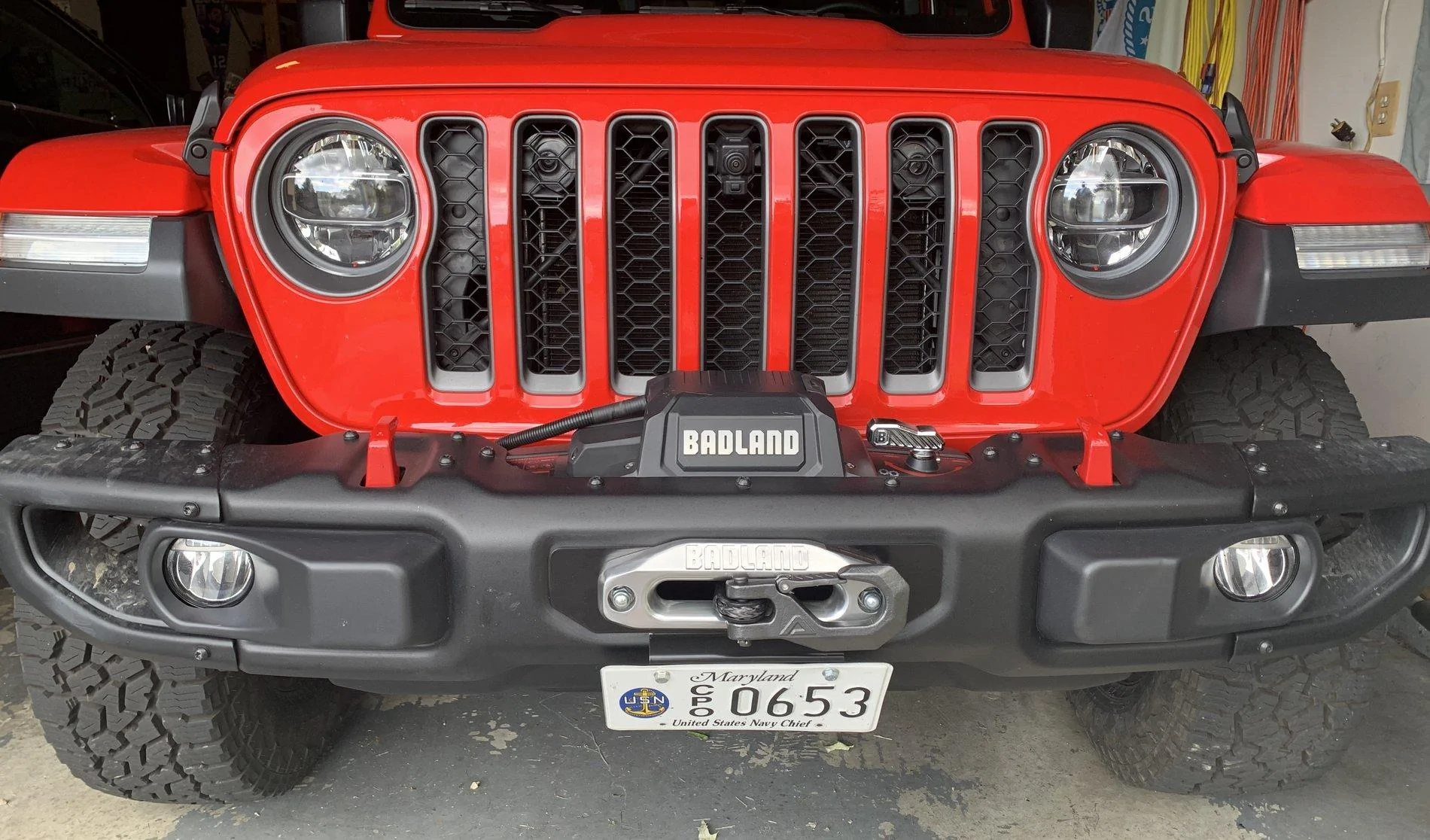

Badland Apex 12k, Warn winch plate and Poison Spyder spacer plates.
The black coil wrap you got going around the hook ups to the control box, is that how it comes or did you add that. Just asking because I like how that looks, way better than my last Badlands winch and some of the others I have saw for sale.

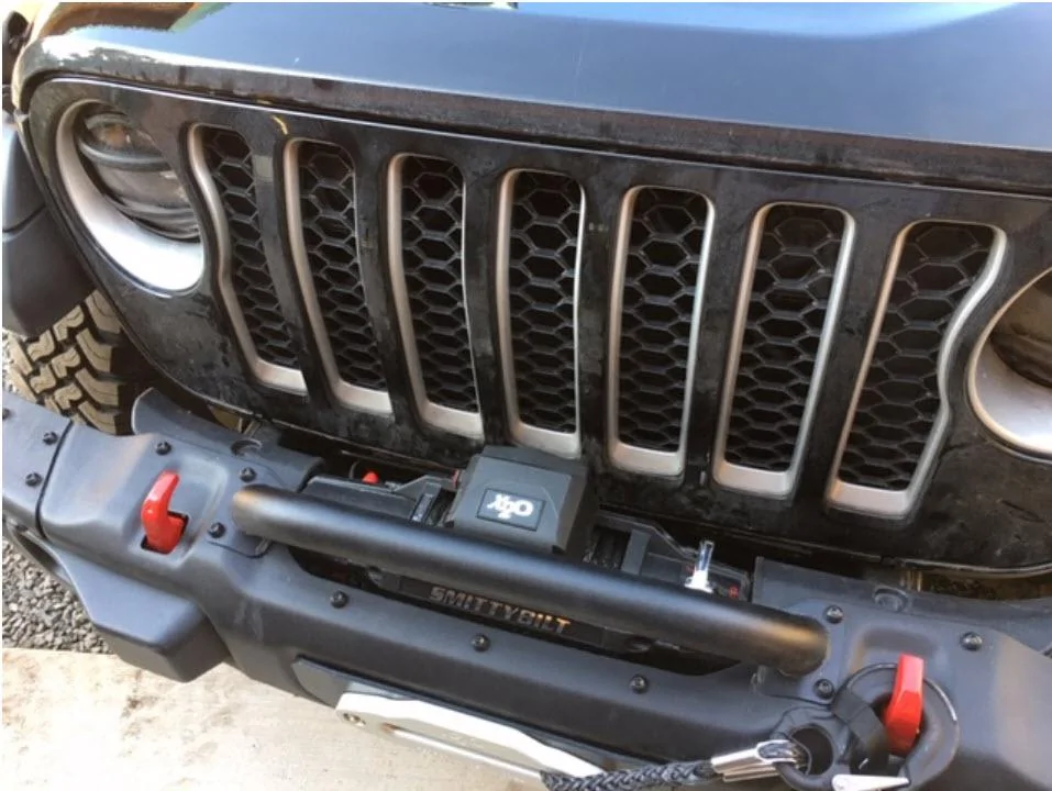

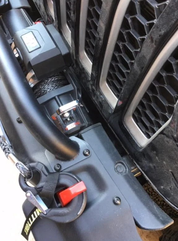

I'm looking at installing the 10K version. What winch plate did you use?
I've got the steel bumper, Warn low guard, and the Smittybuilt 12k winch. I used the warn winch plate. You'll need longer bolts for the fairlead+license plate bracket. In my research I read the Rugged Ridge ones are prone to bending, and the Warn was less than $50 more. Plus we can use the Quadratec forum discount.
That’s how it came. It seems like a pretty solid unit and install was easy thanks to Sorbs write up and pictures.
