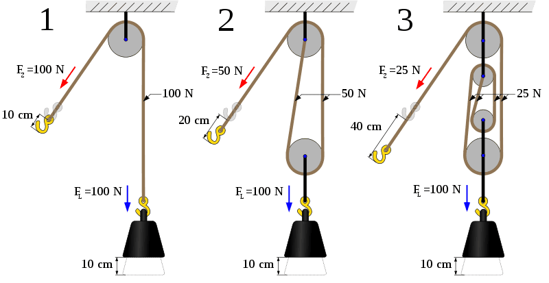

How does that work? The rating of the winch is based on things like the drum size, cooling, power intake, etc. From page 16 of the SB manual
With 85ft of line on the drum the winch pulls 6300lbs. With 40ft of line on the drum it pulls 8850lbs. That is about half the line on the drum remaining (equivalent to a snatch block letting out twice as much line) yet pull only went up 40%. What am I failing to understand?
Simple physics of a pulley system.
Jeep Gladiator What winch? 1601655806031
250
40,598
54,277
Like a lever as well. You can double force but something has to give - so you halve the distance moved.
It's work, and work is something like multiplying the force by the amount of movement.
Hydraulics, levers, pulleys, whatever.
If you want to lift more weight with a hydraulic cylinder, you can double the square inches of the piston, lift twice as much weight, but it will move half as far.
So you have done the SAME amount of work even though you moved it half as far because you moved twice as much.
You need to move 100 pounds, you have only 50 pounds of force. Using pulleys you can double your force - so you can still do it but will cut the distance in half in the process.
I think work usually involves Newtons and meters - Newtons for the force, Meters for the distance.
Work = F x D where F is force and D is distance.
