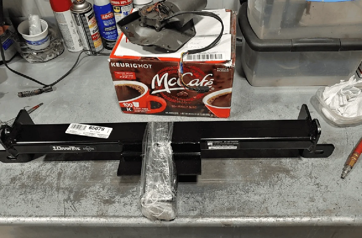

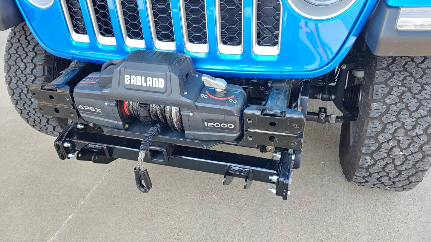

My bumper removed (to finish installing snow plow mount, the bottom bar is for snow plow, I have a receiver between winch plate and snow plow bar)
The stress of the winch pull is spread over the mounting plate. There is very little space or distance between winch mounting bolts and the places where the winch plate bolts to the frame.
The pull of this particular winch plate is BEHIND the bumper mounting ears of the frame. There are two other brackets along the side of the winch plate that bolt to the side of the frame rails. So you have a plate with minimal space between winch and frame rails. Plate is behind the frame ears. Triple thickness in that spot plus then you bolt the bumper on, adding even more strength.
With a receiver, you have only the small ears of the receiver where it mounts to the frame. The receiver part that receives a ball mount or winch cradle is welded to the bar that is between the frame rails. Since the winch sits out several inches in front of the receiver bar, a sideways pull can bend the receiver bar or even stress the welds. You have a whole lot of leverage with that winch sticking way out front of the receiver bar and a sideways pull can bend or break the receiver.
that's why they stress a limit of 9,000 pounds and STRAIGHT pull. Leverage - the winch has an incredible mechanical advantage over the receiver due to the distance between winch and receiver bar.

BTW - will sell this draw-tite cheap -
Anyway, look at the distance from the bar that the winch "cradle" is then add the distance the winch cradle itself spaces the winch away from the bar. A lot of side loading........
