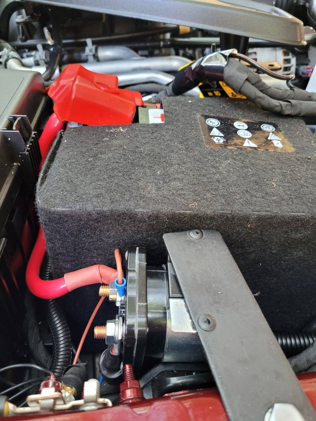

I run a 500A continuous duty solenoid on mine. It is mounted next to the main battery and controlled from one of my aux switches.
Do you have actual physical dimensions of that, including the studs, etc.?
if i change mine in the future, or if I blow mine out from abuse, that one is an option, as long as I could make it fit roughly where my current Warn solenoid is.
So far the Warn solenoid hasn't even gotten very warm with use.
Always looking for information, options and so on

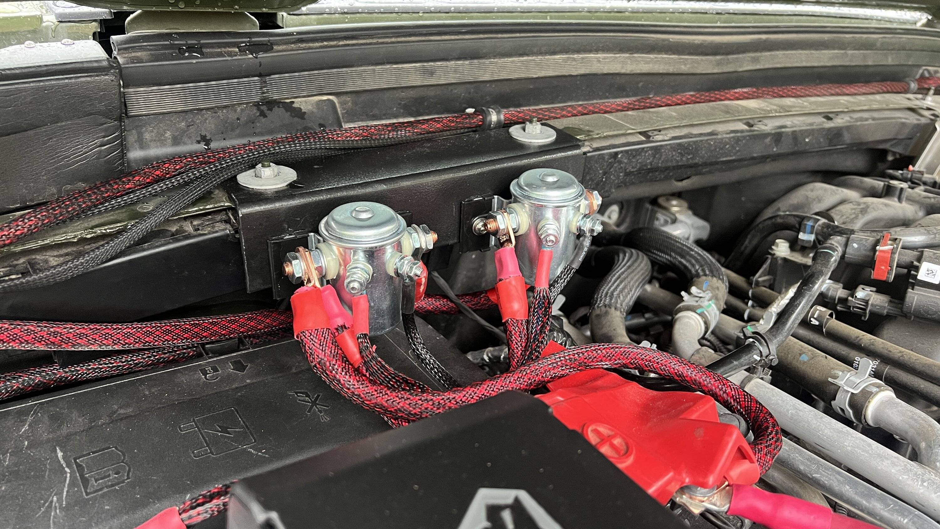

I second the solenoid option. Haven't had to do any hard winch pulls, but this setup works well. Currently operated by aux switch 3 for the front winch, and aux switch 4 for the rear.
I'll get them for you.
It's this solenoid.
https://www.amazon.com/gp/product/B085RCCHDM/ref=ppx_yo_dt_b_asin_title_o05_s00?ie=UTF8&psc=1

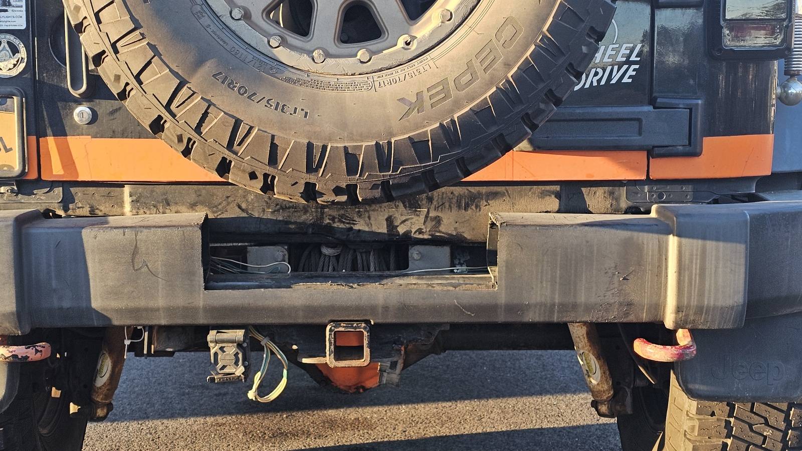

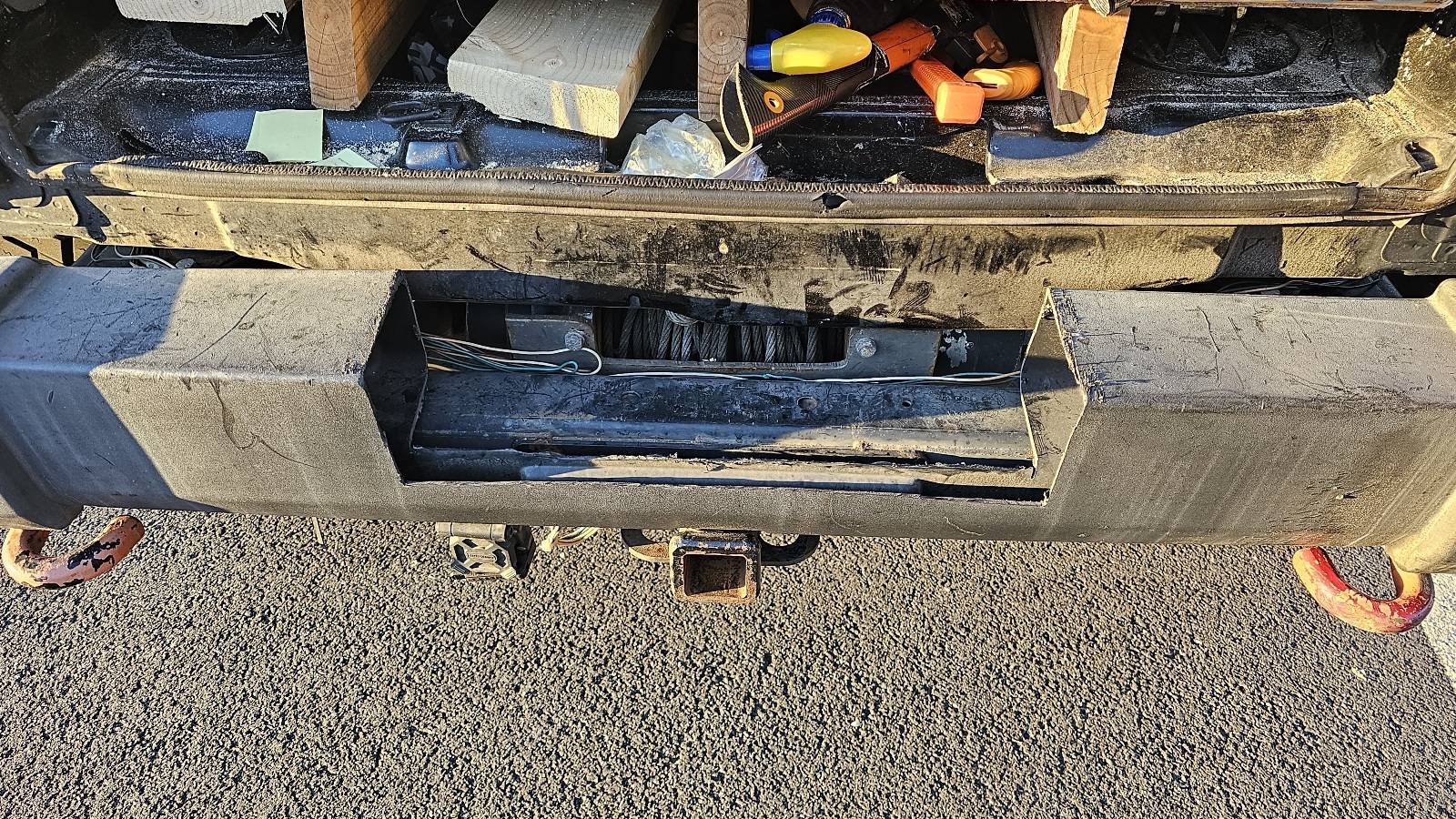

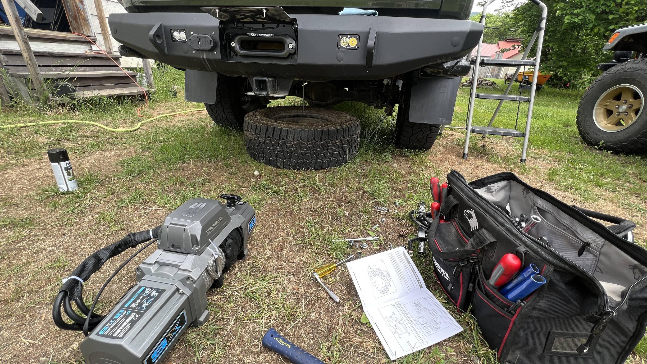

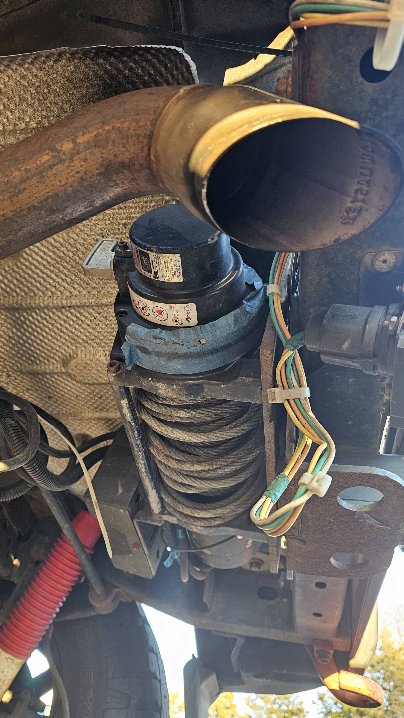

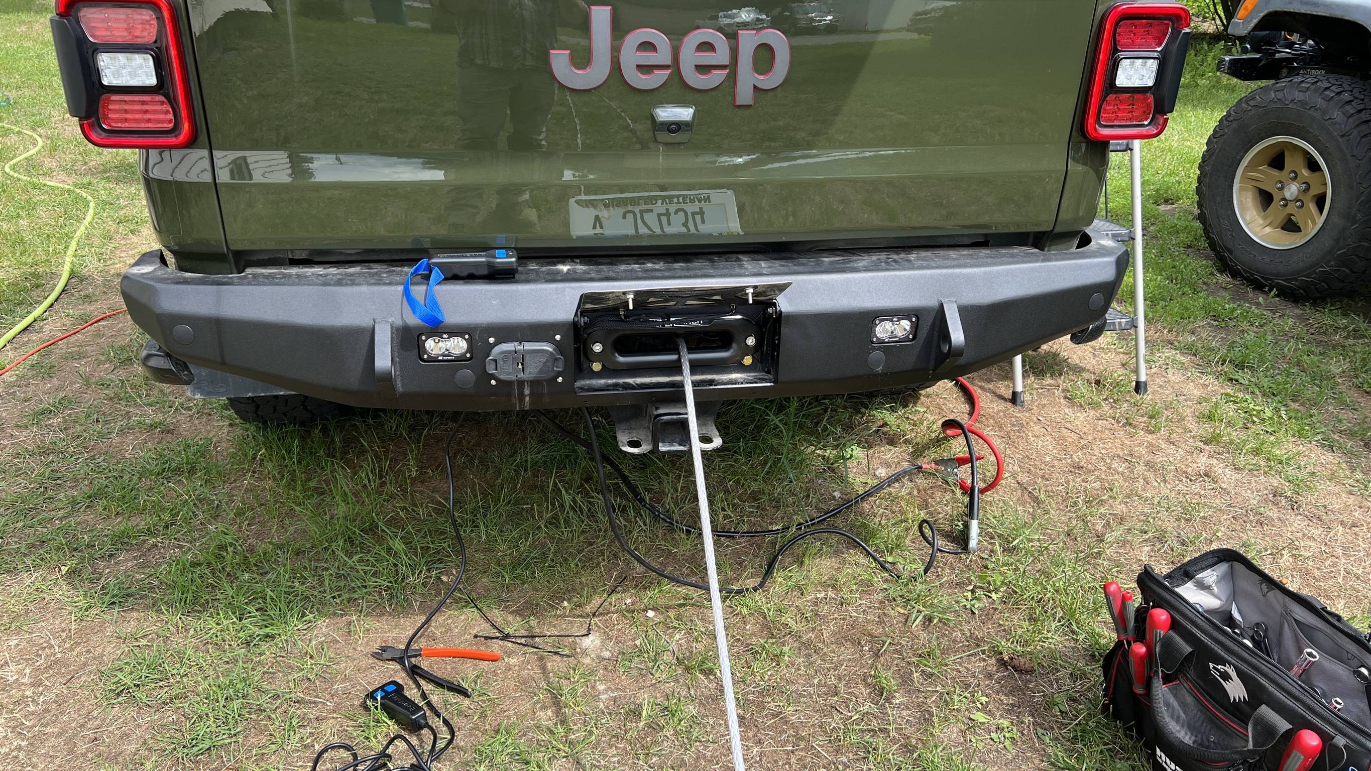

So on that topic, I recently added a 9k electric winch to the rear up under the where the muffler should be for nearly this exact reason.
I get it that sometimes you get into things that you find just aren't "crossable" and the smartest path is that path that led you there, only backwards.
That would be an interesting installation.
ACAD_Cowboy
Francis
May 1, 2019
1,414
1,960
NY
15 jkur

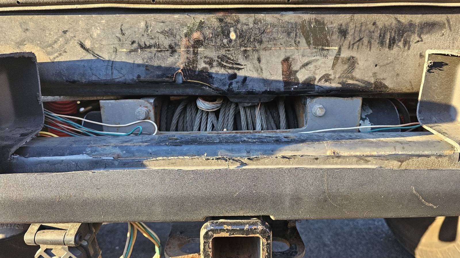

It's more primatitive utilitarian Expedition of The Americas style installation right now. Working on a trim skirt and roller fairlead integration at the moment. But it is bolted right to the rear crossmember using the bolts that hold the hitch on. I'd love to pass the cable through the hitch but side loading would destroy it despite looking cool.

The interesting reason I wanted to add it is it can extend your reach anchor wise, I can now tie off to a tree or rock or other vehicle a considerable distance from you who's stuck. I chock my wheels to pull you and then we just pull, reset, pull, reset and inchworm you to safety. It also means I can play silly games and pull from both ends like drag thr nose one way and the tail the other etc.
