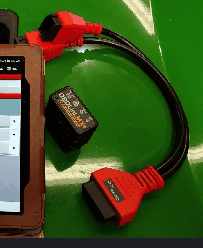

but what is the use for the security gateway dongle that looks like sec gateway connectors on one end and OBD on the other,
The security gateway itself is a security device sort of like a firewall in a network. But in our case, the SGW (security gateway) prevents changes to the truck's systems. Prevents someone from sticking a bluetooth OBD adapter on the OBDII port and changing things in your Jeep, or even remotely controlling the jeep, turning off or on certain things while driving near you. It prevents hacking, etc.
So to make changes to your Jeep, you need to bypass that security device, the SGW.
It's only needed to "change" something, not to read. You can still get information for the most part, but you can't make changes to things like gear ratios, tire size, idle speed or hundreds of other things that can be changed or modified in the various modules in the Jeep.
If you make changes and are done, you can remove that bypass cable and plug things back into the SGW.
This cable with the orange ends is the bypass cable. It connects to the cables that are unplugged from the SGW and allows you to directly connect a Bluetooth OBD adapter as shown below for making changes. If you leave this in place - it could technically be connected to by someone else and "hijacked" allowing someone else access.

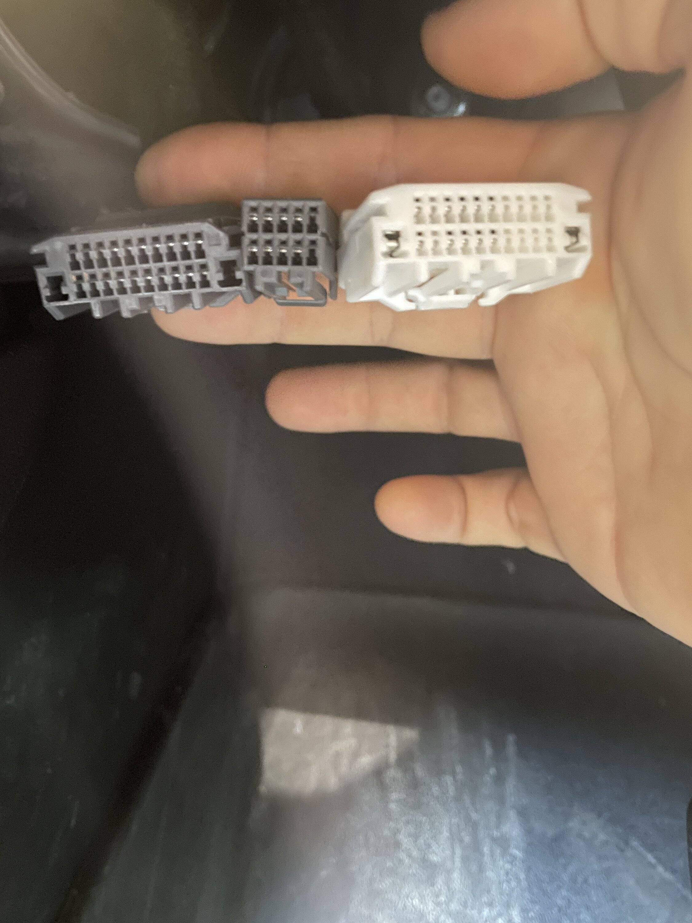

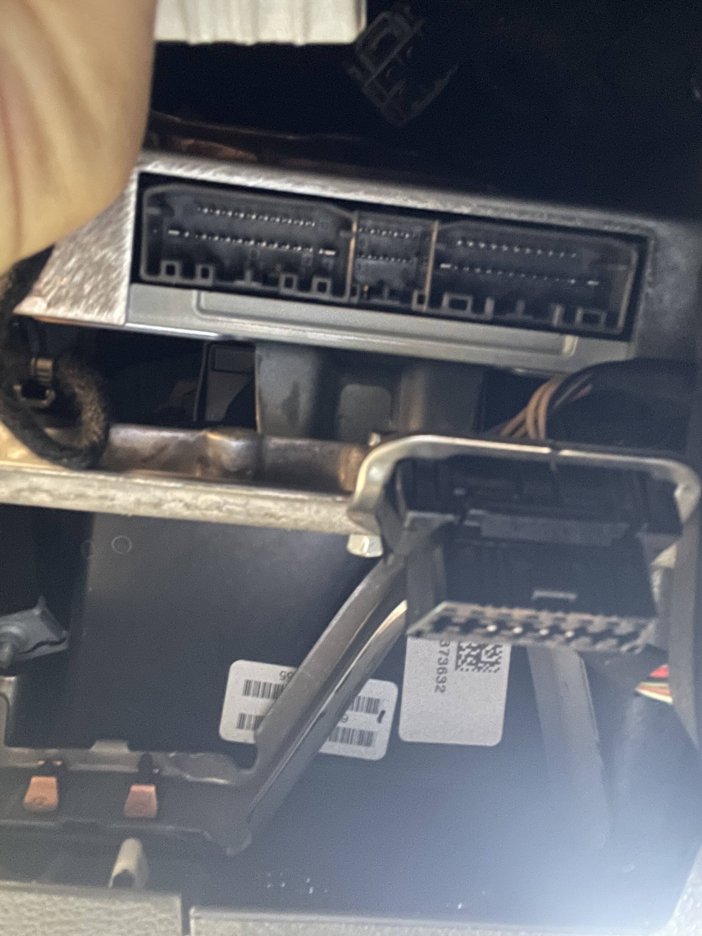

Hey guys dunno if I'm missing something but security gateway is different on 2023 like I said before, just realized how different. Cable suggested would not work on this, or am I missing something...(see pics)
That is the amplifier that you unplugged. SGW is same as other years.
I know not the white plug, but the smaller socket in the middle and other large to the side seem to be new security gateway ports, at least they're on same place as my 2020. Or is it just the small socket in the middle?
