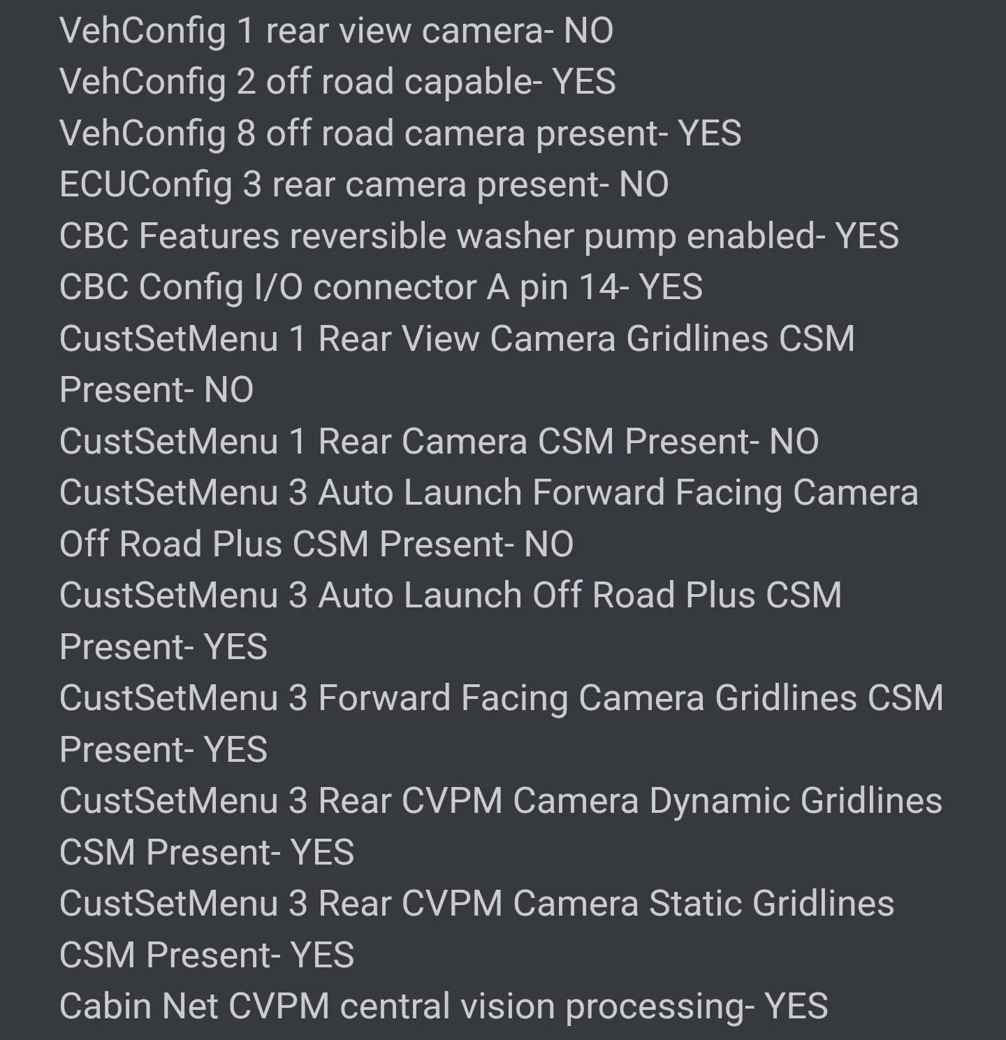

These are the settings. I've seen those who add the front trailcam give up on Jscan and use AlfaOBD. If you know of a success of a person adding it and using Jscan....lemme know ...it would be a big deal for people. I added the trailcam but started with AlfaOBD.
In case lurkers are wondering about "Pin 14" -
Connector A Pin 14: Washer Motor Control Right Rear Output Present/Front Camera Washer: No
Yes means there's a front camera washer. This is from mine, no camera, no washer, so that says NO.

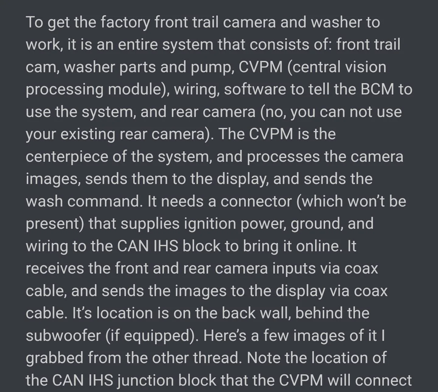

The harness runs along the driver fender...... you have to reverse the wires afterwards. If you don't....the windshield washer switch fires the front camera washer.....the clean front camera uconnect button fires the windshield washer!!! You can either depin and reverse or order the correct harness which I detail in my thread.

I'd love to read about a single dealer installed OEM front trailcam.....due to the custom harness required as no one is going to pull the entire body harness.....I am confident saying it's never been done.
Think about this. The camera is in the grille. It's wired to a box behind the rear cab trim. This wiring does not exist unless you bought the truck with it. Neither does the box. If you don't have a front trailcam....you don't have a CVPM behind the rear cab trim.

it has been a pleasure using this forum because i get to read and contemplate all of the different ideas. when I started the idea of installing the front trail cam, i had to do a lot of research on the wiring and parts to complete the project. once installed, i went to the dealership i work with and they tried to activate the system and could not get it to work, the dealership went thru the process with the engineer who finally agreed to place the code on the vehicle and he stated " he will never get it to work". thru Jimmy007, and ALPHOBD he made it work. it is true that if and software updates to the system are done at the dealership you have to go and reload the system which is easy because you have the logs from ALPHAOBD. on the question of a dealership doing the install, Keep dreaming. i say this because the techs are not able to think outside of the box anymore and for something like this, you have to think outside the box.
