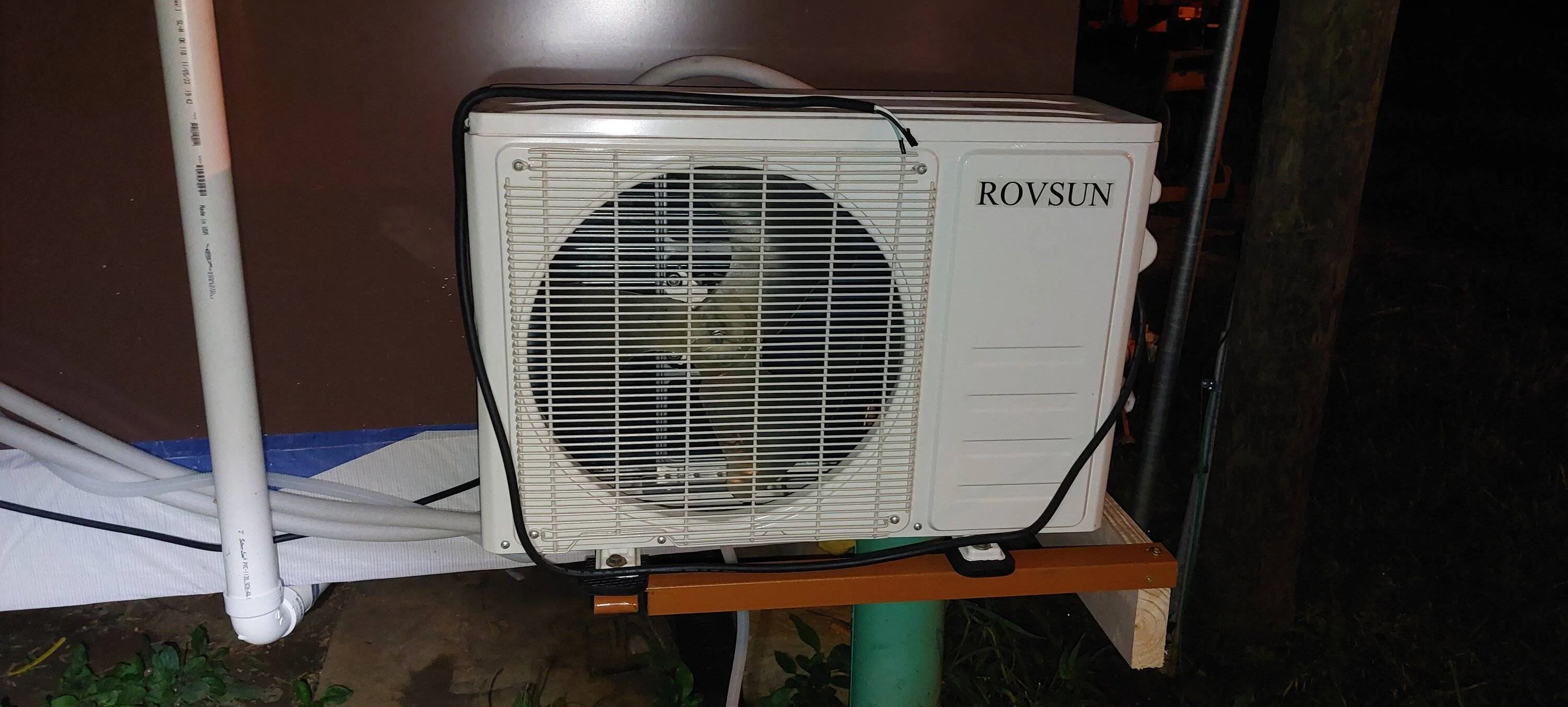

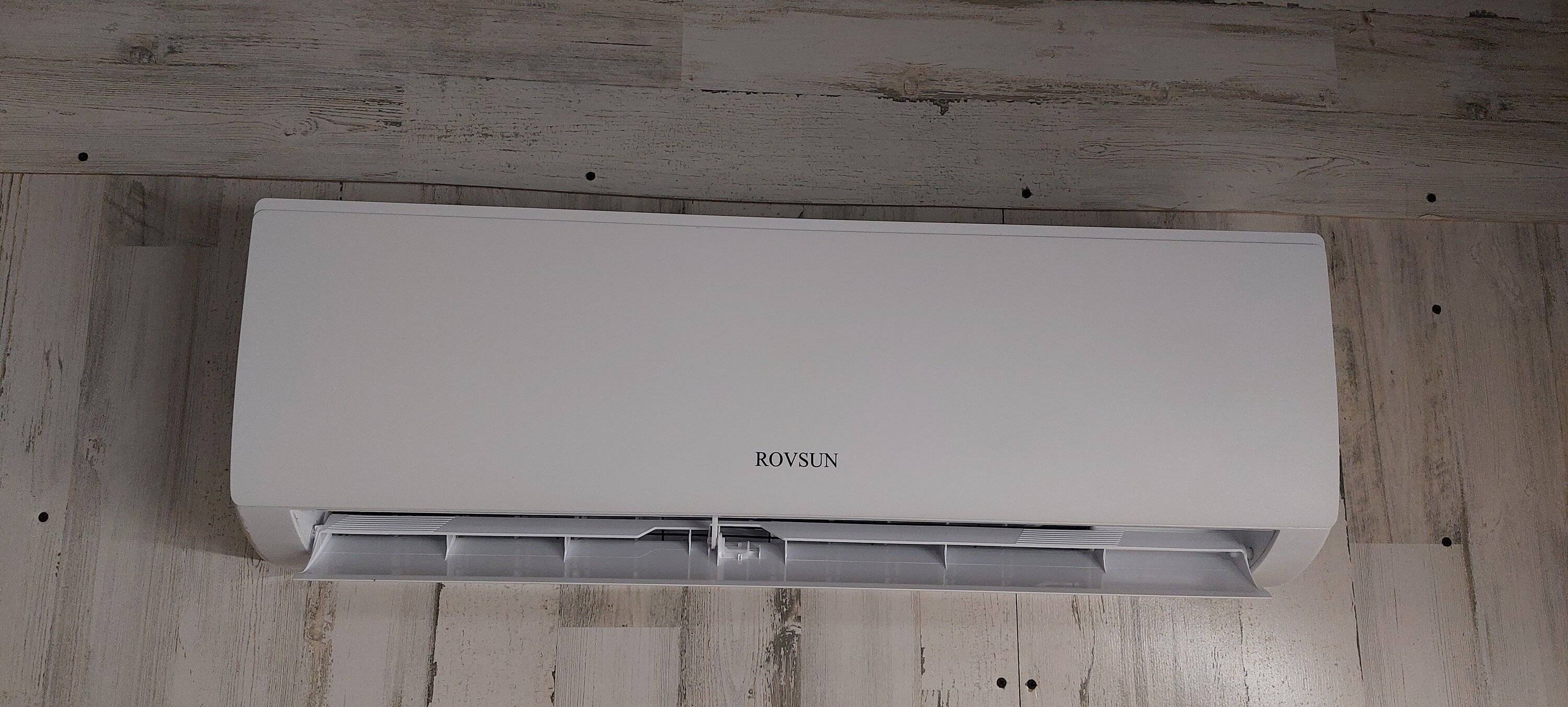

I'm installing a mini split in my "Tiny house" I've been building, "12000 BTU 120v" simple install so far. I've got to put in breaker and wire it. Purge it, pressure test and up and running. Cost total less than $800.°° that's including a vacuum pump and fittings for it too. The size I'm cooling is 12'x26'x9' apx. Insulation is R19 walls ceiling and R30 floor. Right now I'm just using a 9000 btu portable A.C. I turned on the portable unit on 4 July. I'm up about 100 kw from month before without using A.C in June. I do know it's not the same thing but this can give you a idea on options.
Jeep Gladiator Who Installed AC in Their Garage? 16900847579301347663966539348561
Jeep Gladiator Who Installed AC in Their Garage? 16900847919738390743797919786027
I'm in N. AL. So quite warm and humidity is nasty especially with all the rain. Not as bad as Savannah GA or Florida though.
I installed a "window unit" in back wall of a 10x16 portable building seven years ago from box store. It's holding up but as said by others the humidity is a problem still. I've found mold and mildew stains on lower part of wall. This is why I figured I would try a mini split. Quite a few have installed them on or in RV's and T.T. in last few years with good results.

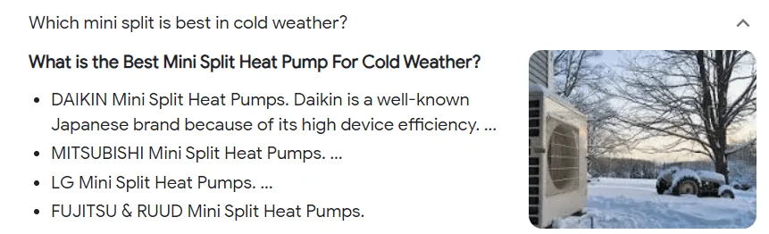

Daikin has the best cold weather rating for people up in our area - they'll run and furnish heat even at around 11-15 below 0
I did a lot of hours of research on minisplits tis time around as we wanted something that could keep putting out efficient heat even below 0 with no auxiliary heat needed.
But where he lives he's not going to give a rip about this LOL -
You are correct. The Daikin Aurora mini split systems will heat efficiently down to -15 degrees outdoor ambient temperatures. They will heat below those temperatures, but it won’t keep the indoor space at 70 degrees.
