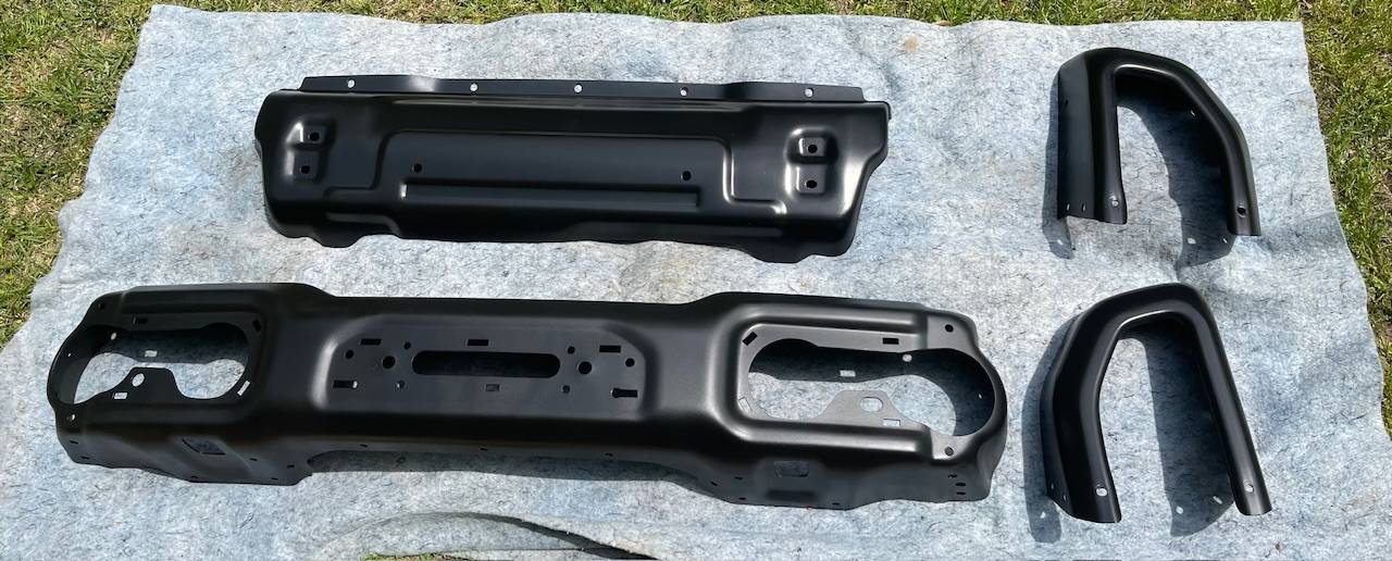

We installed a MP concepts aluminum bumper on the JT, did not use the winch plate yet, others say its not so good, so we may use the original Mopar winch plate, on this bumper.
Fitment and installation as good, however we changed some of the cheap coated hardware, at the coating was brittle out of the bag.
from your post its not clear from what chinese bumpers you speak.
Don’t get me started on what garbage that bumper is, but don’t use th mounting plate it came with. IF you modify it enough to make it even work, it’s a weak, flawed design. I used the Warn one and it’s great and way stronger. Although, not having a rubicon or using the Mopar steel front skid, I had to buy the front mounting hardware for it to work. I ended up having to buy almost $500 worth of parts for that POS bumper to work and almost $100 in paint and supplies because the powder coat is a joke. $399 for the warn winch plate and $89 for the front skid plate brackets and hardware. It comes as a kit. If you use the Mopar winch plate, make sure that it comes with that brackets or you’ll want to order them too.

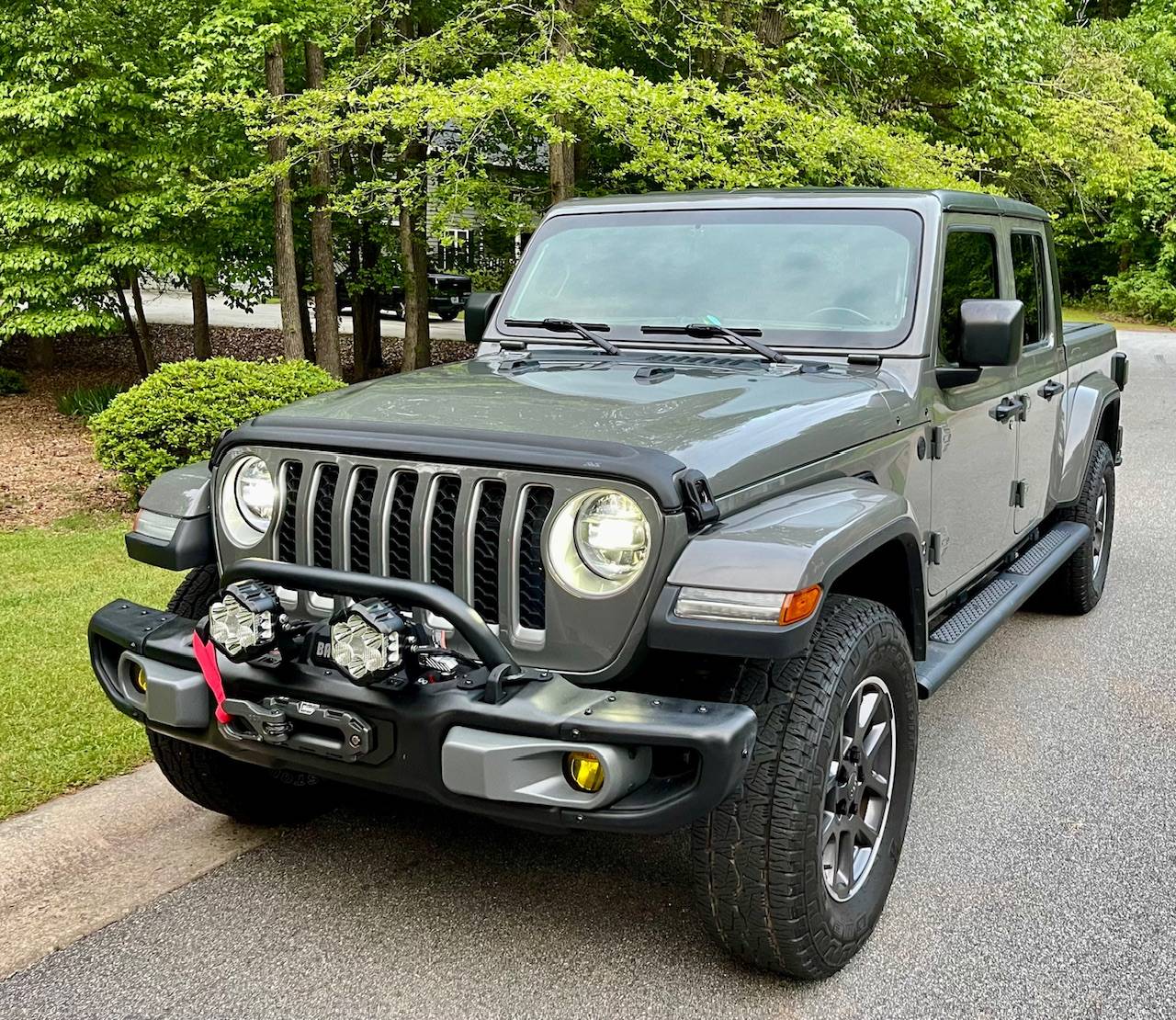

Knock-off steel bumper via eBay, and bulldog winch plate. Could have used spacers to lift the winch a bit. I think the winch sat a tad low with the bulldog plate. It sat about right with the plate that came with the bumper.

By the time you spend the money to add the warn winch plate, you’d might as well have just bought the warn bumper with the integrated winch plate for the same price. When you add the weight of the winch plate to the MP Concept, the difference in weight is negligible. Plus, the Warn is one of the better looking examples.
Jeep Gladiator Winch recommendations for Knock-Off Mopar Steel Front Bumper IMG_3809
I truly regret my purchase. The Warn would have saved me several hours of labor, a week of letting the paint cure, and I like it better.
