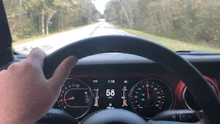

I posted this on one of the other threads, but this is my steering at about 60 mph. I've tried going down to as low as 26 psi with the same. This was taken today at 37 psi warm.
The air in FL must weigh different than the air up here in NY. That’s your issue. Lmao!
