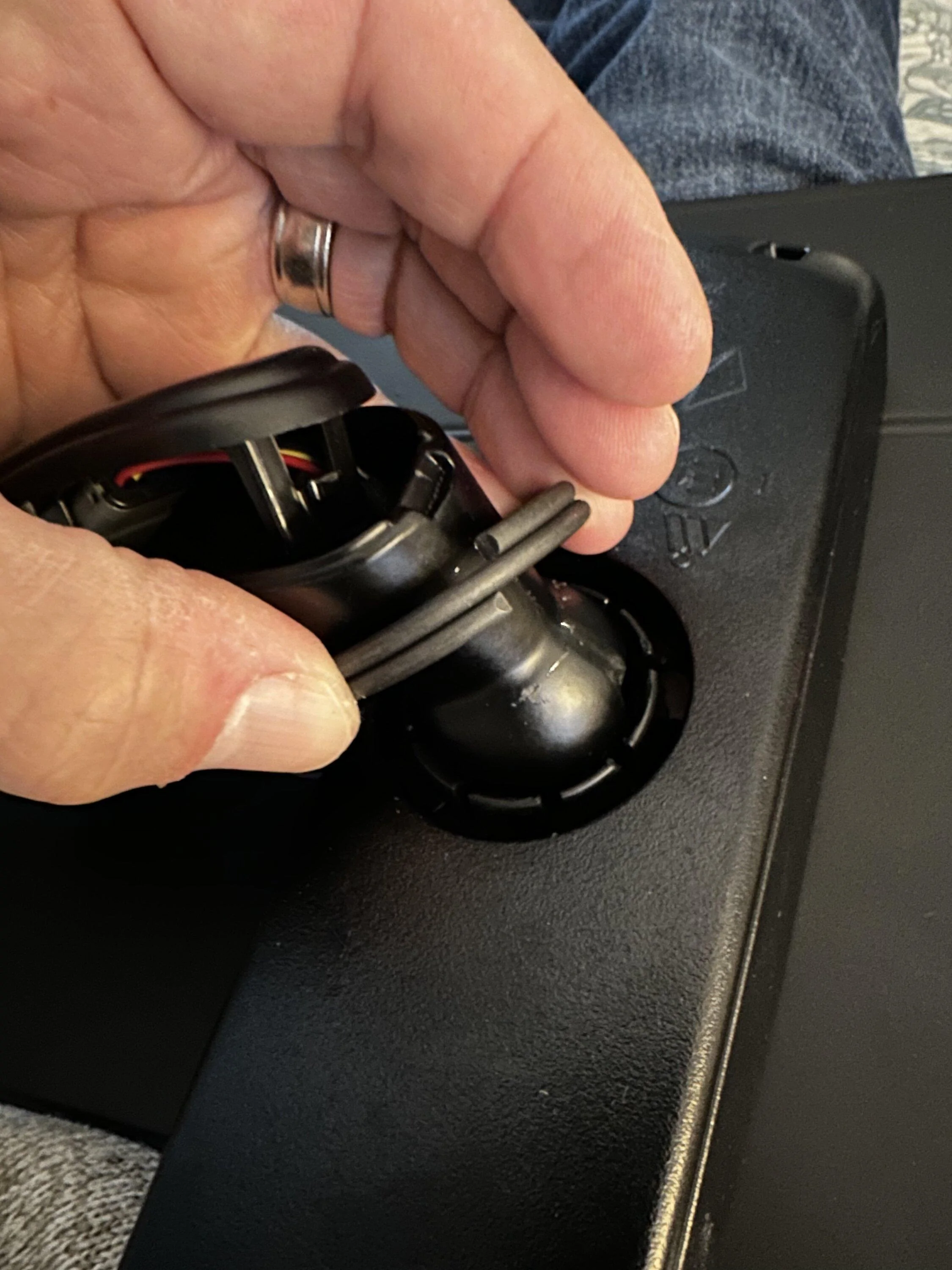

One of my major peeves with the JT has been the blind spot created by the mirror. I have the auto-dim but not the auto cruise control. I’ve used this thread and others to evaluate options. I figured there was value in taking the mirror off and evaluating the options.

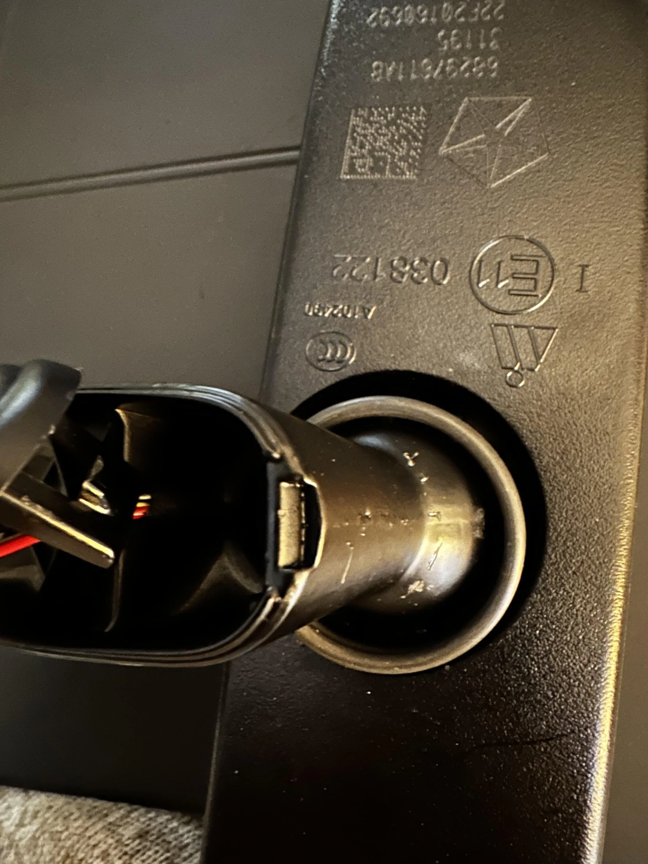

The mirror assembly twisted off as with the manual mirror. There is a single cable concealed behind the back plastic cover. The cover has a small slot at the bottom to pop off the cover and reveal the connector. Unplugged the entire assembly can be removed.

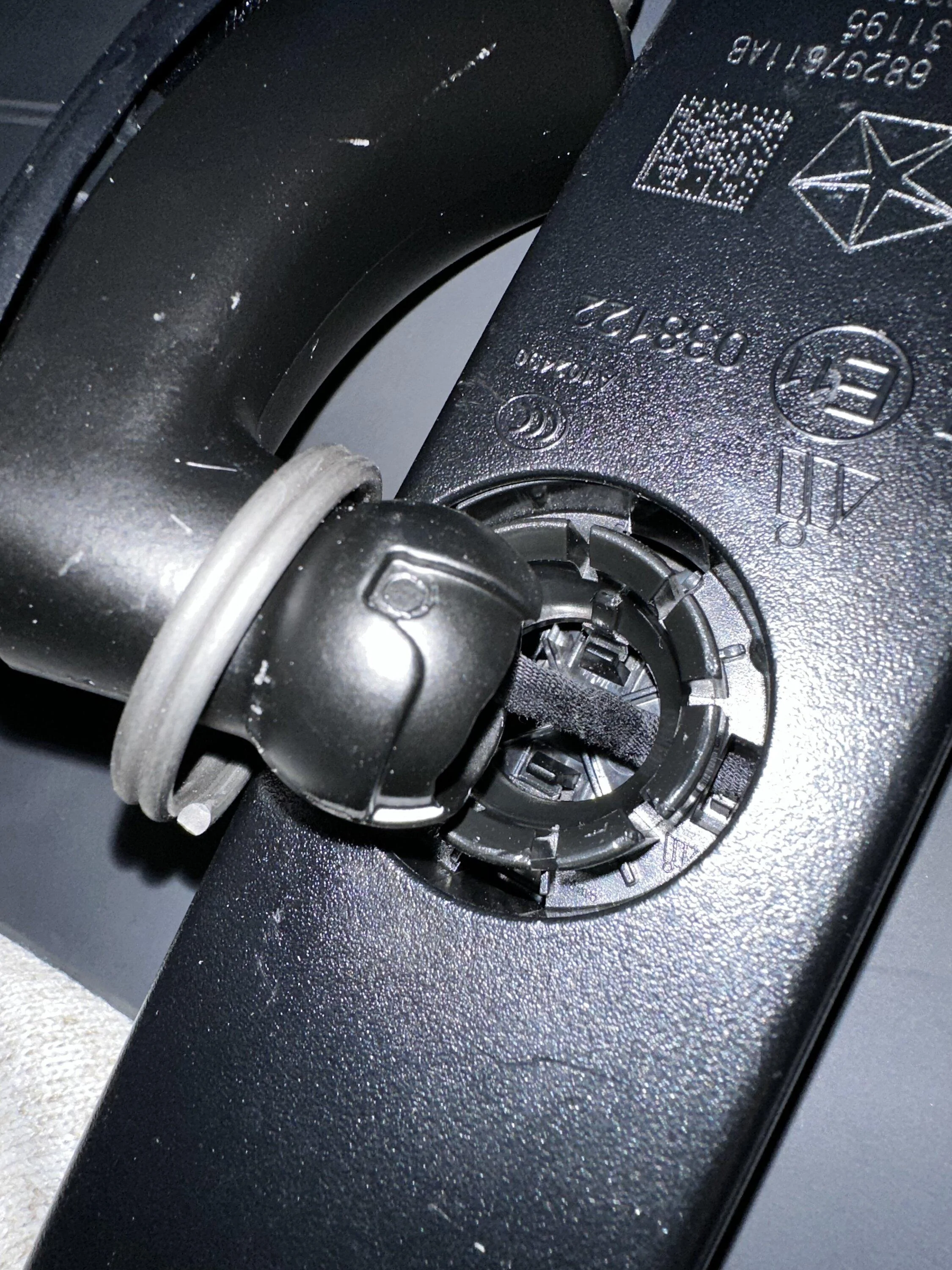

The shaft is aluminum with the ball held in place by the spring loops. I used a small screwdriver to lift the spring end up and rotate it over the plastic tabs as I rotated it around. This allowed the ball to be removed from the surround. Examination of the ball reveals a detent shaped into the side that restricts the rotation of the assembly using a corresponding bump on the plastic surround.
I am now trying to figure out how to remove the surround from the mirror assembly without destruction of any of the plastic. I’d like to try to merely rotate the inner assembly to avoid grinding off the bump thereby allowing me to rotate the mirror and get a little bit more visibility through the windshield.
Another question is what other Jeeps, or other vehicles, have a similar arm with the same dimensions for the ball and the upper attachment point (though that could be fixed more easily) but with a shorter arm. That would allow one to replace the arm without the other work and be a more elegant solution. Wondering if there’s anyone on the board with more experience / information regarding the other arms that may be out there already?

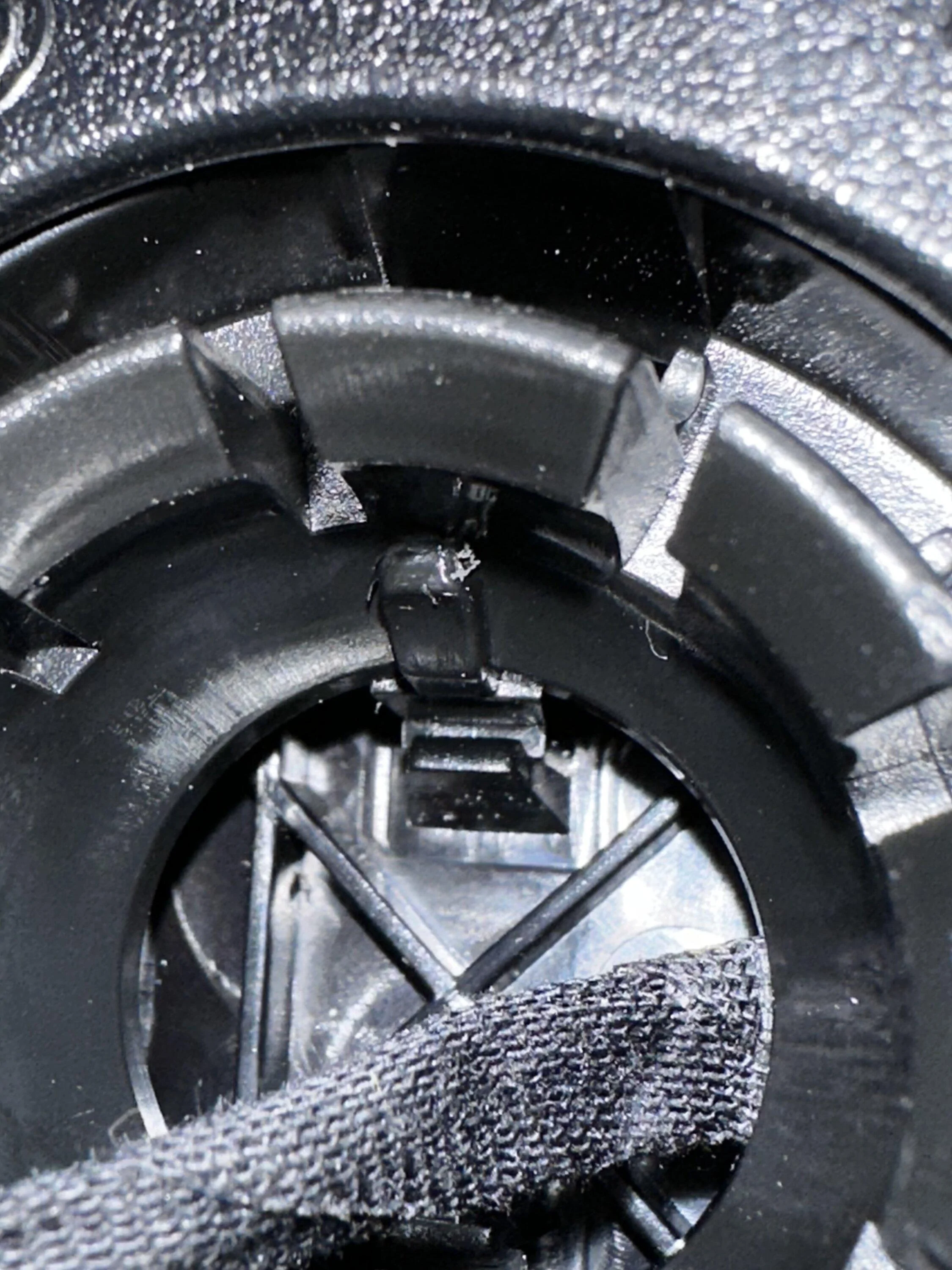

I dremalled the plastic stub out of the mirror so the mirror could flip on the ball… the detent is not really necessary unless i suppose someone was to spin the mirror multiple times and end up damaging the internal wiring.

So Mr. Dremel was not cooperating so I used a dremel bit in my drill to grind off the nub. Went fairly well with no hiccups. Did not need to grind is smooth, just took the tops off.
To reassemble the mirror I placed it face down on a towel. I then pushed the spring into the receiver first and seated it around the socket. Once the spring was seated I was able to push down on the ball and seat it firmly in the socket. It took some force but popped in with pressure. I tested the movement to ensure it was still smooth but tight. Seemed fine in adjustment without being either too loose or too stiff.

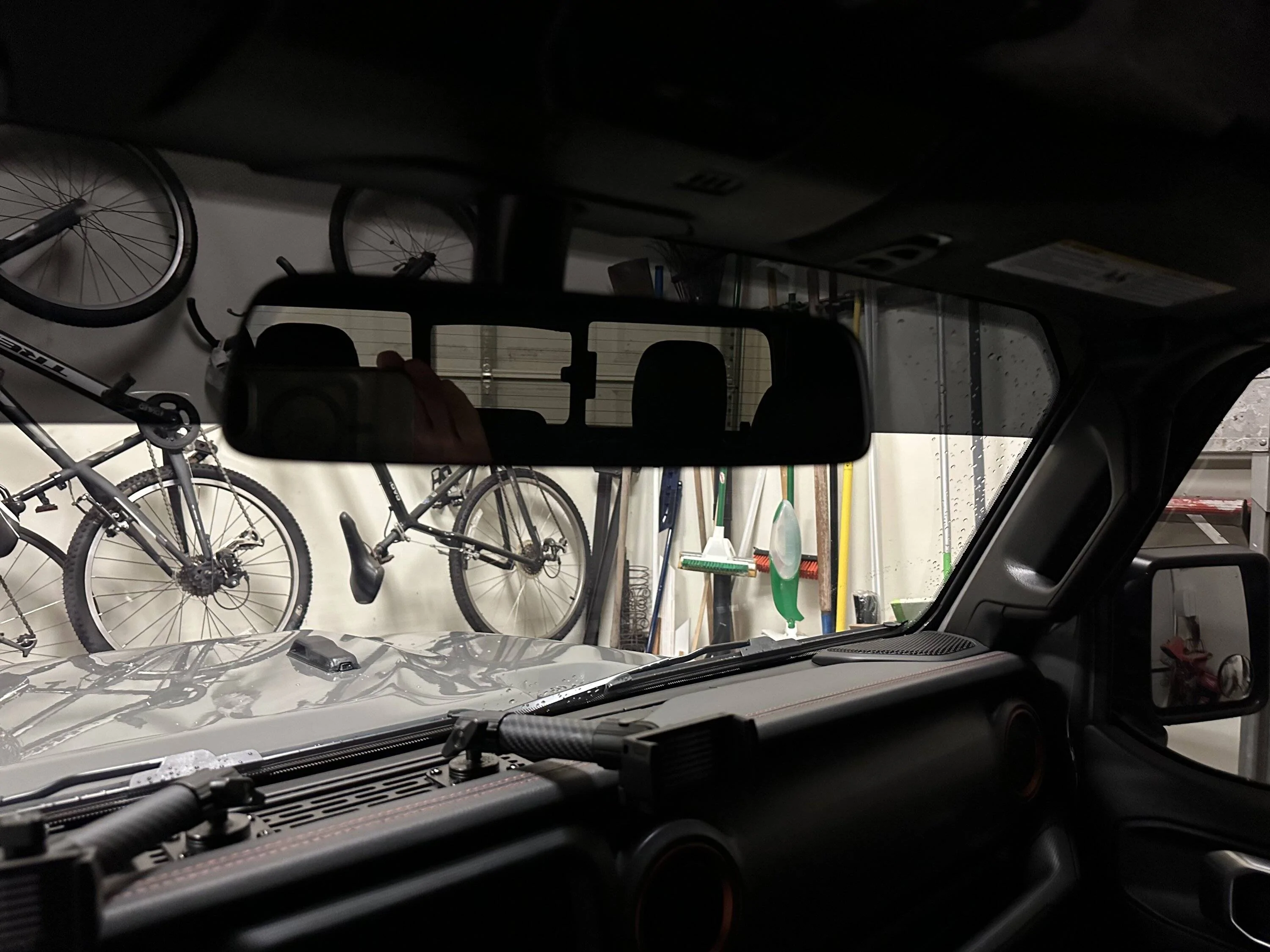

It is definitely an improvement over the stock position but probably a half inch based on the offset of the joint on the mirror being moved from below the ball to above. I’d still like to see it another inch higher and hope I can find a shorter mount in another application. I’ve included an ‘after’ photo of the mounted location. Since this is / was a freebie I think it was worthwhile. But, there is still room for improvement in the forward vision.
