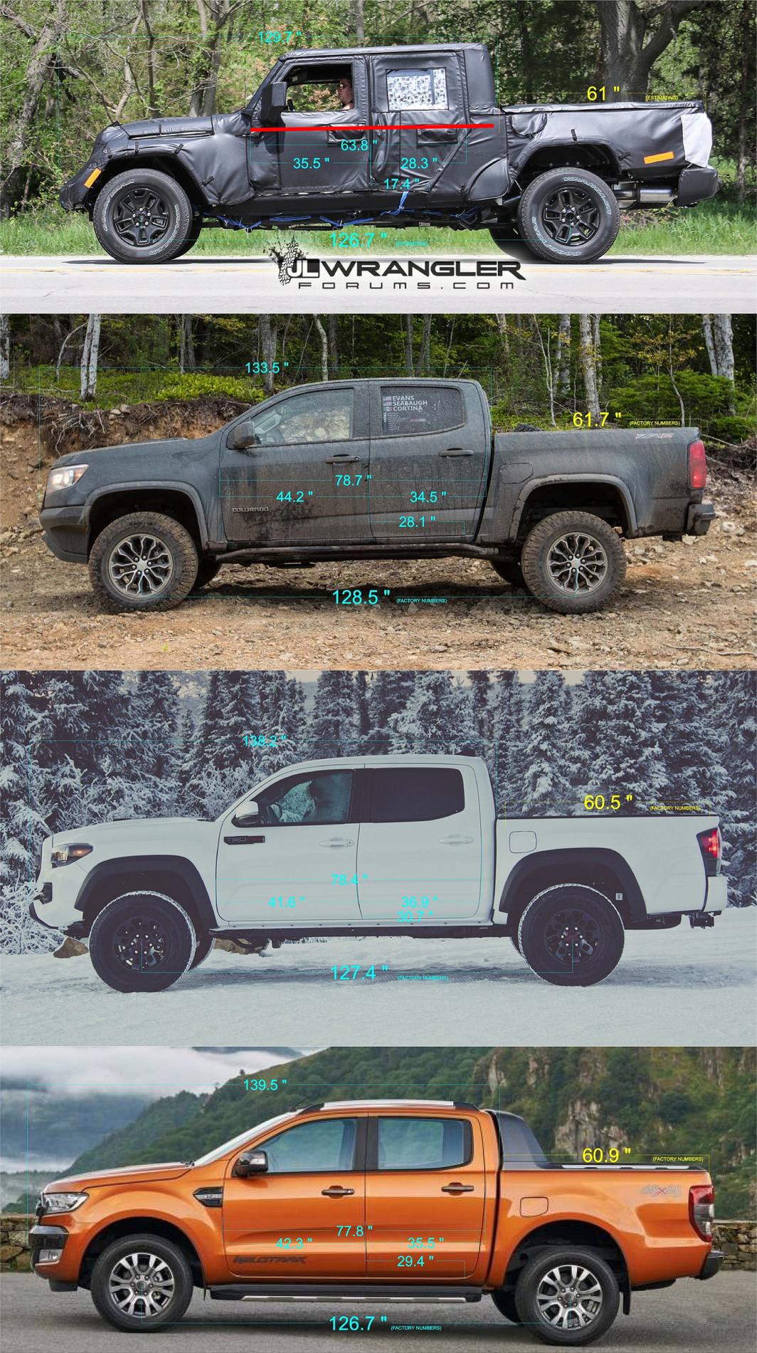

Thanks for the that!!!!
Based on those it looks like the JT has 15" less interior room :(
EDIT: Just realized you where measuring to back of the rear doors and not full cab length. So there might not be that big of a difference as most of the others have the doors all go all the way back to the back of the cab where the JT has rear doors do not.
It is kind of difficult to pin point where to measure from when it still is mostly covered up with the spy camo. But I tried looking at the less covered JL Unlimited, from a couple of days ago, for reference.

yeah it looks like lost room is because the motor is set further back. The head lights of the JT are basically set right infront the front wheels, giving awesome clearance for going off road, yet sacrificing leg room for us bigger guys... ill take it though, the passengers in the back will just have to suffer... don't tell my daughters lol...

I dont think it will be that much different. Check out the Redline on this as I think thats the actual cab size, as right now in my JKU the exterior goes all the way to the back of the top. Its just that unlike the rest the door line doesn't go all the way to the back of the cab. This is probably due to them reusing the doors off the JL.

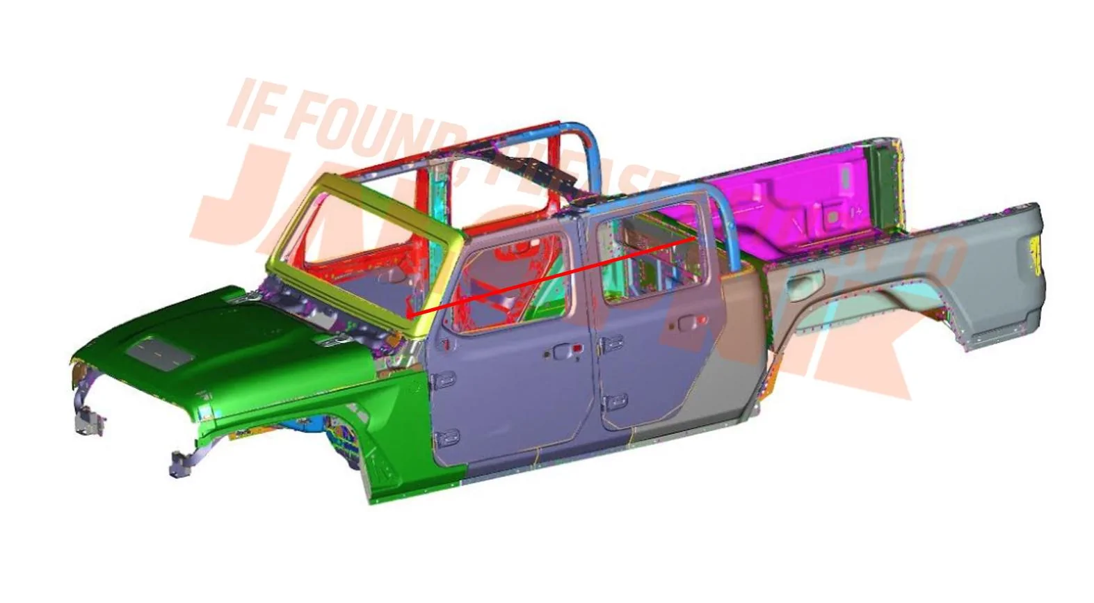

Also Checking Out the CAD you can see how far back past the door line the rear interior goes:

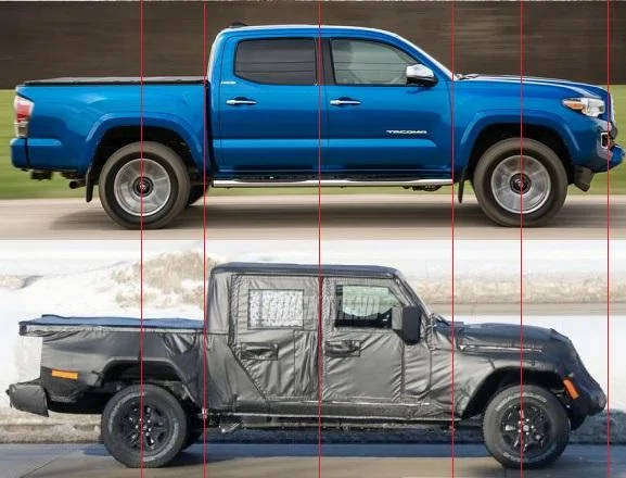

Anyone have estimates on the total length of the JT? The estimates above put the JT at 190.7" (cab length 129.7" + bed length 61") which sounds a little short. Tacoma short bed is 212.3" and Chevy Colorado is 212.4" and I would expect the JT to be within that vicinity.
Also, if you overlay the Tacoma with the JT, assuming a similar length, it looks like the JT has a better approach angle but a worse departure angle than the Taco. My primitive attempt at comparing the two side by side:

JT FRAME AND AXLES (CAD FILES)
As revealed in this thread, we have the CAD files for the new frame and axles slated for the 2019 Gladiator which show under-the-skin differences between the JT and the current model JK/JKU Wrangler.
  • The first CAD image shows a comparison of the JT frame to that of the the 4-door JK Unlimited (see the tab in the CAD image showing filename: "frame Line Skillet 2D compare to JK").
  • Based on a calculation of the measurements in AutoCAD, the images show the JT pickup truck's frame (205-inches) will be approximately 18% (33-inches) longer than that of the 4-door JK Unlimited frame (172-inches), as the JT spy photos and video have shown.

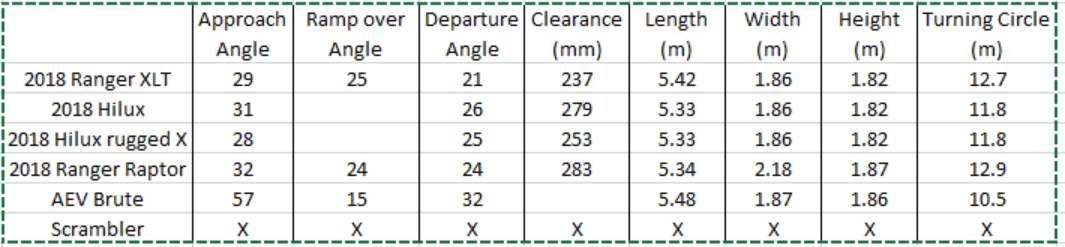

I also loosely supported it based on the AEV brute being 139" and 216"....figured they would be ballpark
