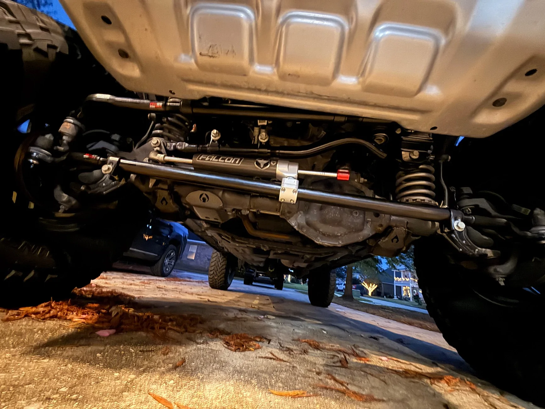

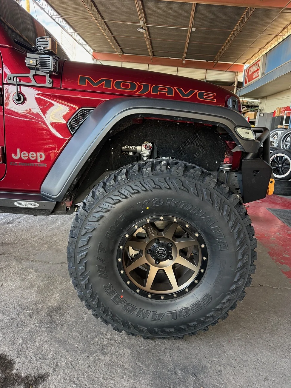

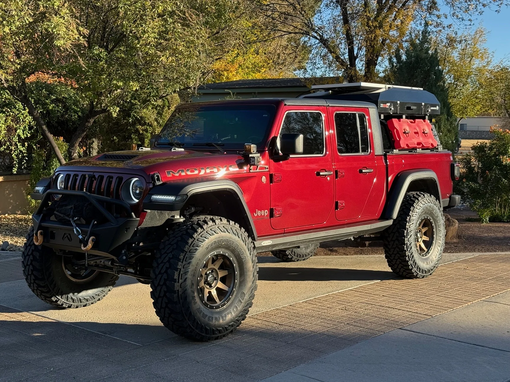

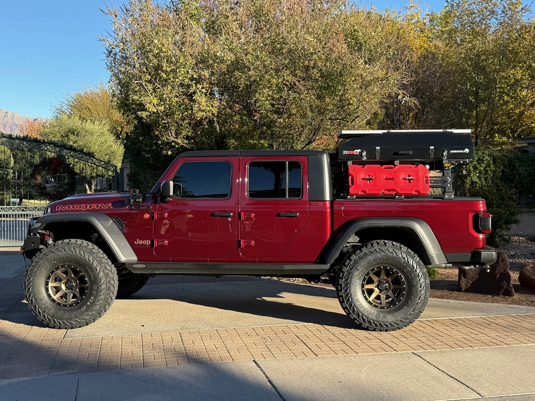

Got complete Steer Smarts Yeti XD steering components installed today. Drives almost like stock with 40s. I’m happy with how it turned out. Next mod will be gears. Kind of on the fence between 5:13s and 5:88s.

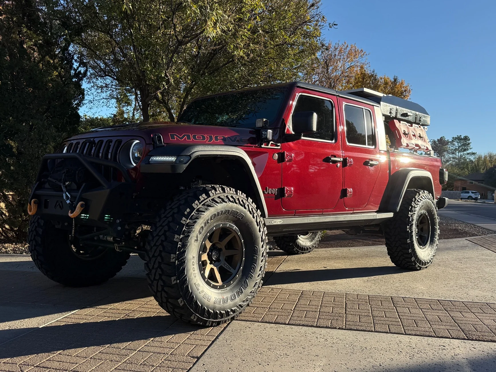

40's installed!! Man what a crazy difference!

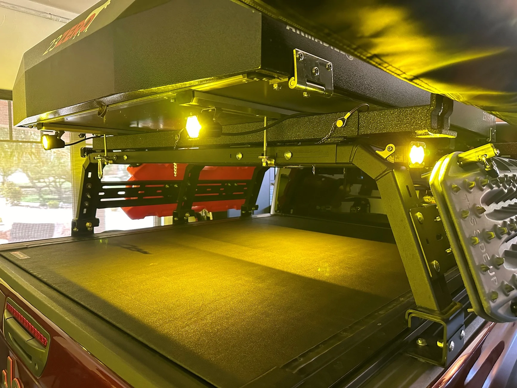

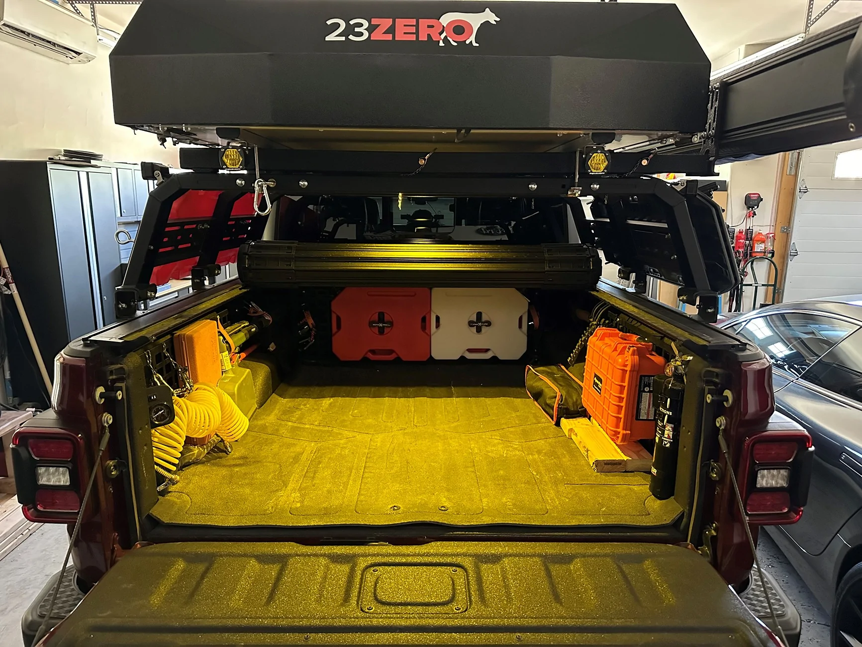

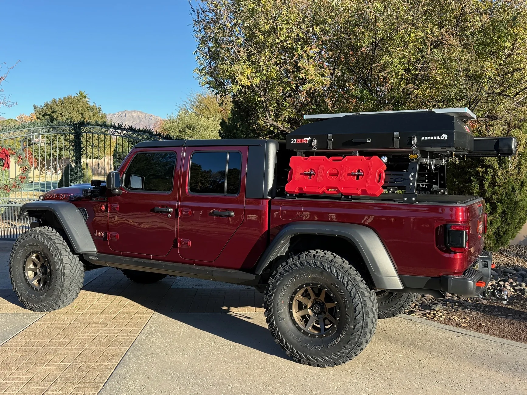

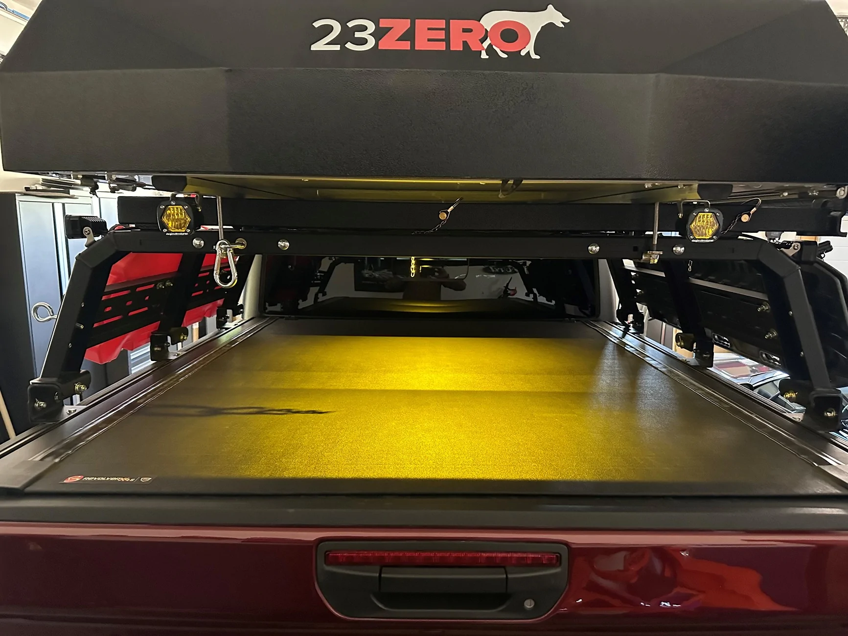

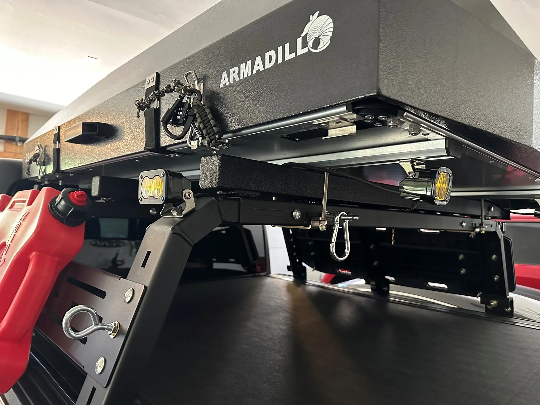

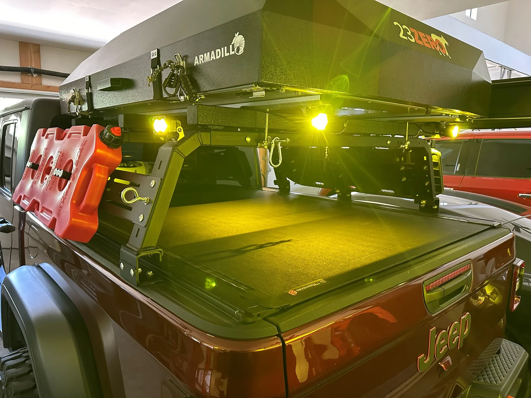

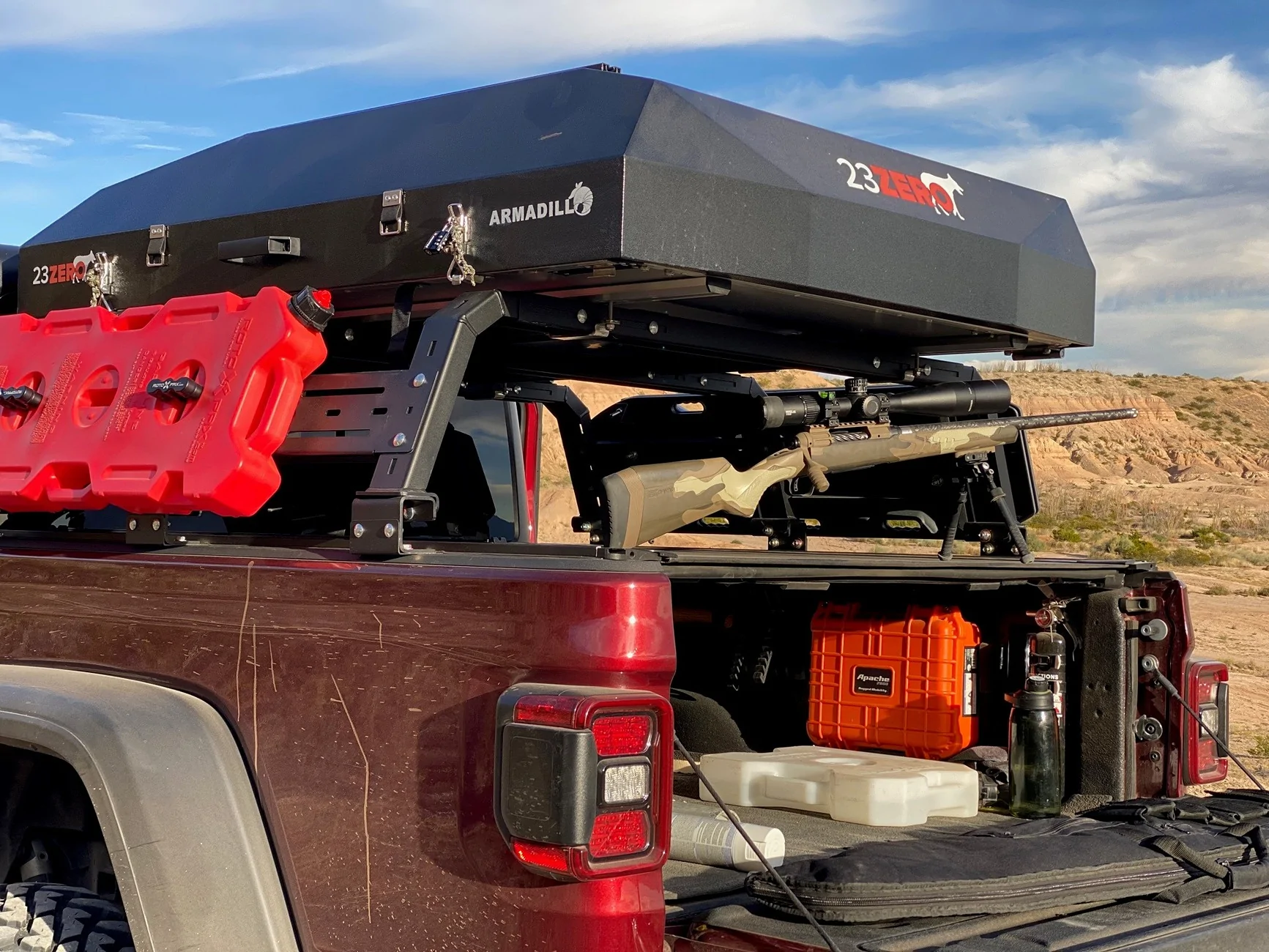

I did the RCI Rack with their Tonneau adapters and the BAK X4S Tonneau and it's a perfect fit. The 23Zero Armadillo is only about 8'' above roofline including the solar panel I have top mounted on the RTT Tracks. Total Height with the 40's is at 88".
My next round of mods are the Artec Trusses welded in Front and Rear and the RCV 300M CV's for the front with a Torq Locker Center. Then add the 2.5 ton steering kit or similar. New Clayton or Deaver 4.5" springs (On 3.5'' with the Clayton Overland Plus 3.5 kit but they are developing a new 4.5 spring). Limiting Straps. Then some sort of rear bumper or tire swing out (Rig'd or JCR or something).
As for on board air, I did the Viair set up where the spare was and put a couple quick connects next to the hitch for hoses. I have everthing switched with a guage inside the bed so it stays clean/covered with the tailgait and Tonneau.

Rig looks great! I'm currently shopping for a Mojave or Mojave X trim to start a build. Is that the 12" or 18" RCI Rack? Sport or HD?
It's the shorter Mid Height Option also incorporating their Tonneau Cover adapter brackets that raise it 3" or so. I'm running the BAK X4S cover and highly recommend for fitment, ease of use, and solid surface with nice texture. I ofter utilize it as an extra shelf when working off the tailgate.
Here's a few more pics to show the rack, bed area, brackets, etc.
Let me know if need anything more specific or more pics. Always happy to help!
Thanks for the info! I've been trying to find something that is the right height to be versatile for my needs (ski/snowboard rack, cargo carrier, fly rod vault etc) but not huge and overbearing. I will probably go this route and will let you know if I have any other questions. Thanks again for the reply.

How is it with the 40’s?
SO MUCH BETTER!
from a practical application standpoint, I haven't had it in as many off-road scenarios as I've had with the 37's but thus far the articulation and clearance has been fine. I am awaiting Lucas and the Team at Clayton Offroad to release their new 4.5" Springs for my 3.5" Overland Plus Kit as the additional clearance would definitely help with the new 40's, especially off-road.
They have been testing their kits on 40's for a bit and haven't released much content nor data as they want to be super certain it'll meet their standards. From what I've gathered, they're making sure brake lines, parts, etc all work in all conditions without any negative outcomes.
From a personal perspective though, the initial stance and presence of the rig on the 40's is absolutely NIGHT AND DAY improved over the 37's. It's really hard to describe but it's absolutely noticeable. I stayed with the 5:13's I had re-geared when I initially built the rig for the 37's and am happy with the overall performance albeit on the underwhelming stock 3.6 pentastar engine. 285 hp and 260 tq should never have been an option for these trucks in my opinion. It's a gutless endeavor even with the 8 speed.
Looks awesome. As for Gears, I have 5:13's with the 40's and it'll still pull 8th gear occassionaly. The stock 3.6 gutless engine needs a Hemi Swap from my perspective but that a whole other convo !
Glad the steering upgrade was positive. Any install notes or mods? Everything bolt up as expected?
