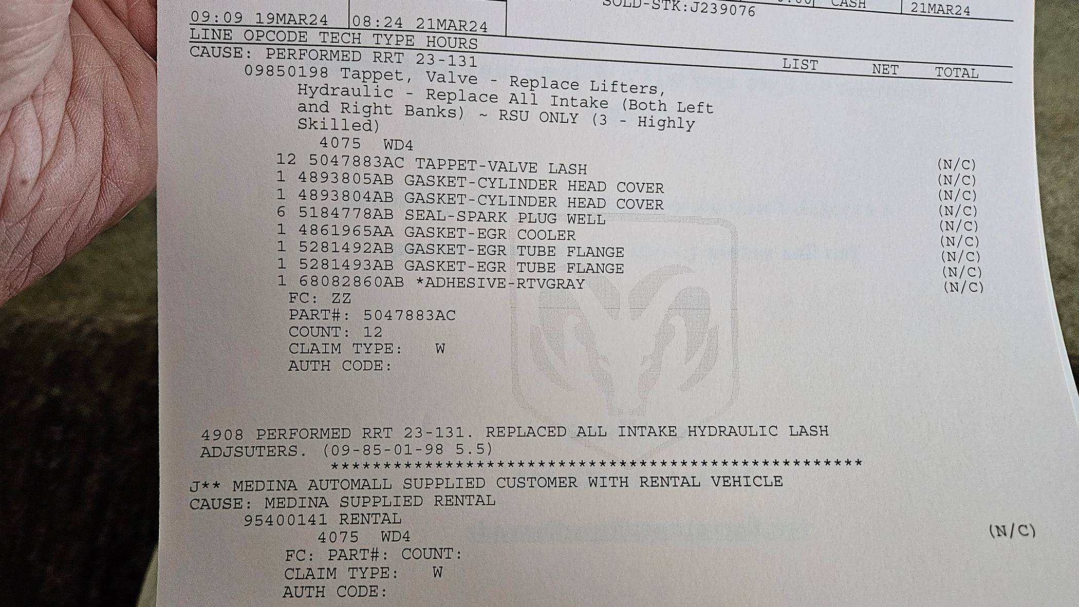

I answered a few weeks ago that it was a good engine. My 2020 gave me zero issues.
Ironically, took my 23 in for it's first oil change this morning, has a little over 4700 miles. I walked next door to have breakfast as I usually do. My service advisor calls before I even have my food...
He says there is a flag on my vin, to replace all 12 lifters?? Said it's about a 7 hr job. Gave me a loaner and sent me on my way. Odd because I thought this one was even quieter then my last one. He was very careful not to call it a recall, said it was an MRA on a very small batch of 23s, but mine was one of them. Anyone heard of this?

I can't decide if I'm happy or sad about it. I guess if Stellantis figured it out I'm glad mine got caught early in its life? Gave me a nice Ram to drive too.
Once I have the paperwork when I pick it up I'll post a shot of it.

Happen to know what "MRA" means? Have not heard that acronym before.

Not a clue, and I might have misheard him over the phone. Didn't say recall, and it sure didn't sound like "TSB" either. Whatever it is I'll post the paperwork when I have it. Hopefully tomorrow if things go well.

Poked around and found the attached document. Page 3 and 4 talk about "MRA-Material Return Authorization". Seems to be the system the dealers use for processing warranty reimbursement to them from FCA.

Huh, that must be it. Good find! Can't wait to see what the paperwork says, hopefully that will shed more light on it.

Day later then promised, just got my truck back. Here's the paperwork if it's helpful to anyone. The service advisor said it only applied to a select few trucks? Hopefully this means my cams will live a long healthy life.
Jeep Gladiator 3.6 Penstar Poll! 20240321_171407
Huh, intresting. Mine came back fine. They did do an alignment and it isn't actually aligned lol
