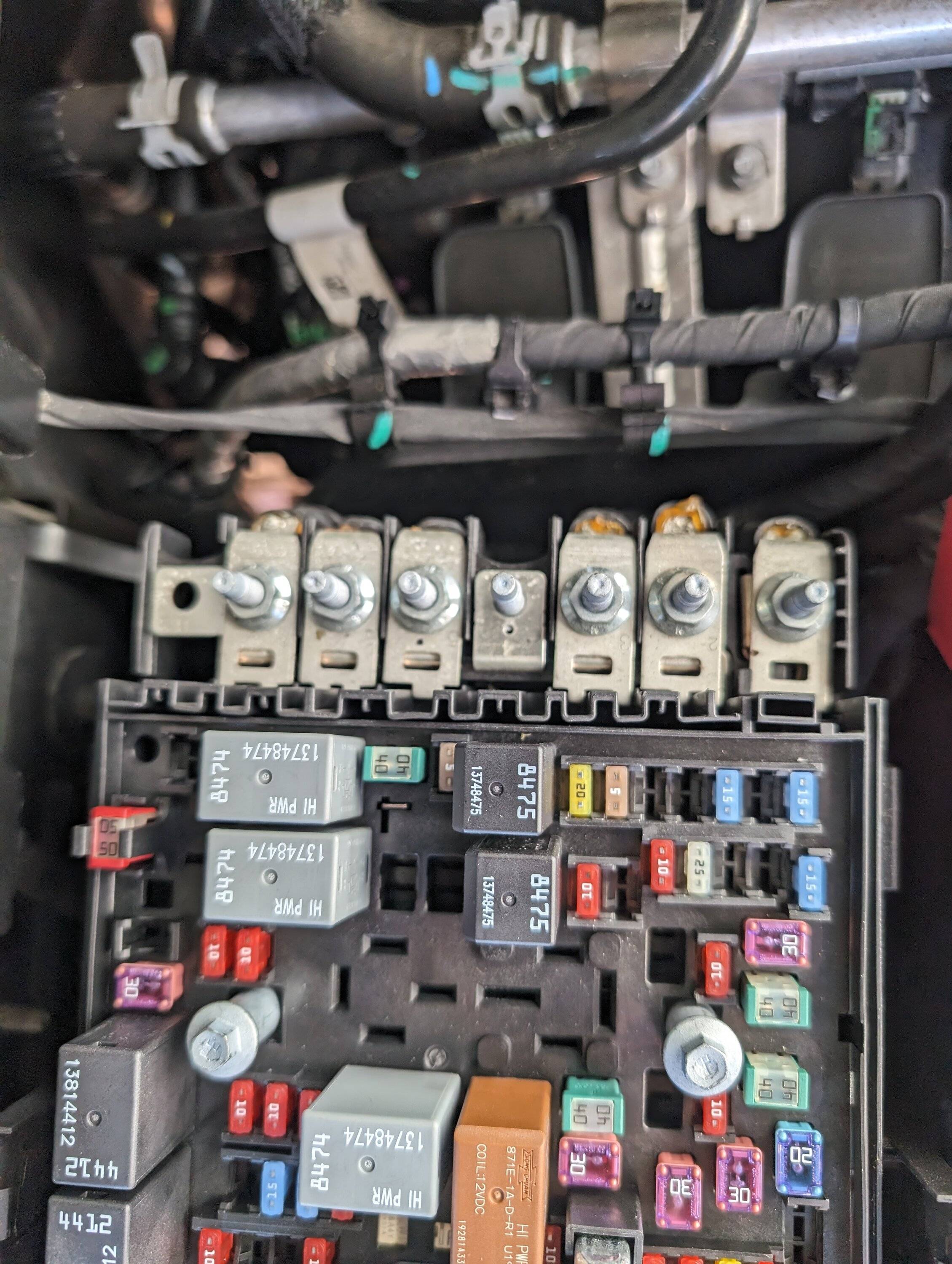

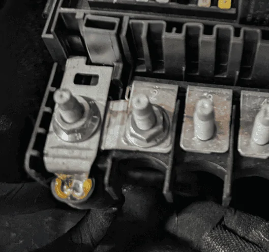

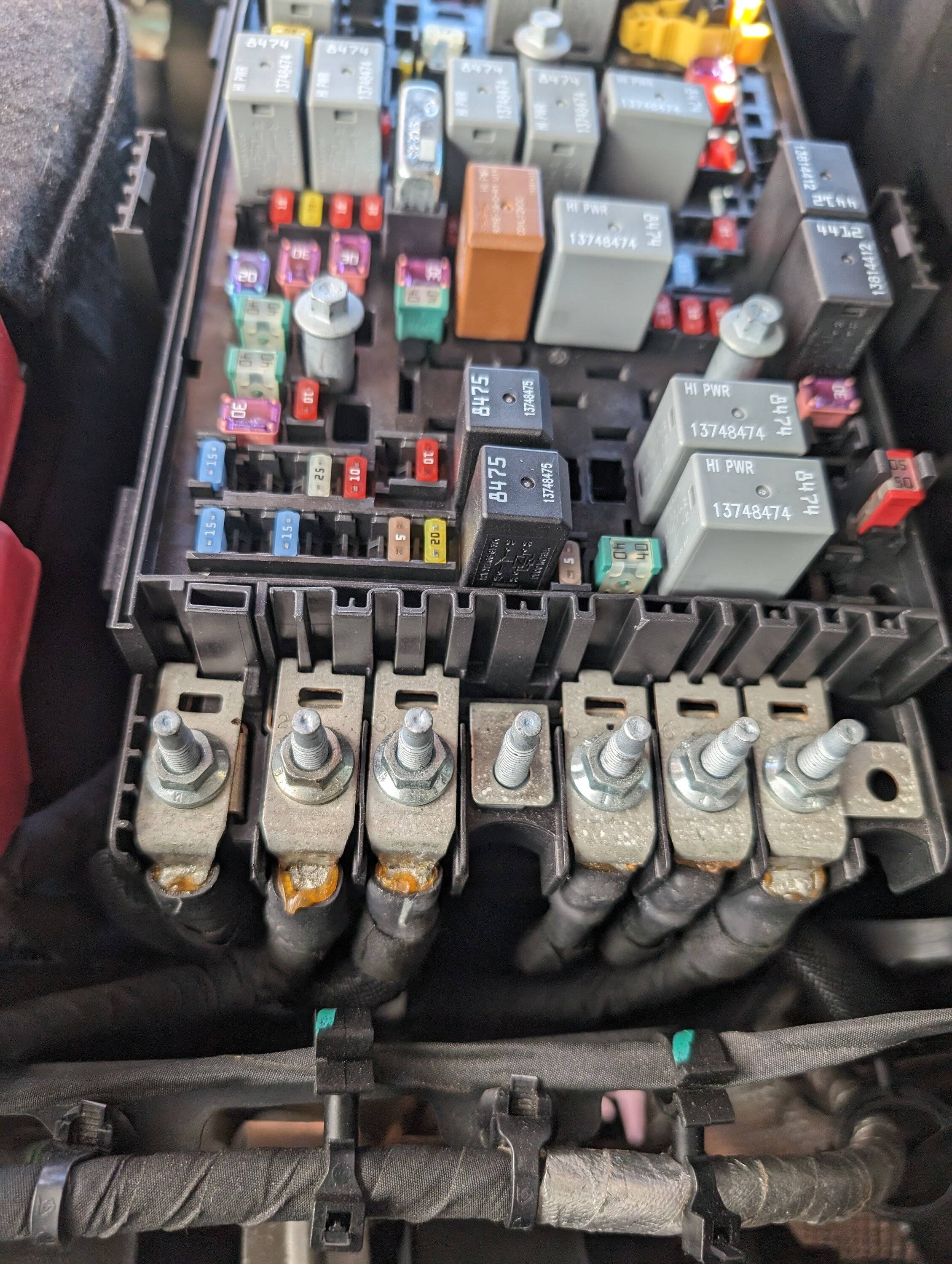

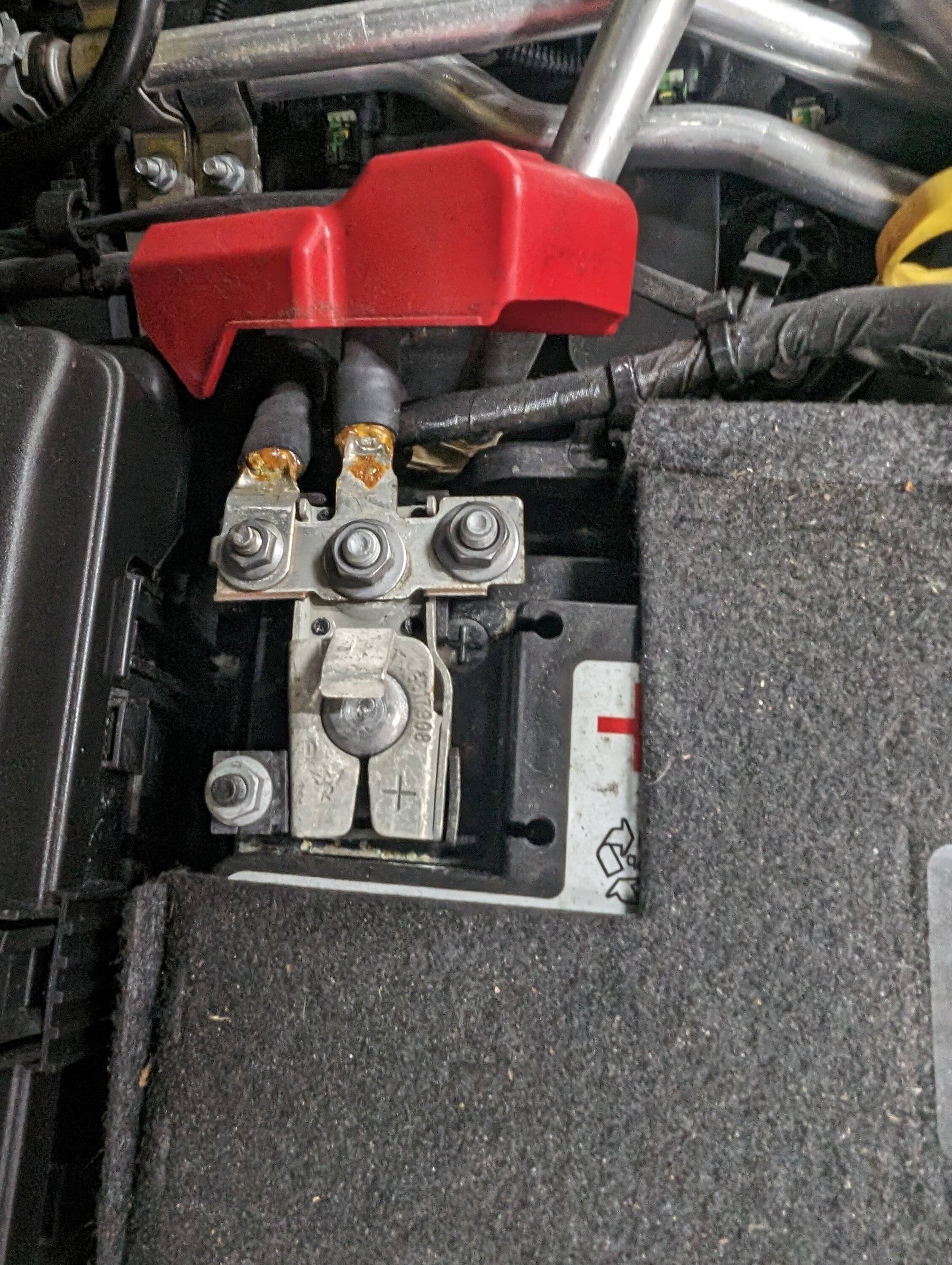

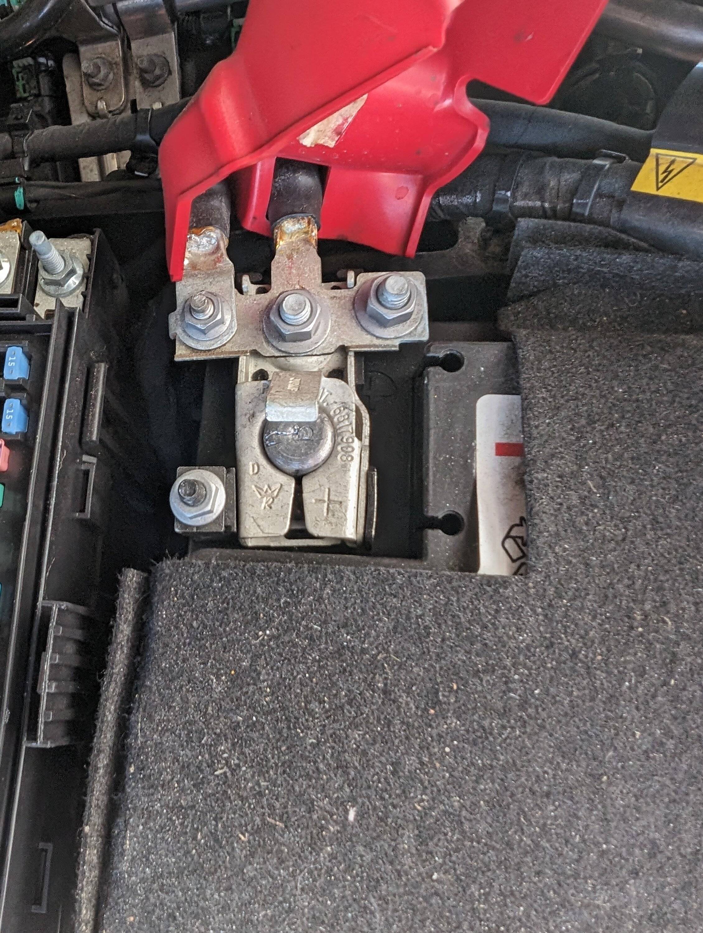

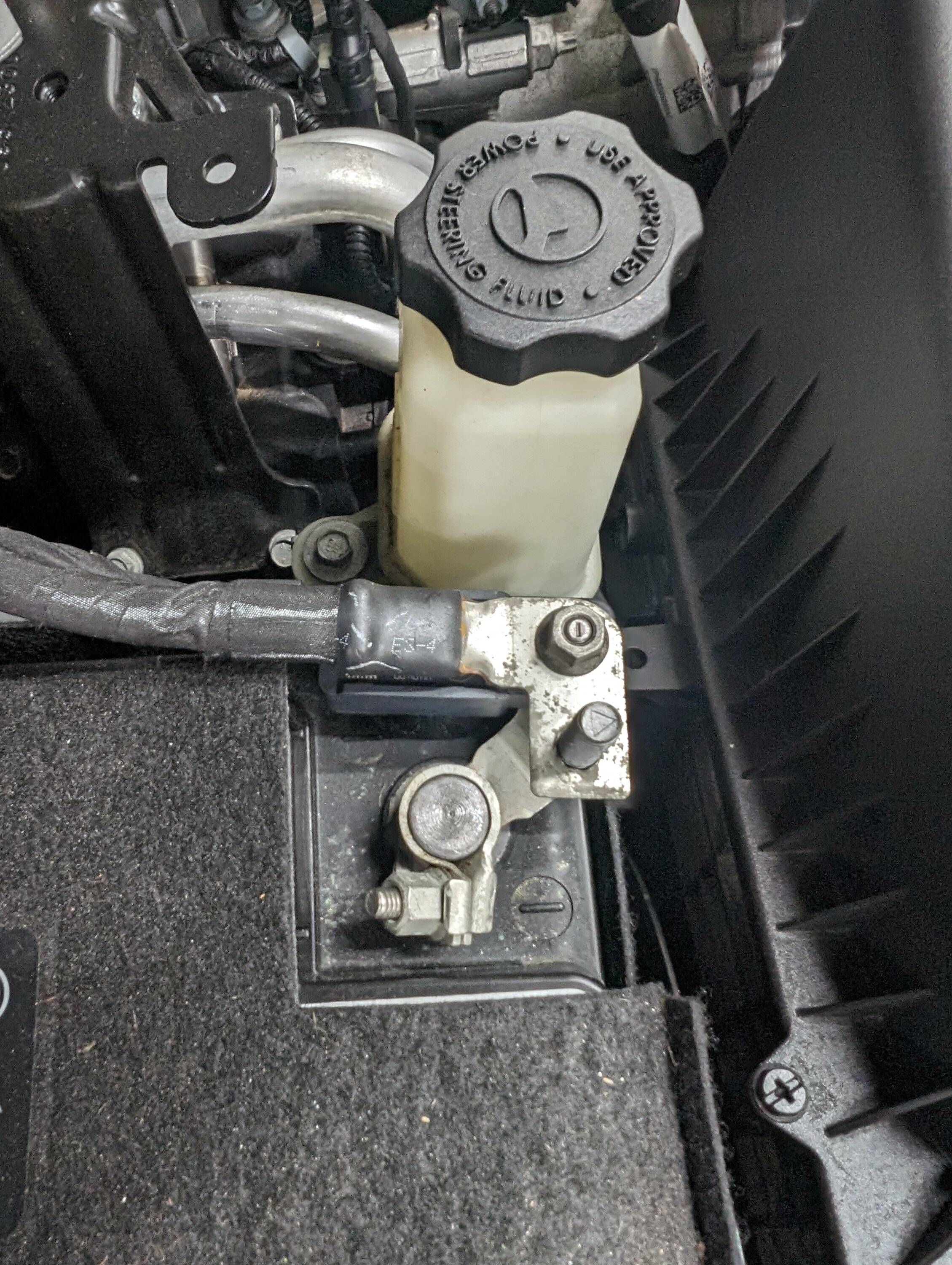

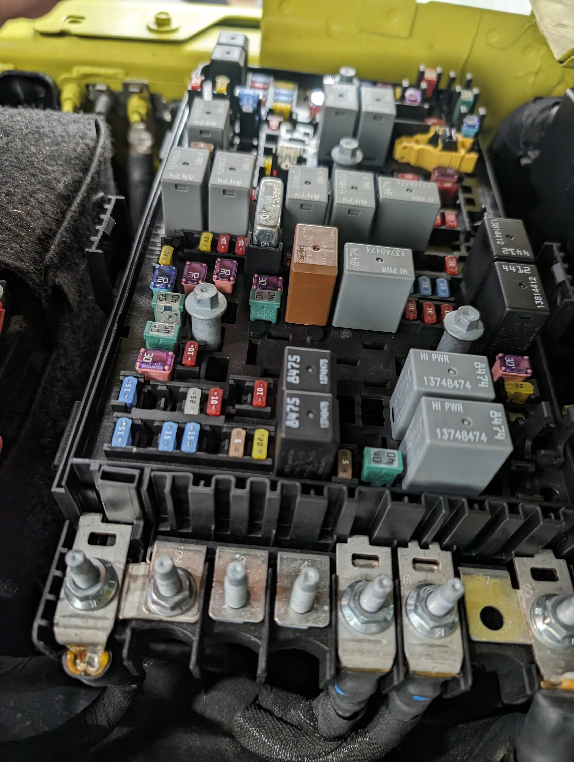

Here are pictures of my Wife's 2022 JLU with eTorque fuse box and battery terminals. I have to look at mine now. Her's has the same towing package as mine..
Jeep Gladiator 3.6L ESS Battery Cable Diagram PXL_20240303_173748067
Jeep Gladiator 3.6L ESS Battery Cable Diagram PXL_20240303_173753577
Jeep Gladiator 3.6L ESS Battery Cable Diagram PXL_20240303_173757305
Jeep Gladiator 3.6L ESS Battery Cable Diagram PXL_20240303_173827840
Jeep Gladiator 3.6L ESS Battery Cable Diagram PXL_20240303_173830858

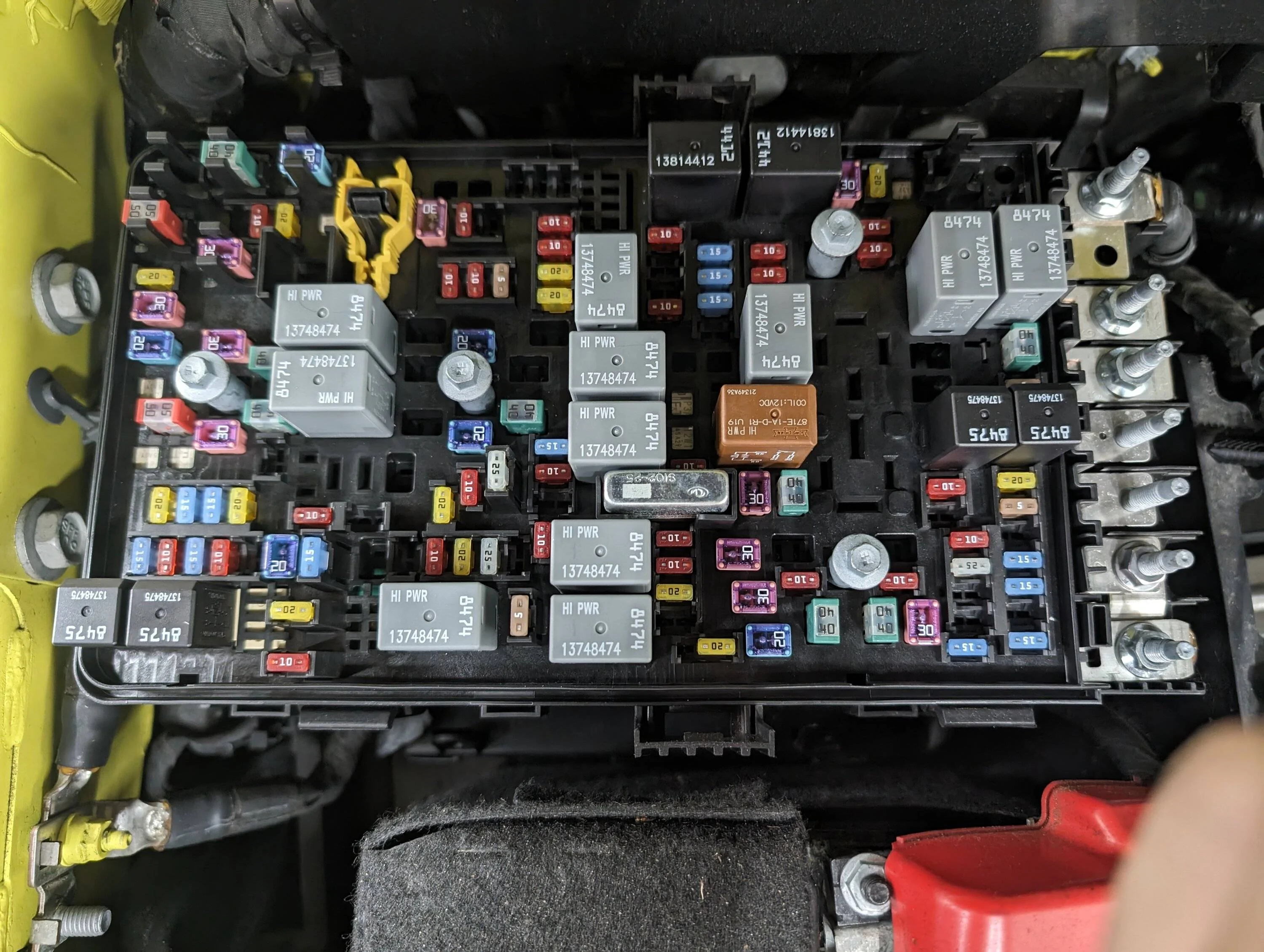

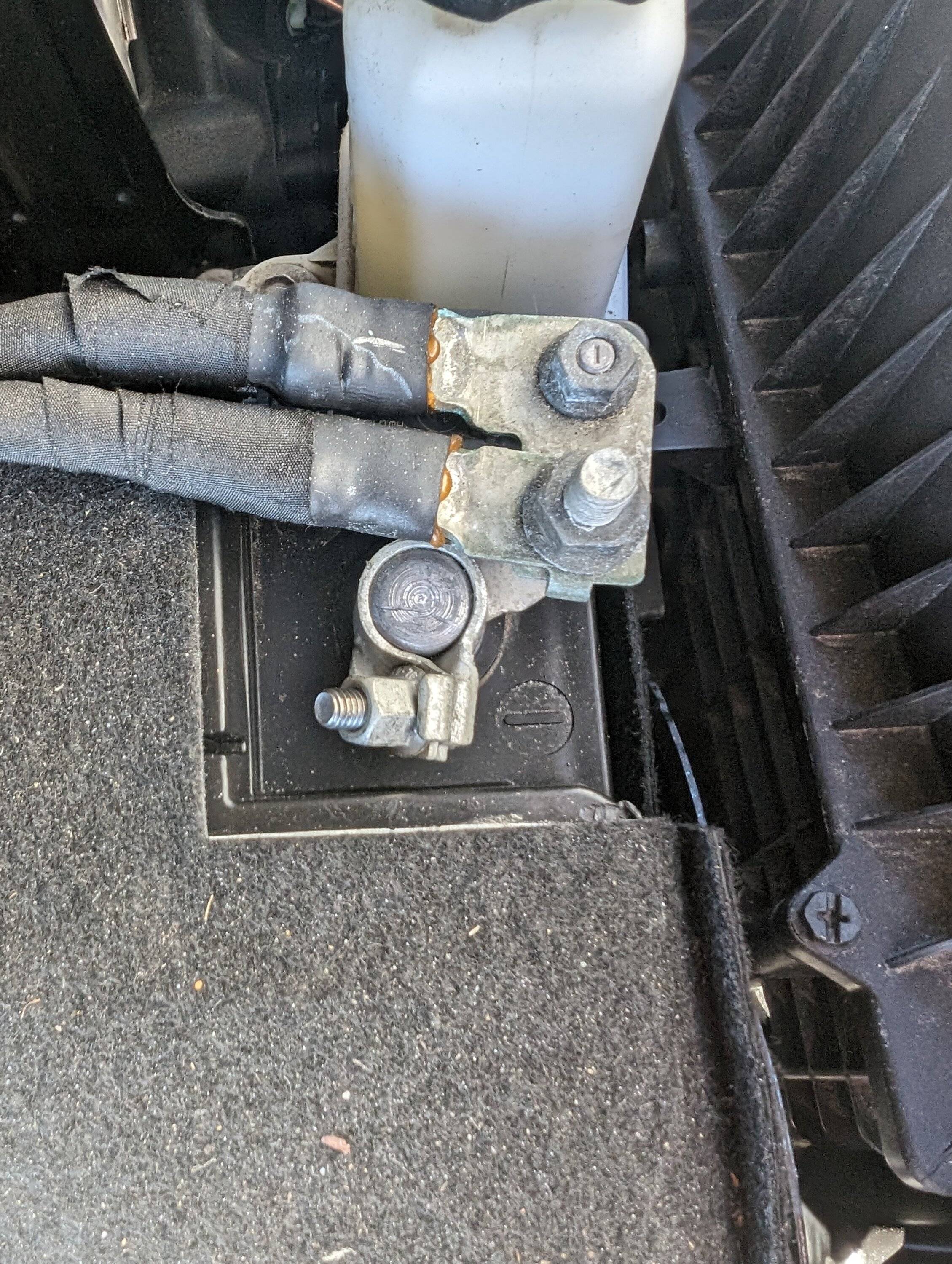

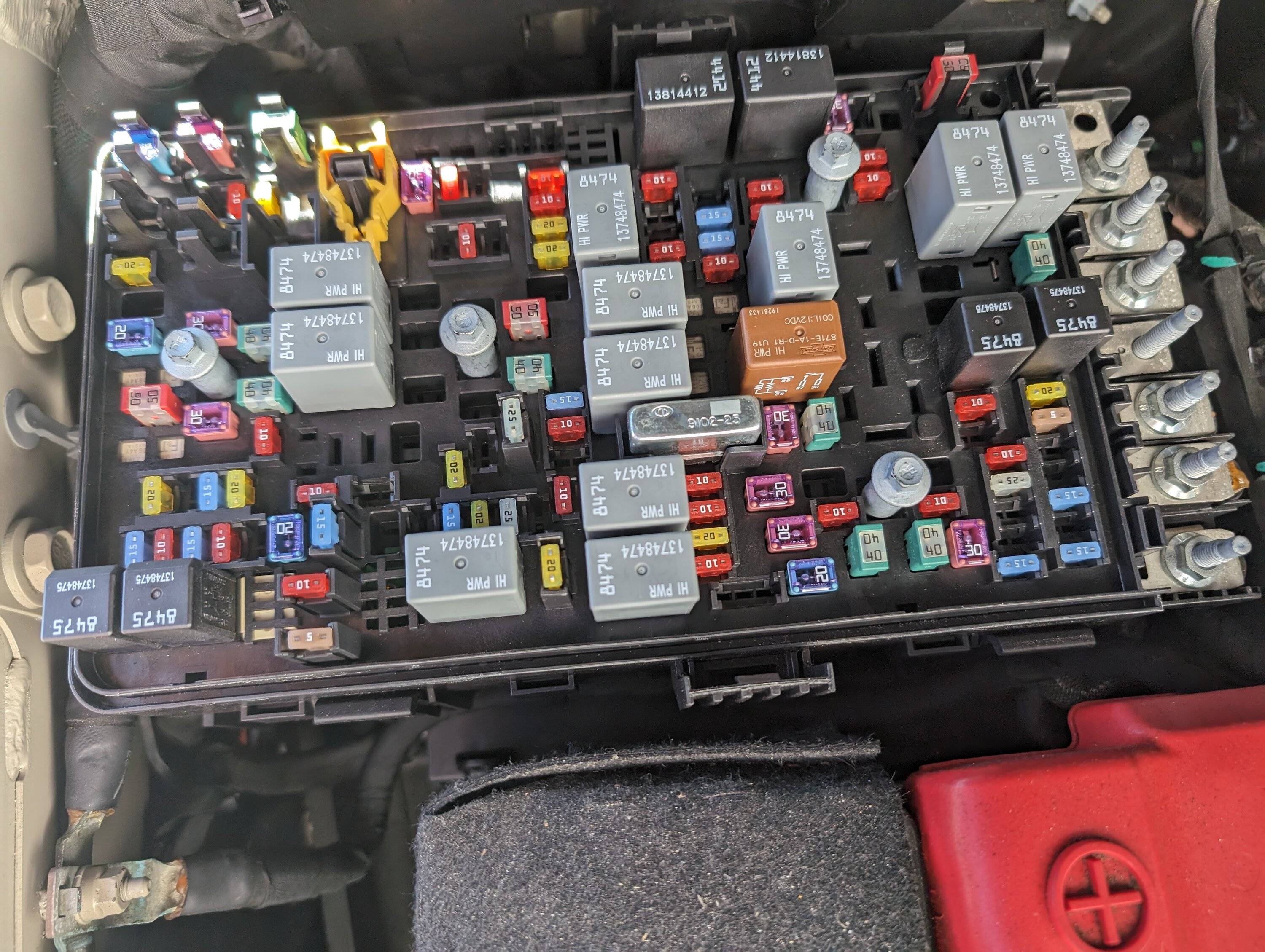

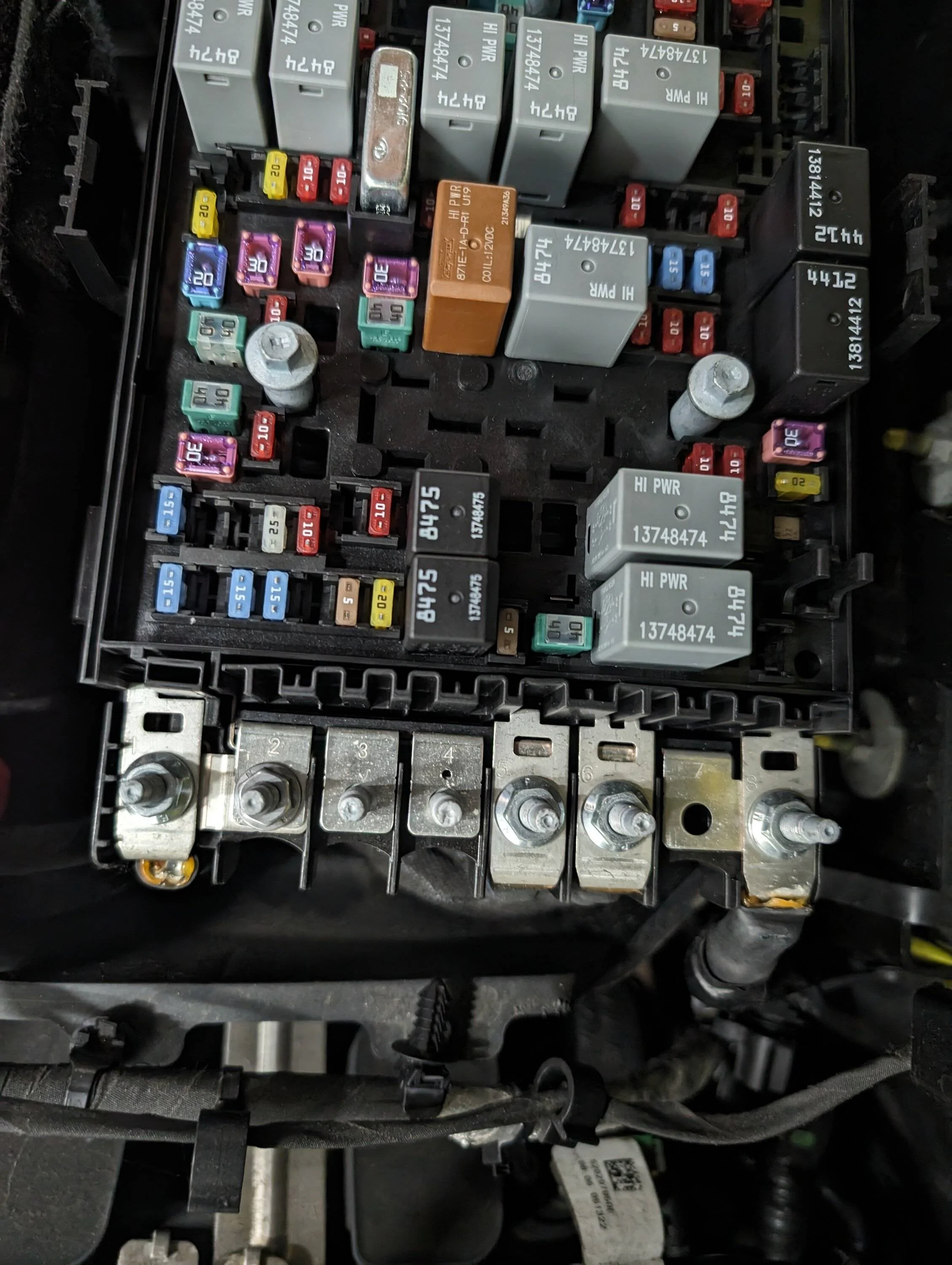

And these pictures are from my 2020 Mojave ..
Jeep Gladiator 3.6L ESS Battery Cable Diagram PXL_20240303_174916189
Jeep Gladiator 3.6L ESS Battery Cable Diagram PXL_20240303_174912409
Jeep Gladiator 3.6L ESS Battery Cable Diagram PXL_20240303_174906487
Jeep Gladiator 3.6L ESS Battery Cable Diagram PXL_20240303_174903219
Jeep Gladiator 3.6L ESS Battery Cable Diagram PXL_20240303_174900493

NO...NO...NO, do not swap N-3 to N-2, and put an unfused jumper between N1-N2.!! N-2 is battery power to the bus, N-3 is the fuse to the electronics. doing what you suggest is tying the electronics to the bus unfused. The simplest way to clean it up if wanting to remove the wiring is an unfused jumper between N-3 and N-1, as the fuse of N-3 protects the electronics on N-1. N-1 is not a terminal on the bus but outgoing to the electronics. Changing out a fuse block sounds simple , but it is really a lot more to it then just putting a jumper in between two terminals, you have six wires her car has four and a solid jumper between N-1 and N-3 , but are the fuse blocks the same, if not that could get real expensive....Jack

Am I looking at the picture wrong? To me it appears here Jeep has a solid jumper from N1 to N2
40,517
54,071
Etorque and probably 4xe would jumper that - I think this is what you are looking at -
Jeep Gladiator 3.6L ESS Battery Cable Diagram 1709499545219
Found it, yeah, 4xe has that jumped as well - here's from ours and the fuse area looks similar to yours -
Jeep Gladiator 3.6L ESS Battery Cable Diagram 1709499636902
I never noticed that before.
Yes that is what I am talking about.
