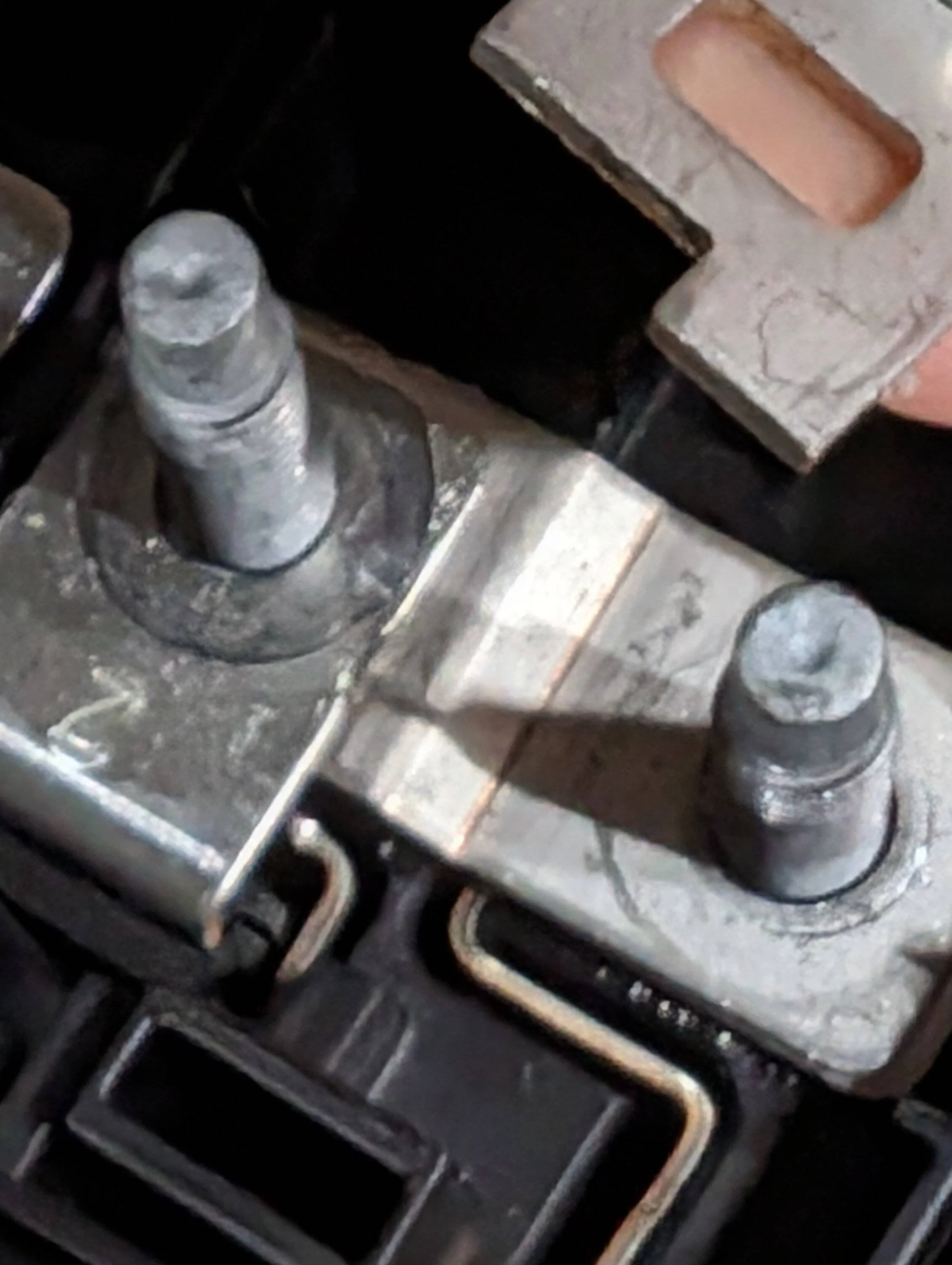

Unfortunately the N2 part of the jumper is under the fuses, so not easy to take off. The oart under the N1 on top doesn't have a part number that I can see.

If I can buy that factory jumper strap separately, then no need to buy the whole z case fuse block. If I can't and the only way to get it is to buy the whole z case fuse block, so be it, I will buy it and have an extra z case fuse block for my Jeeps.
My plan is to hopefully get the original N1 to N2 strap if someone can help me find the part number, because I can't find it. Move the direct battery cable to N1 and install the N1 to N2 jumper. Remove all the extra wires battery wires. Unplug and remove the PCR. I am also installing the Genesis battery relocation tray at the same time, mostly because I think it is a cleaner design.
Only thing now is the N1 to N2 strap, so if anyone is good looking at those diagrams online and can help, it would be really helpful. I am really bad at finding that stuff on line. I spent a few hours so far and can't find it...

Update on this piece. Benny did some digging and this connector bar is only available with the PDC. So for $250, I am going to skip it and buy the other cable I was talking about.
I also found a Z cage fuse array listed in the diagrams that was only $20. I am going to buy that with my next order because I have an idea I want to test out.

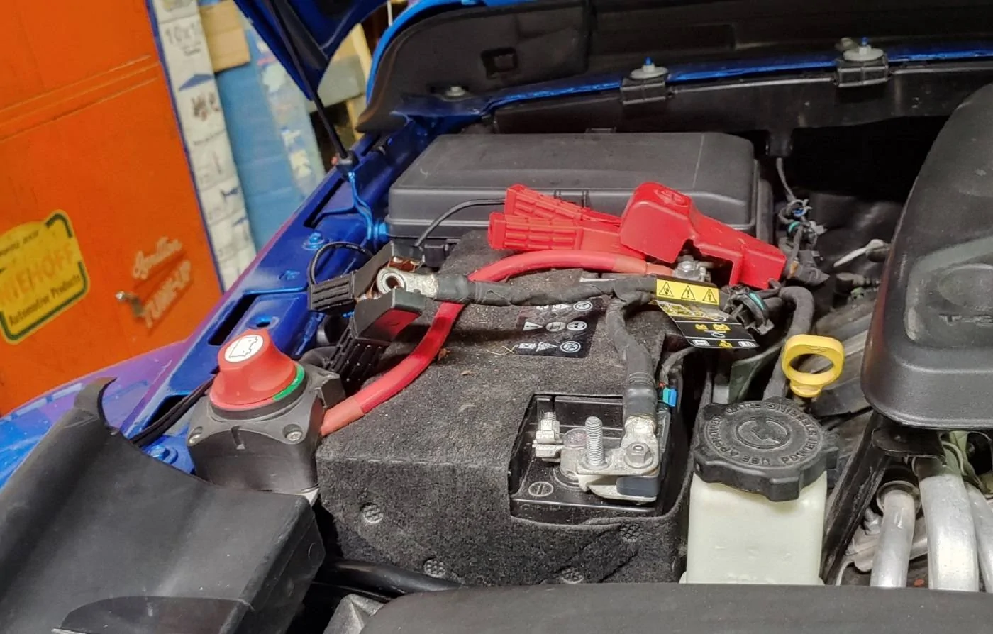

The cable marked 2020 is the ground for the aux battery in 2020 model year, and the cable marked 2021+ is the aux cable ground for 2021 and later.
None of the videos I saw mention the difference between 2020 and 2021+ models for which connection to remove. They all showed the 2021+ connector. I figured my aux battery was dying since the ESS light came on and in the past that's been my experience, even though this battery is less than 2 years old. I tried this yesterday and everything went blank and pulled the wrong connection and everything went black. I put it back and viola! it all worked again. and the ESS light went off the cluster and hasn't come back on. Not sure what happened, but maybe it wasn't the Aux battery after all.

The ESS error light (what some call the "Avengers" light - although I have no frame of reference to know what that even means), the A surrounded by a semi-circle and exclamation point, can come on for a multitude of reasons. Can be a battery problem (either battery, actually), or any of several other things.
If you have a good AGM charger and the time to deal with it - you can charge each battery independently while leaving the IBS disconnected and off to the side. That will force it to reset and start over determining battery health for the crank battery and let the aux battery start with a full charge - to see if it's going to hold that or gradually diminish again.
You may have reset a problem code?! in your processes.

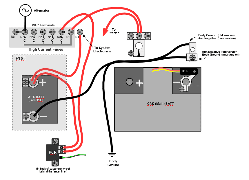

I've noticed there's not as much ESS battery information here as on the Wrangler forum. So here's my diagram of the ESS battery cabling, based on the JL, but I'm pretty sure the JT is the same.
Edit 1/22/2022 - updated diagram
There's more information here https://www.jlwranglerforums.com/forum/threads/3-6l-ess-dual-battery-consolidated-information.25377/

You need to take the two cables off the top of the IBS and take the two apart.
To make sure you have both batteries "ungrounded" you remove the pair from the top of the IBS, and then take those two apart from each other and keep them from touching ground.
To be safe - assume both should not touch ground or anything else when disconnected from each other then you don't have to worry about which is the aux ground and which grounds the main to the chassis.
