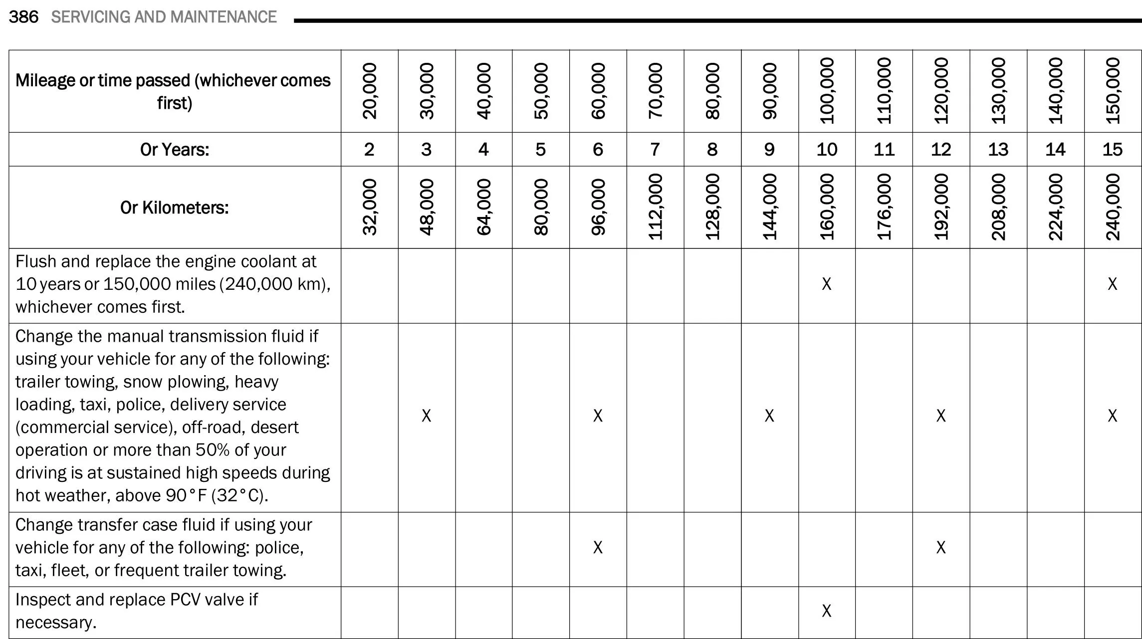

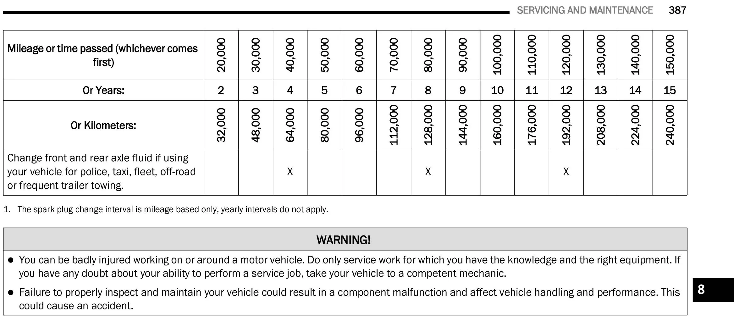

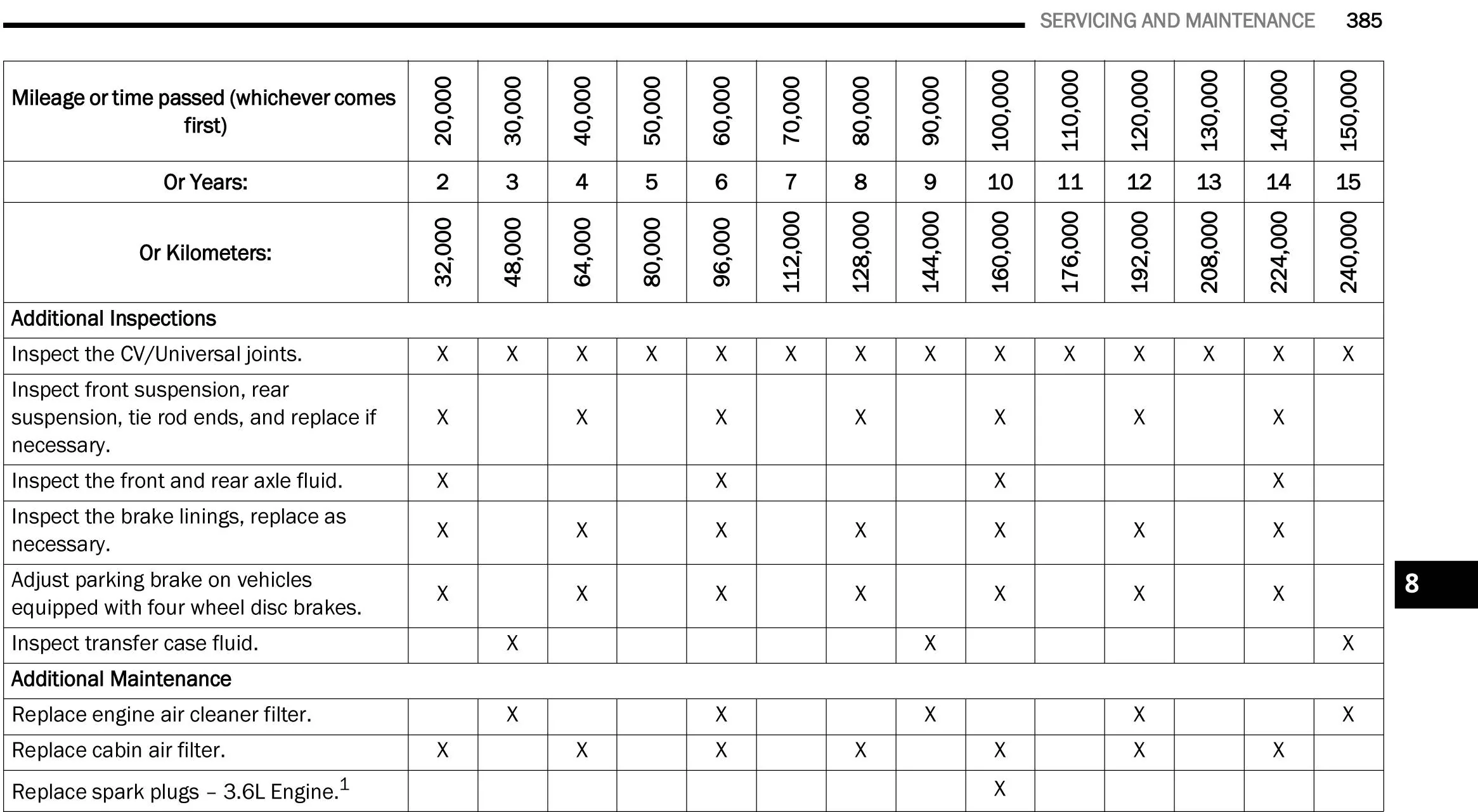

30k for me with a background as a tech.
1) trans service.....fluid and filter
2) front/rear diffs
3) transfer case fluid
4) oil change (based off from the 5k schedule
5) brake fluid flush.....I normally do it every 30k or 24 months. Remember brake fluid retains water
2, 3 and 4 can be done at home super easy. 1 and 5 Don't require special tools, but the kno

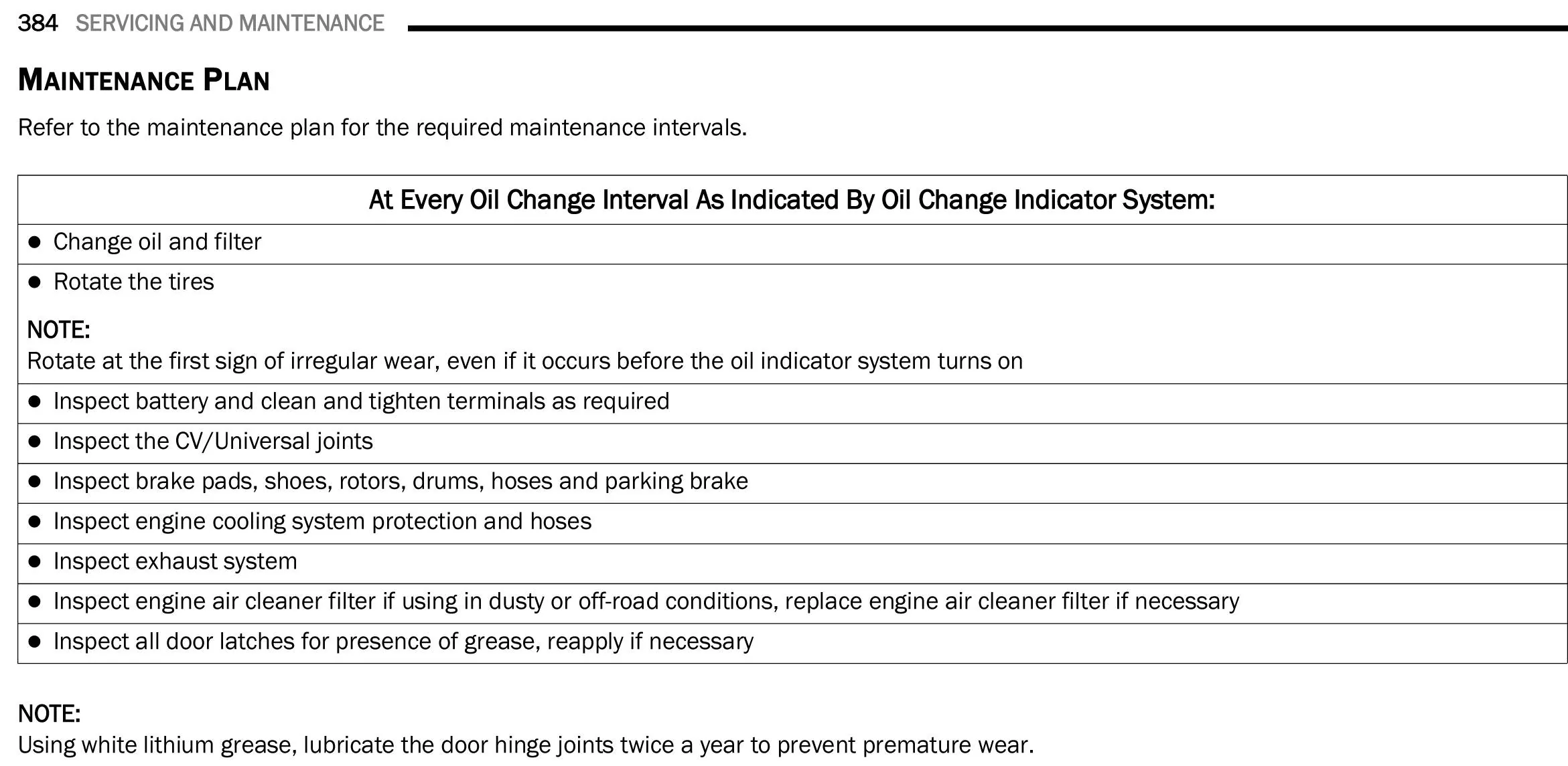

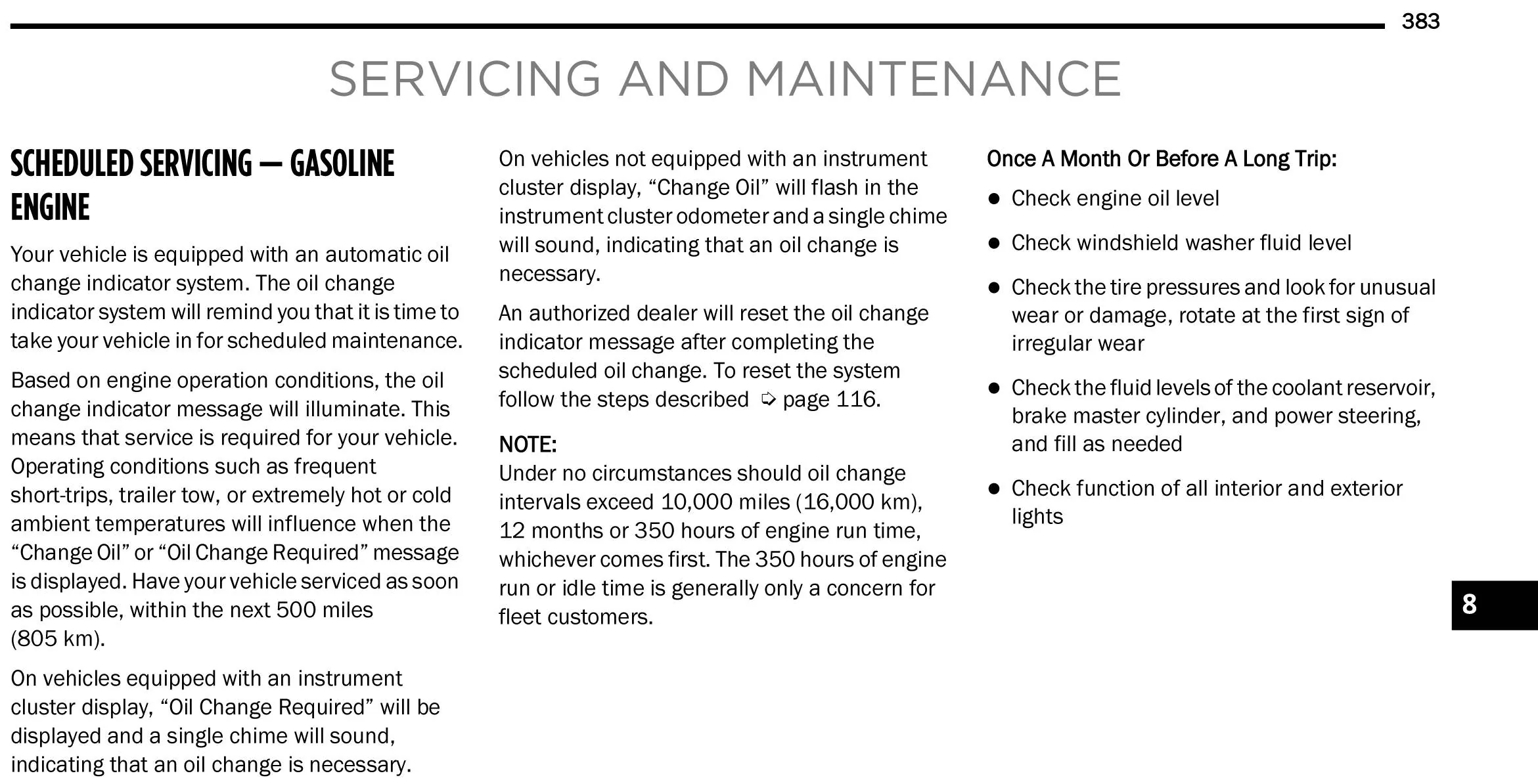

Searching the web (because I'm too damn lazy to check the owner's manual), I found that according to KBB, Jeep recommends the following at 32000 miles:
  • Rotate tires
  • Inspect all door latches for presence of grease, reapply if necessary
  • Inspect battery and clean and tighten terminals as required
  • Inspect brake pads, shoes, rotors, drums, hoses and parking brake
  • Inspect engine air cleaner filter, replace if necessary
  • Inspect engine cooling system protection and hoses
  • Inspect exhaust system
I was just about to mention that you should do the stuff Jeep recommends and anything else that makes sense to you.
