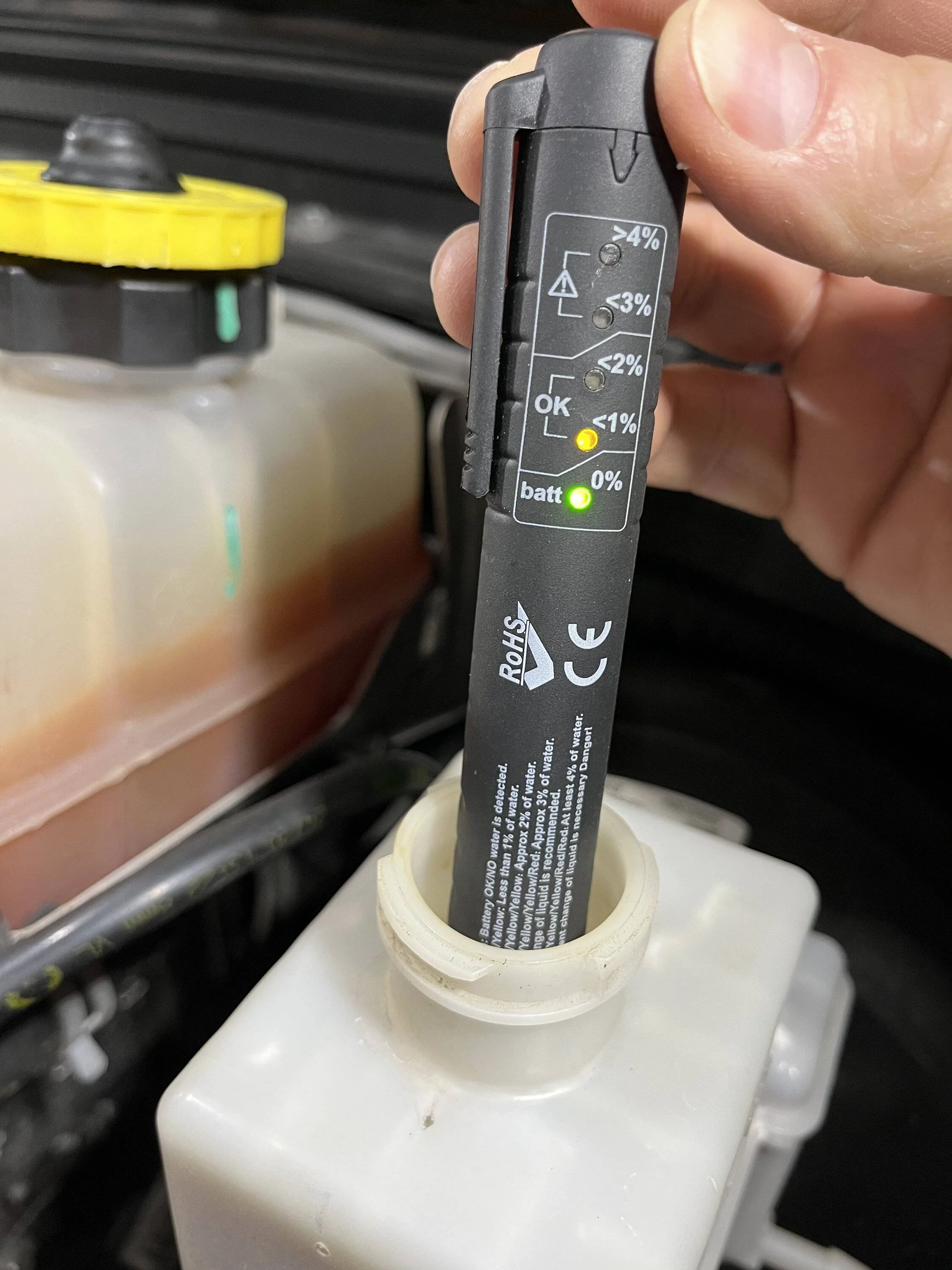

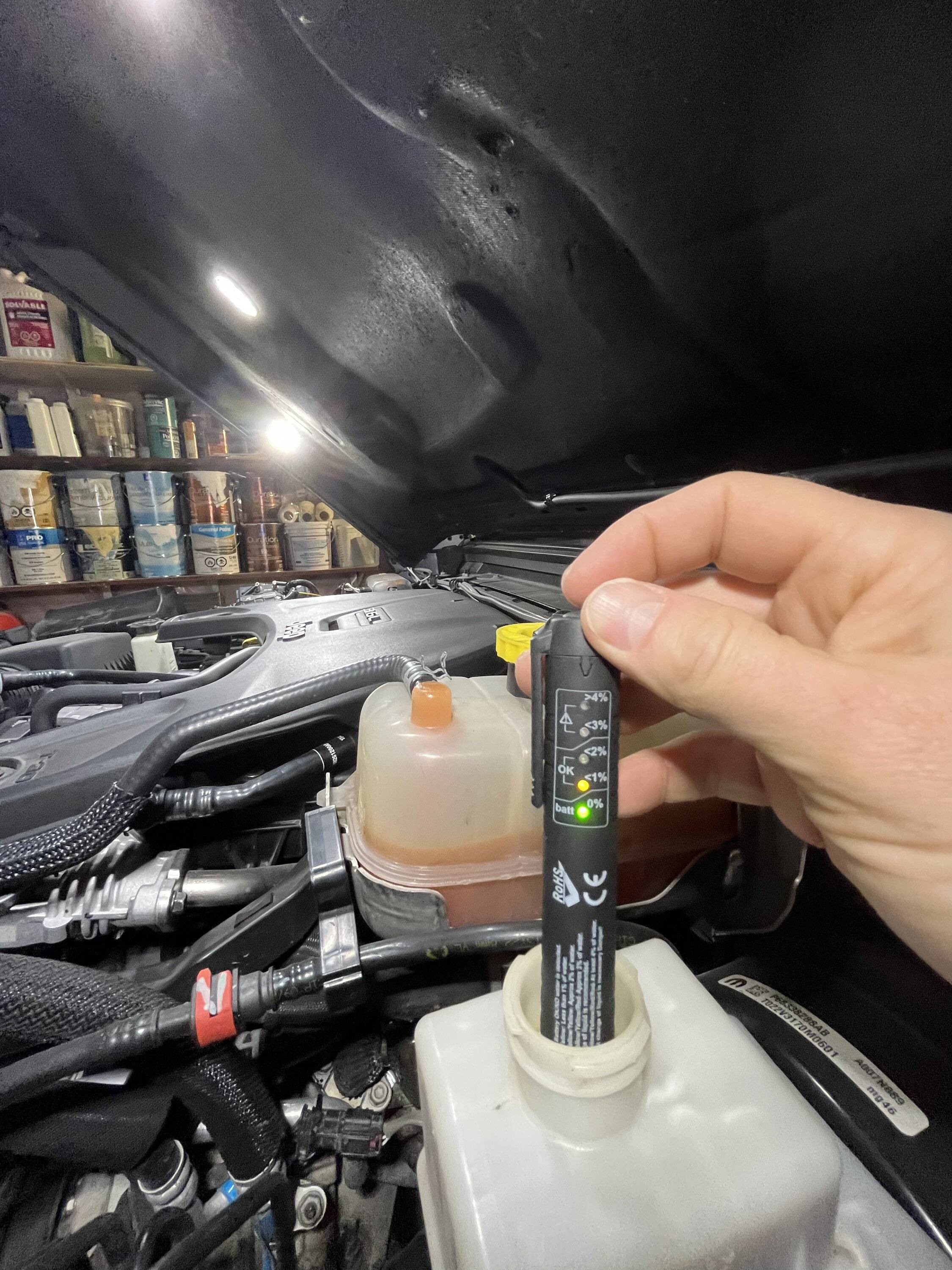

As far as the brake flush goes, go to your local auto store and pick up one of these gizmos that reads the moisture content in the fluid. Let it tell you when the flush is needed.

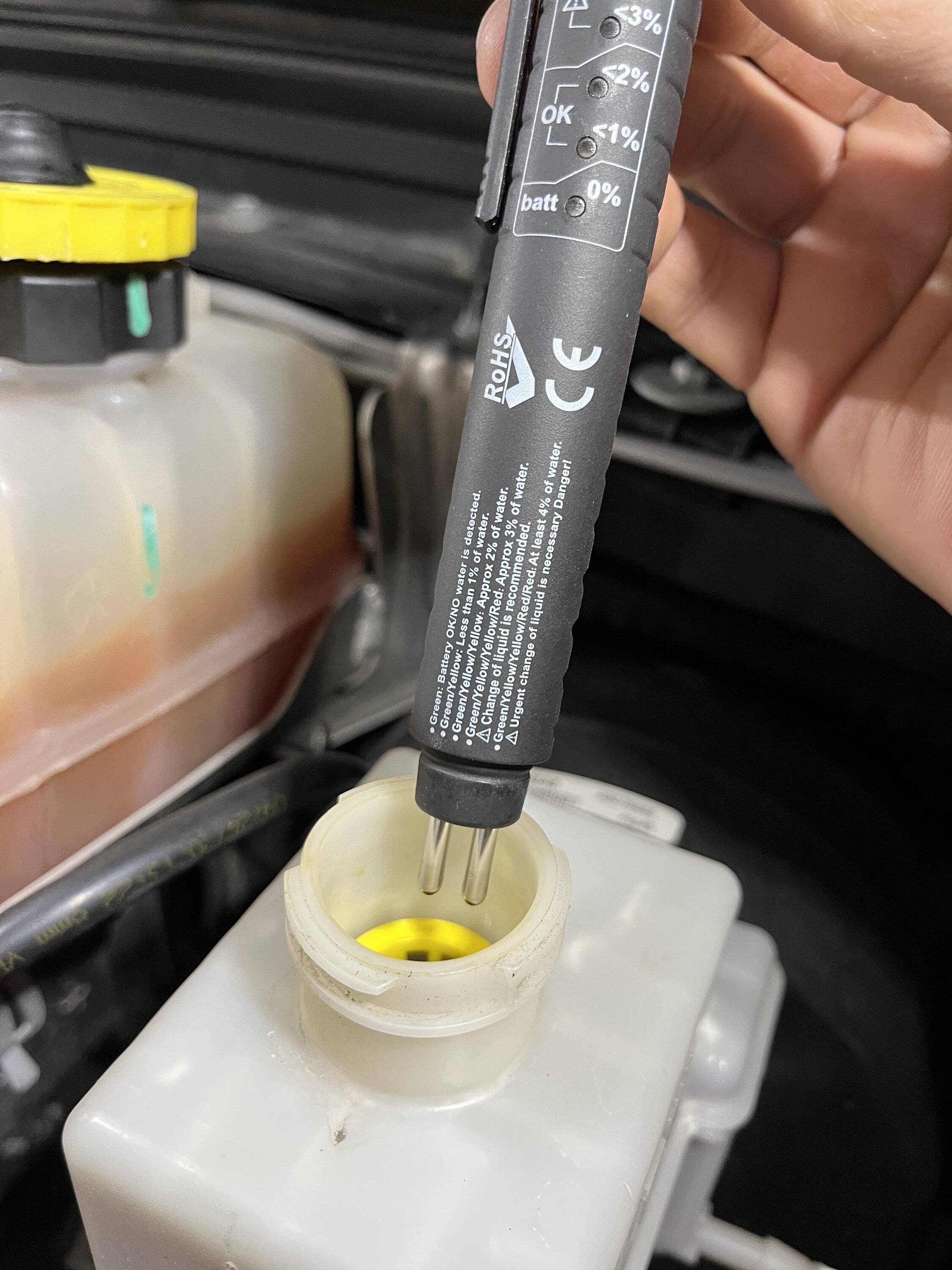

I actually went out to do some pics for you when I read this thread but when I went to use the tool on the brake fluid, there’s a screen just under the lid and the fluid has dropped just under the screen so the tool probes can’t touch the fluid to do the test. ? So I’m off to get some DOT 3 Fluid and top it up to the max line and after a while, I’ll check the condition of the fluid with the brake fluid tester.
Don’t assume! Get tests done, do your own stuff, have the right tools to check stuff like this and you’ll never be at the mercy of guesses, opinions and pressure tactics.
So following what I posted above, and topping up the reservoir just enough to be above the screen so my “brake fluid moisture tester” could test, …I gave the added oil some time to mix and here is what my tester says about the moisture in my brake fluid.
(53000k kms - 33k miles)
Mine is still good.

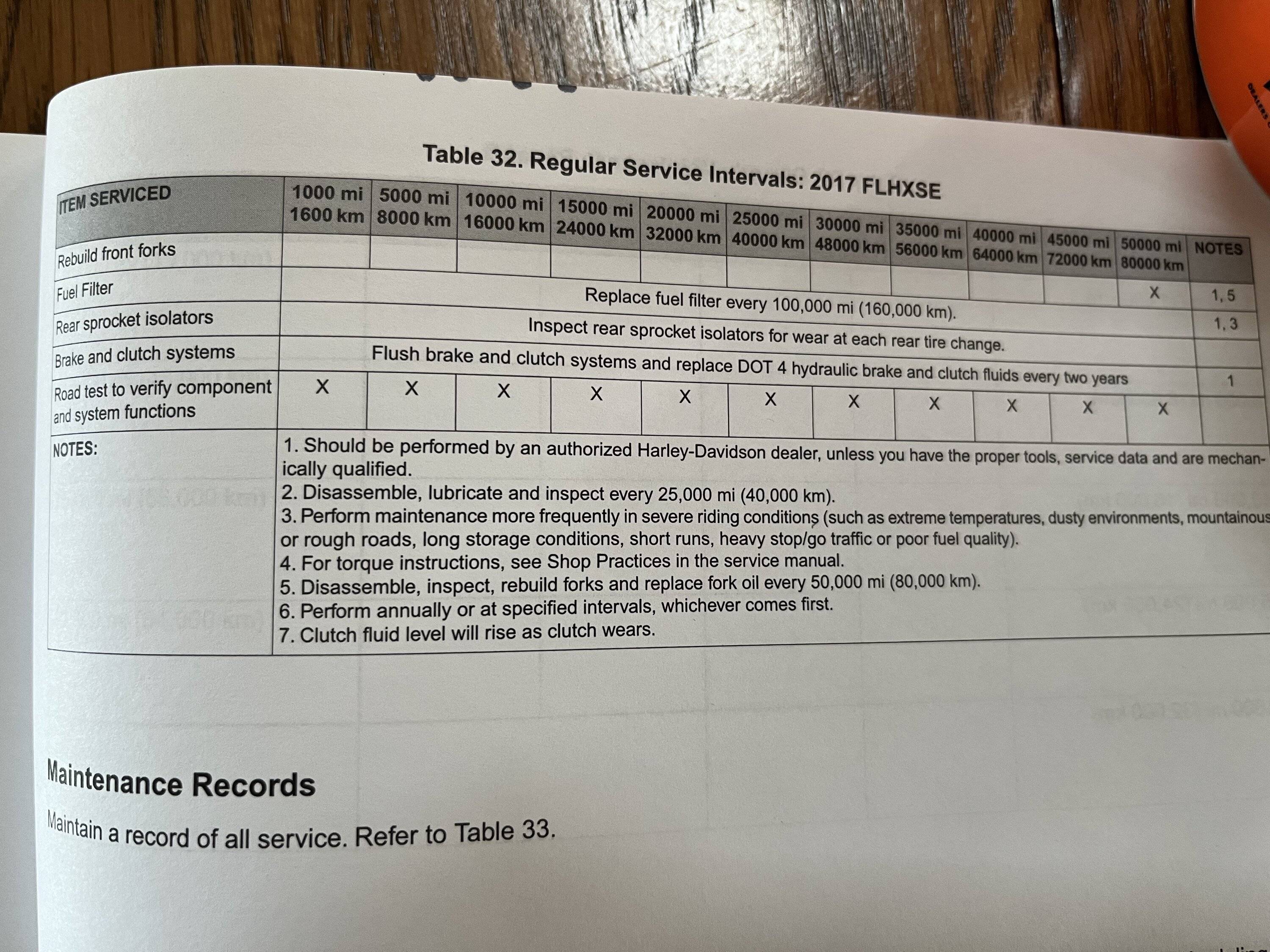

As a trained Harley mechanic [MMI 2017-2018] we're taught to always flush the clutch and brake systems every two years. It wasn't that way before but it definitely is now. This is out of the Owners Manual of my 2017 CVO Street Glide

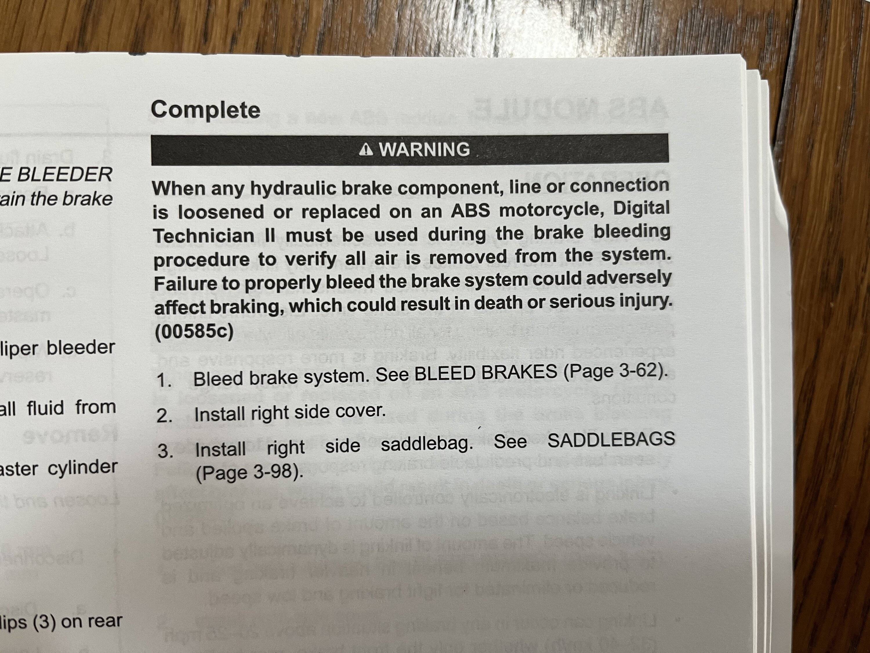

And this is out of my service manual for the same bike. I can flush and bleed the brakes on any bike that doesn't have Antilock Brakes---but because I'm no longer working as an HD Tech I have to pay to get the brakes done every two years because only HD dealerships have DigitalTech2.
Do I very much suspect that the system can safely go longer? Yes, but when it comes to having a really great ABS System with all possible advantages then I'm definitely spending the coin to have this critical service done as I'm not giving up riding.
