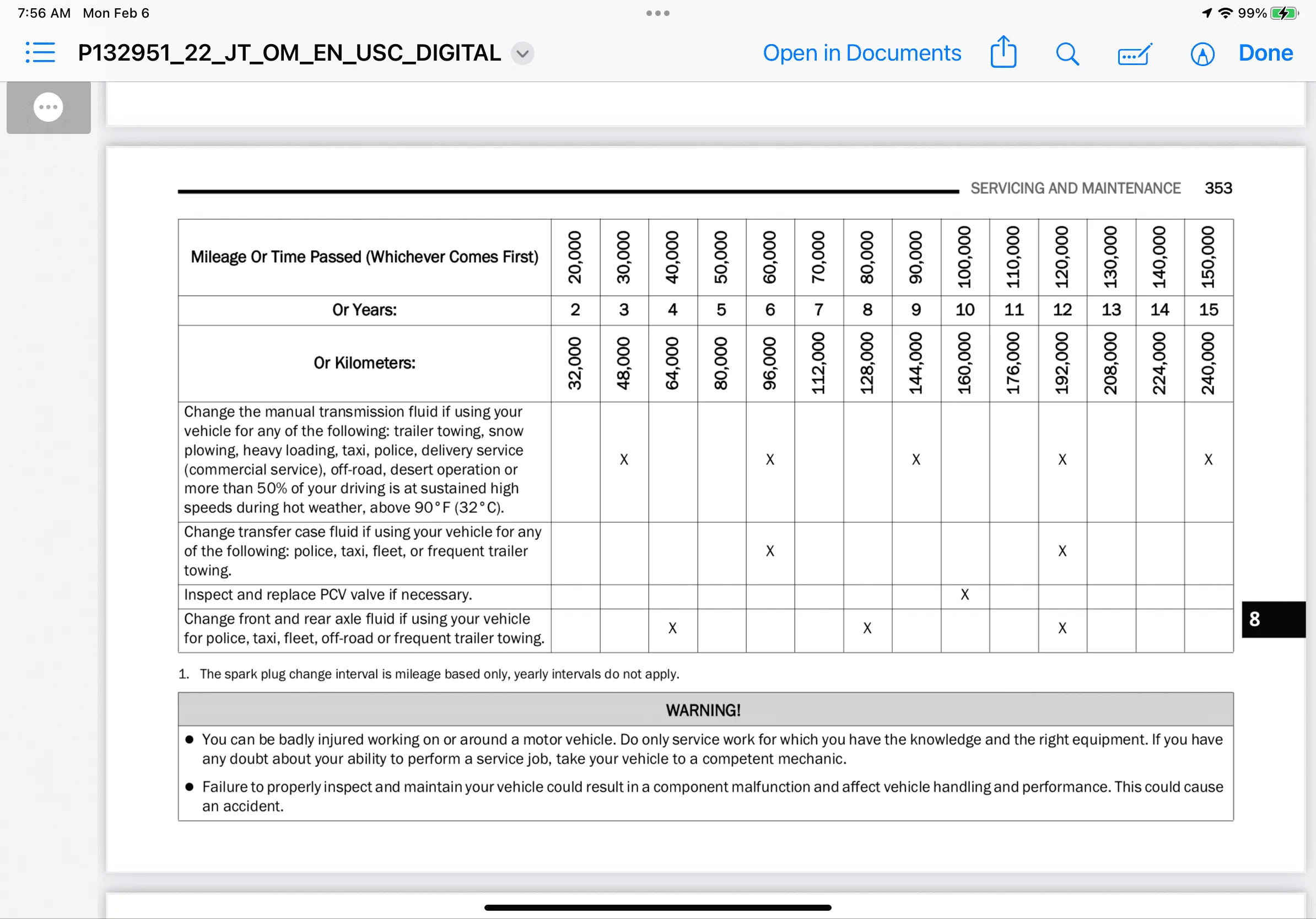

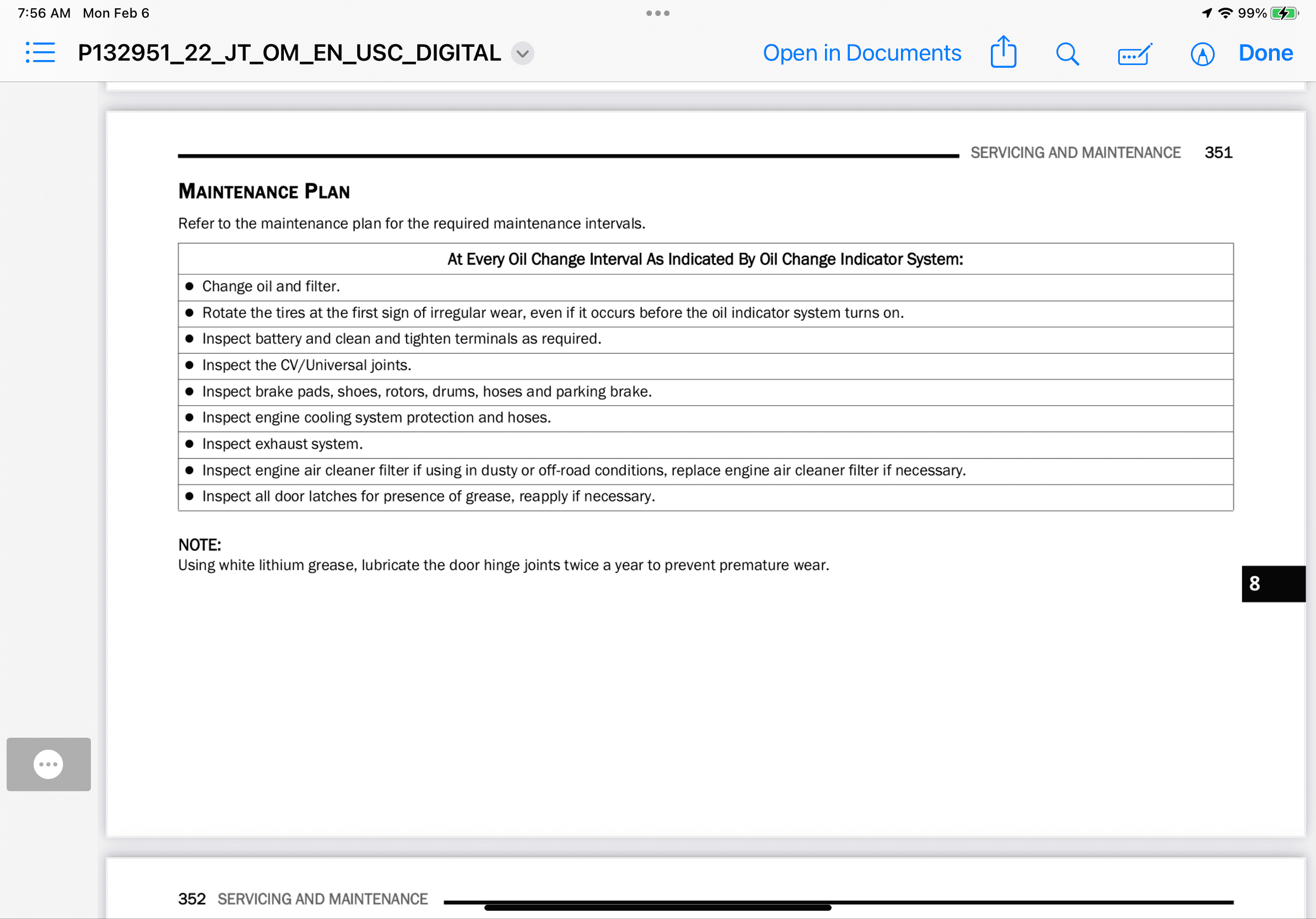

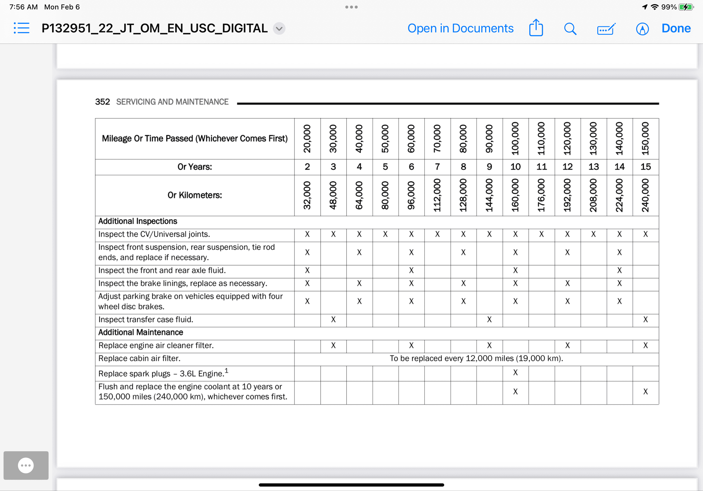

Do I need all this at 30k, I'm assuming the fuel system stuff I can't do myself. Filters I have covered. I can't believe the brake fluid need replacing. And is the 4Ă—4 just service, just draining and replacing diff oil?
From the manual (keep a electronic copy so you can search it easy)
