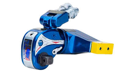

When you want to torque nuts and bolts. You have to use hydraulics. Need Hytorc hydraulic torque wrench. Thousands of lbs of torque.
Jeep Gladiator How "Big" of an Impact Wrench Do You Need? 1707441890491
11,503
30,678
I've used them for years. Steam turbines, gas turbines, BIG compressors, couplings, and gear boxes. Had a head explode one time at the power plant. Hytorc had to put out a world wide "Stop Use" order until they figured out how we broke the head.

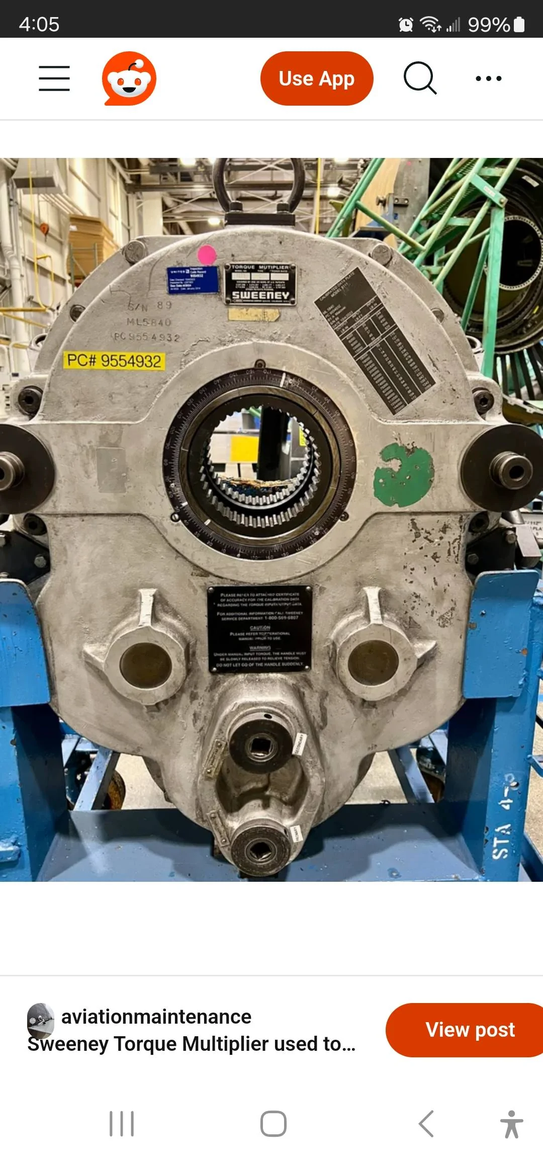

This one we used to install turbine and compressor assemblies. Had to pick it up with a hoist. I
