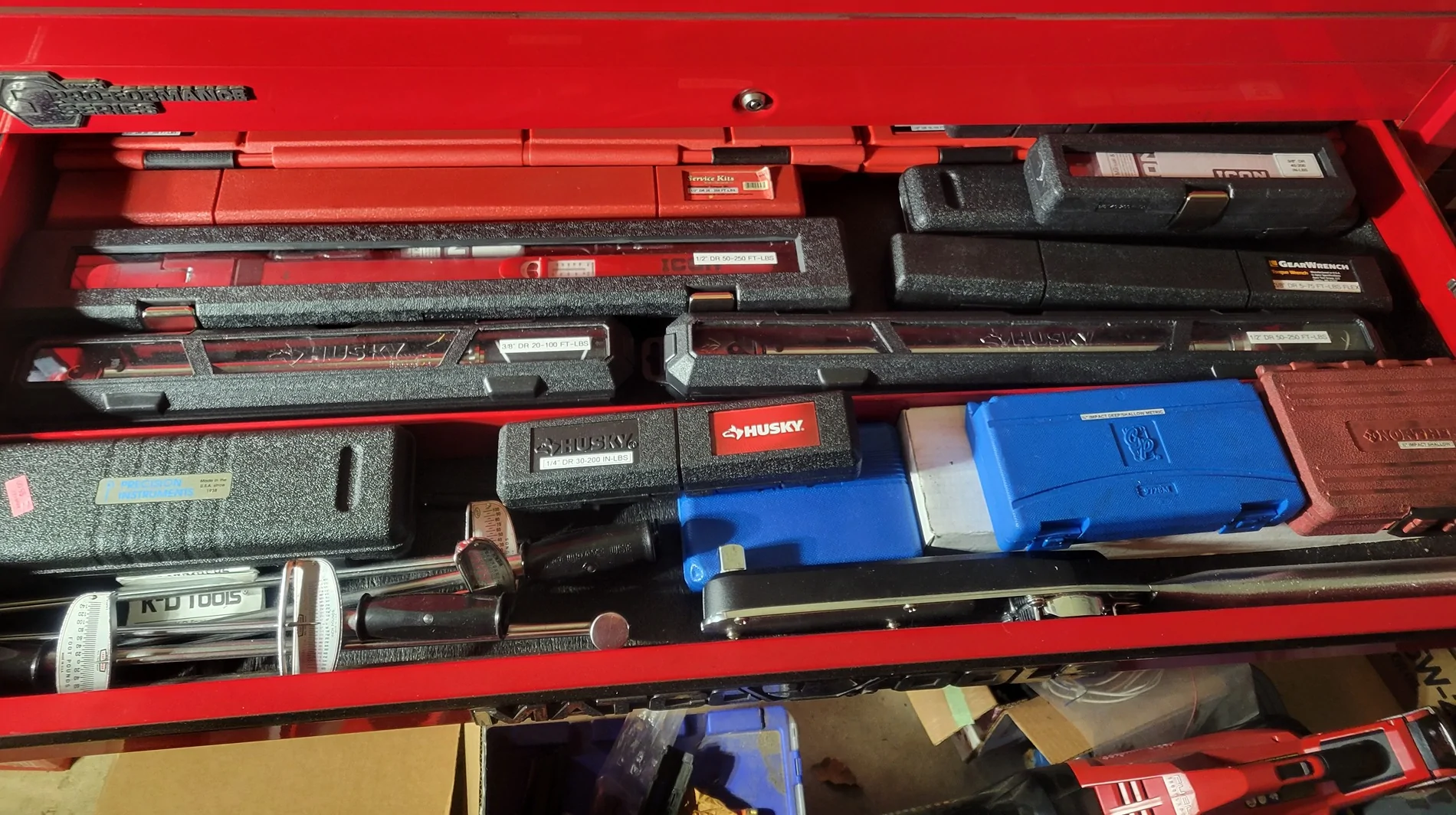

Hootbro
Apr 13, 2019
10,220
20,049
2025 Gladiator Sport
So @Hootbro question for you ,
Are you said that a beam style is better for a crush washer on the pinion than a click type ? While a click type not work ?
You really need a (split) beam or dial style torque wrench for this type of application as you are looking for a rotational preload through the whole 360 degree range of motion. A clicker is not ideal for this type of work.
Also, with clicker style that uses a torsion screw, general rule is the bottom 20% and top 10% of the range is the least accurate. That is why over the years I have learned to have multiple styles and range coverage.
