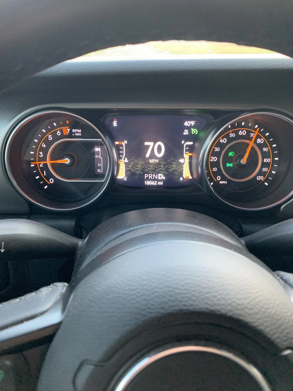

I’m on the fence about 4.56-4.88 seems like I can’t go wrong with either, but maybe post your rpms at 70 in 8th, I know there’s “calculations” but real world is always mixed. Thanks!

@Chaosmtb
looks like about 2100 at 70. The closest I could get tire size/mph using 2 speed apps and Waze was about 1 mph less than indicated. So I was roughly going 69mph via GPS.
I know one thing, with the 4.56 it should be call a Max Sport, lol.
Edit: I just looked at Grimmjeeper and at 70mph it shows 2091 rpm.

@Chaosmtb
Can you confirm this is 8th gear and not 7th?

@j.o.y.ride
yes... 8th gear. Look by the “D”
with 4.56 it will go in 8th at 45mph, I haven’t paid much attention less than
