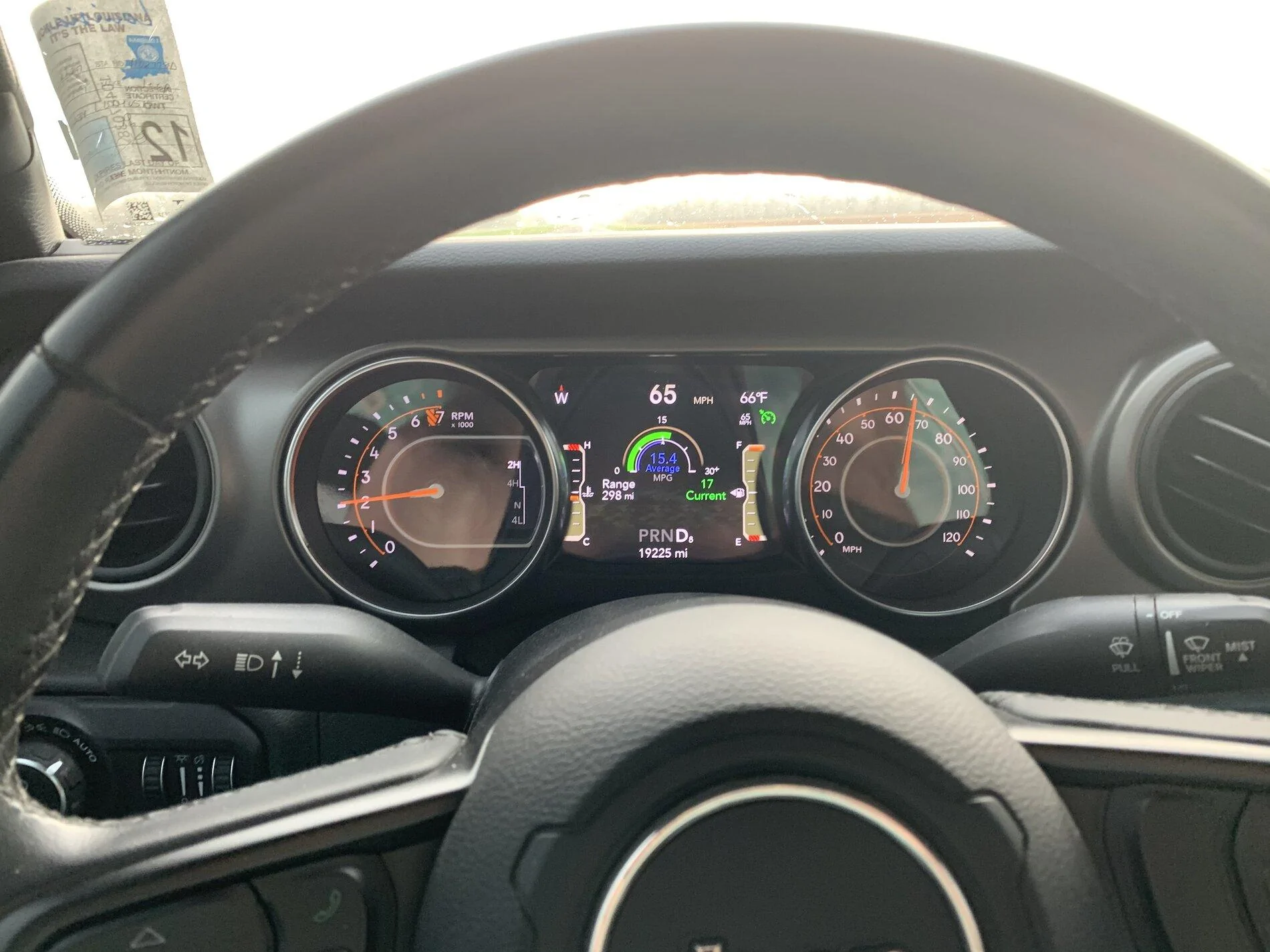

Hey Gren, I’m running 315/70-17’s with 4.56
I see 8th at 45mph, LOL
Here’s a pick at 65mph, just for reference ... speedo is on

@Chaosmtb
looks like about 2100 at 70. The closest I could get tire size/mph using 2 speed apps and Waze was about 1 mph less than indicated. So I was roughly going 69mph via GPS.
I know one thing, with the 4.56 it should be call a Max Sport, lol.
Edit: I just looked at Grimmjeeper and at 70mph it shows 2091 rpm.
Dumb question: Does the digital speedo get it's information the same way the analog speedo does? This looks like the analog shows about 72mph. I just ask bc since my lift and 35" tires my analog seems to be 2-3 mph higher than the digital display.

@brog I’m not sure how the info is sent...the angle from the phone makes it look off “analog” but it reads the same .
