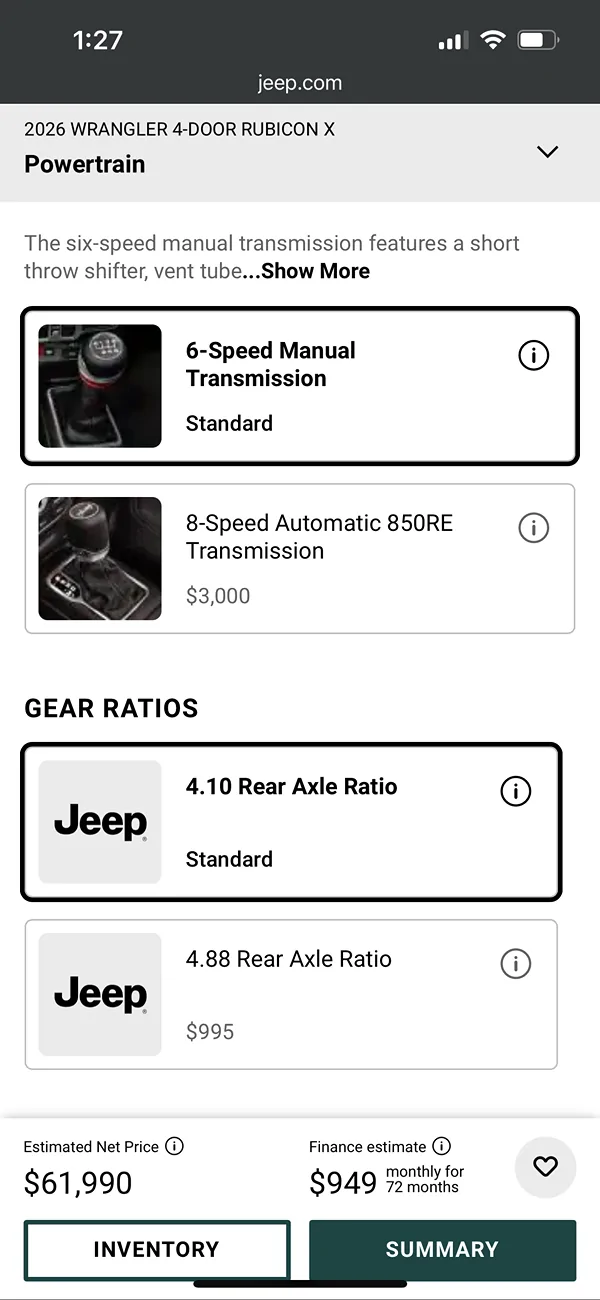

FWIW the new JL Rubicon X (maybe others?) come stock with 4.56’s

You can opt for 4.88 too with some of the JL models.
We have a JLU with the 4.88 gear option. Had to custom order it. The 4.88s are perfect with the stock 33s and manual transmission.
