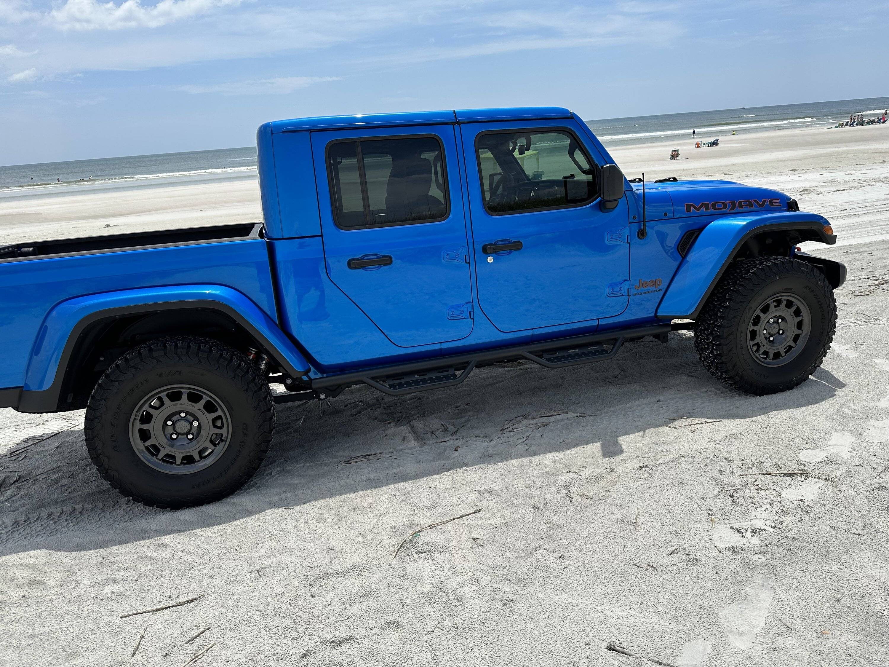

Had a minor rub on the right front rear fender well on a full right turn over bumps on trails at Ocala national forest. Admittedly I had a couple of fellow retired firefighters ( u big-a-boys) on the trail. Got home and used a couple of cable ties to pull the fender well towards the frame.
35s bfg k02 on AEV Salta II wheels.

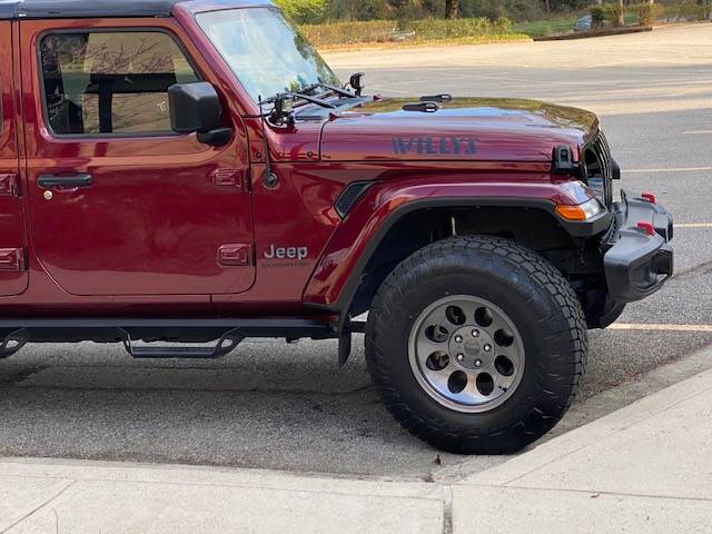

I’ll look for pics of the poke on my setup. Texas Trail edition is same as Willys I believe. I’m running Nitto 305/70/17 which measure very close to 34”. I’ll have to look at the back of the rim to give you offset as they were on mine when I bought it.

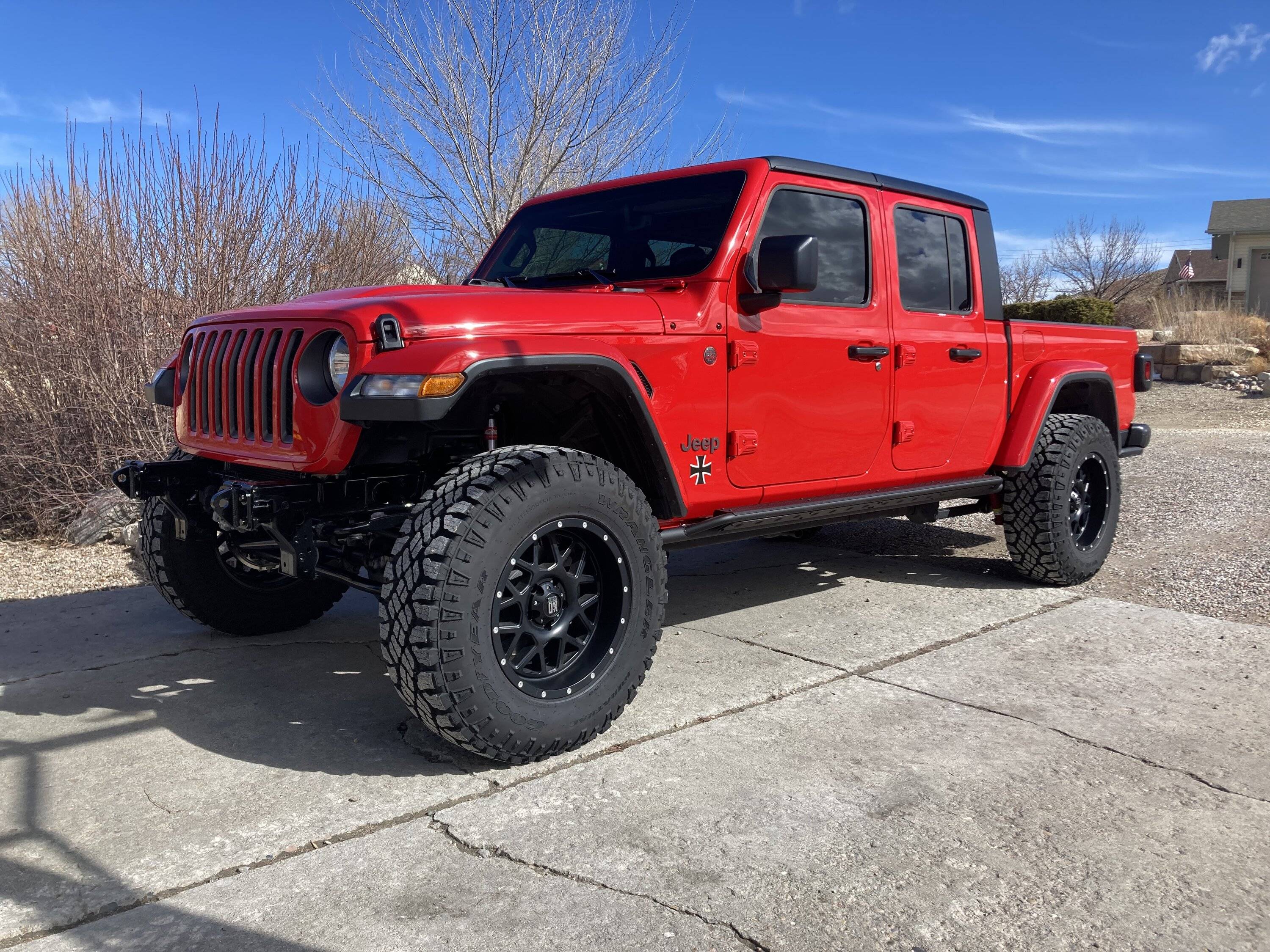

Running Toyo AT3's 35*11.5/17's with just a leveling kit and have not experienced any rubbing. My wheels are a -6 offset. If you stay with the stock wheels, Mickey Thompson makes the Baja Boss in (255/85R17) 35*10/17, if you do you're afraid of the poke.

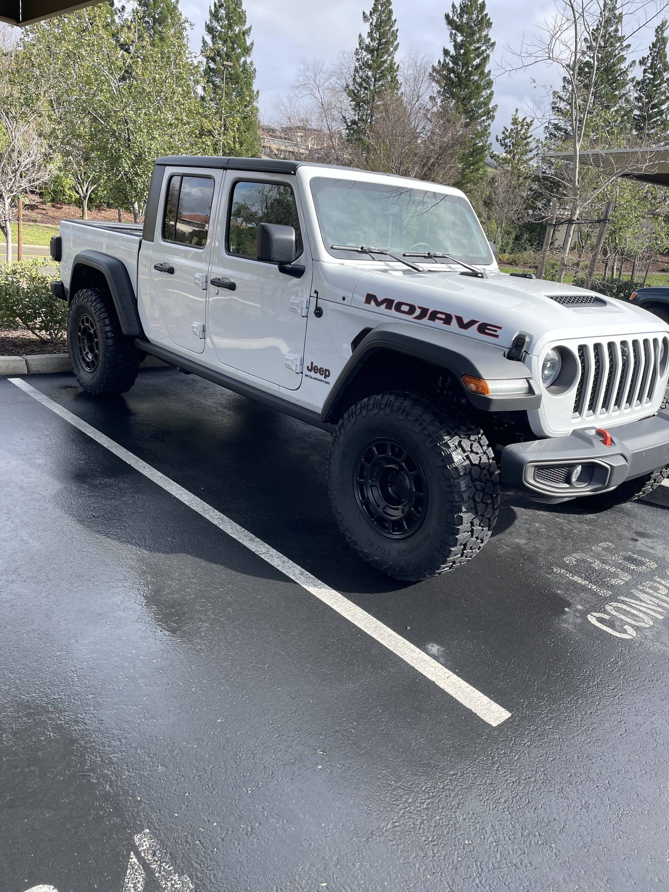

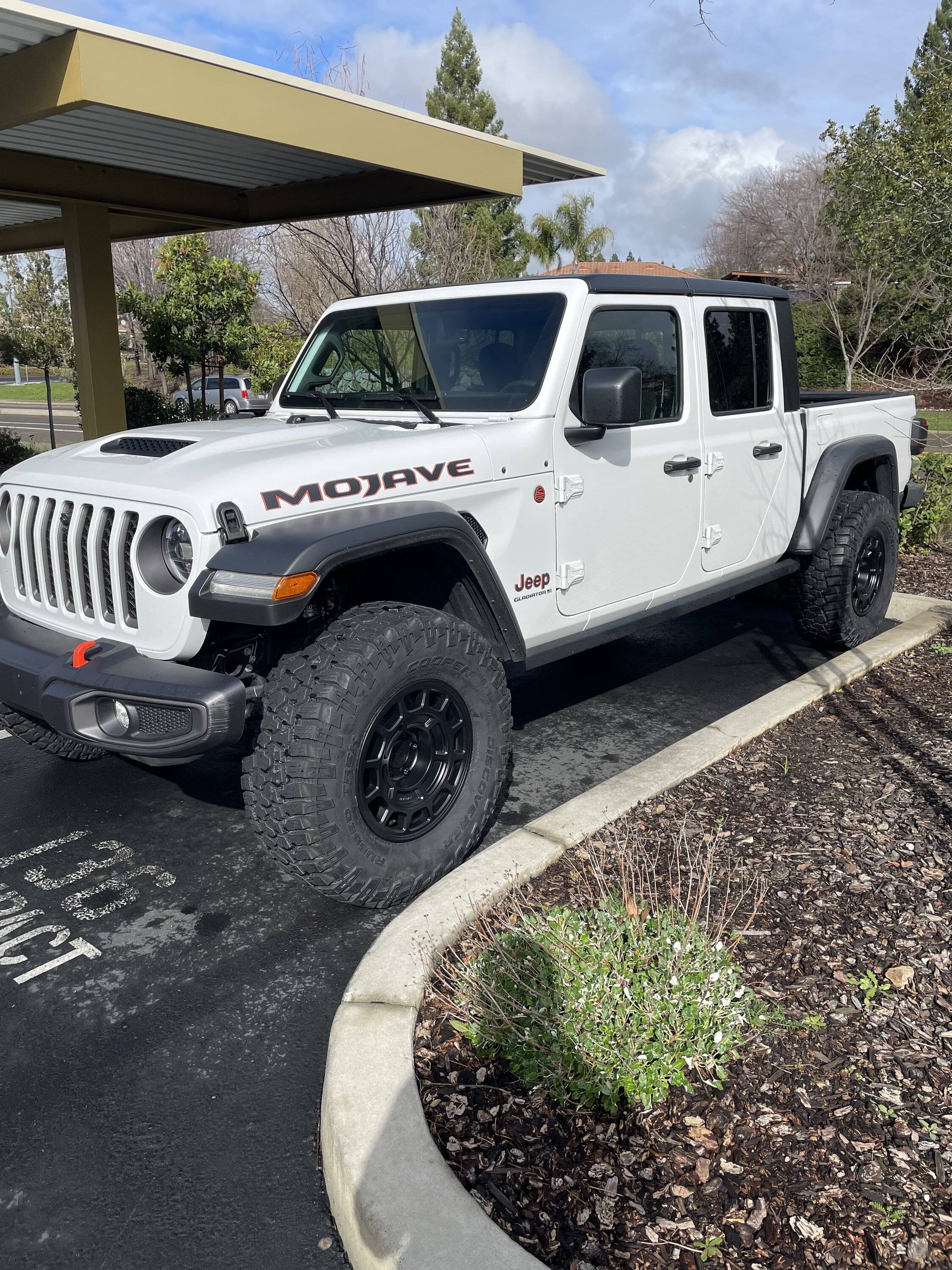

Mojave on 35x12.50R17 Cooper Rugged Trek and Fifteen52 Metrix HD. These tires dont show up in this size on the cooper site but I ordered them through Americas/Discount Tire.

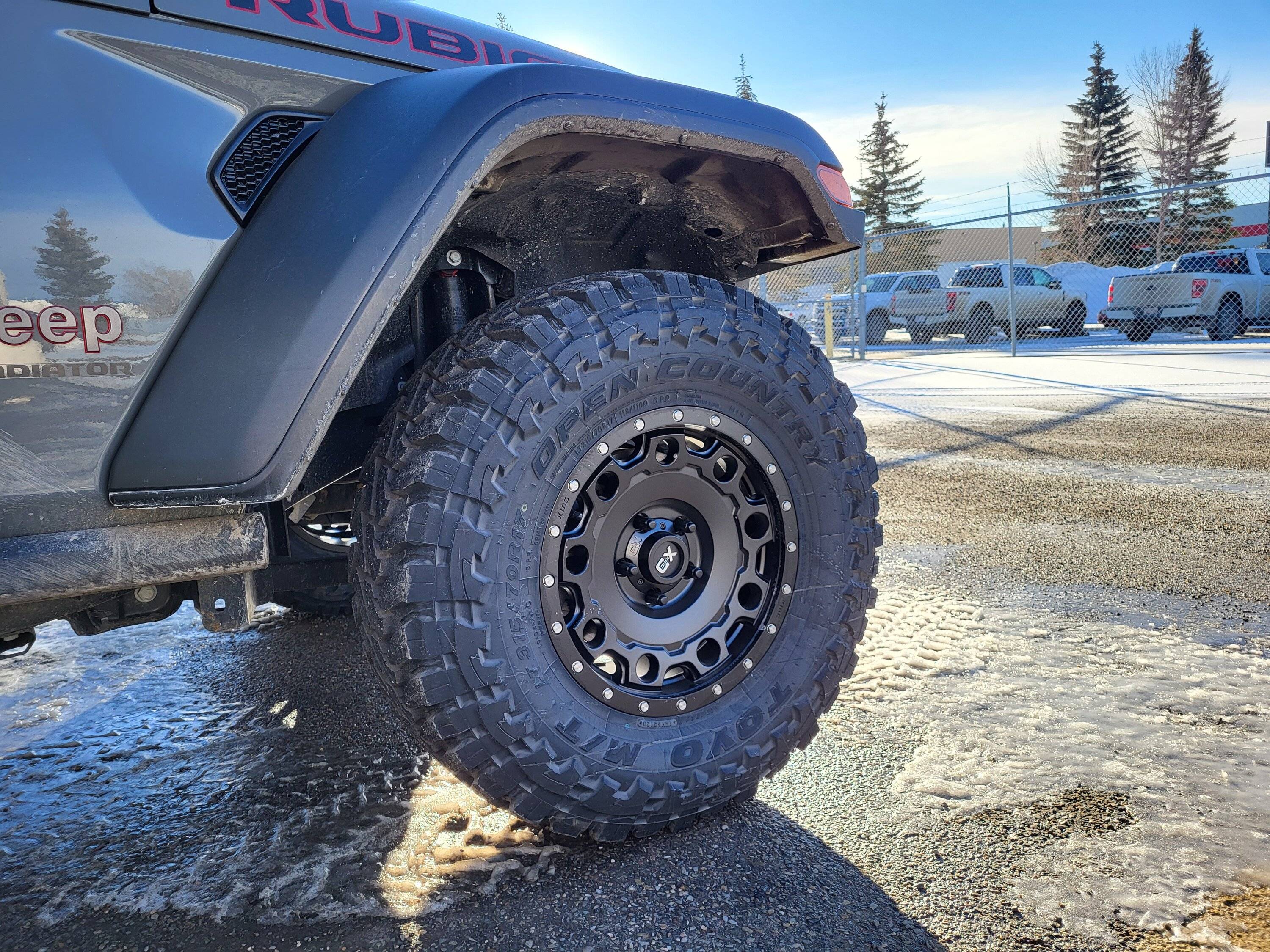

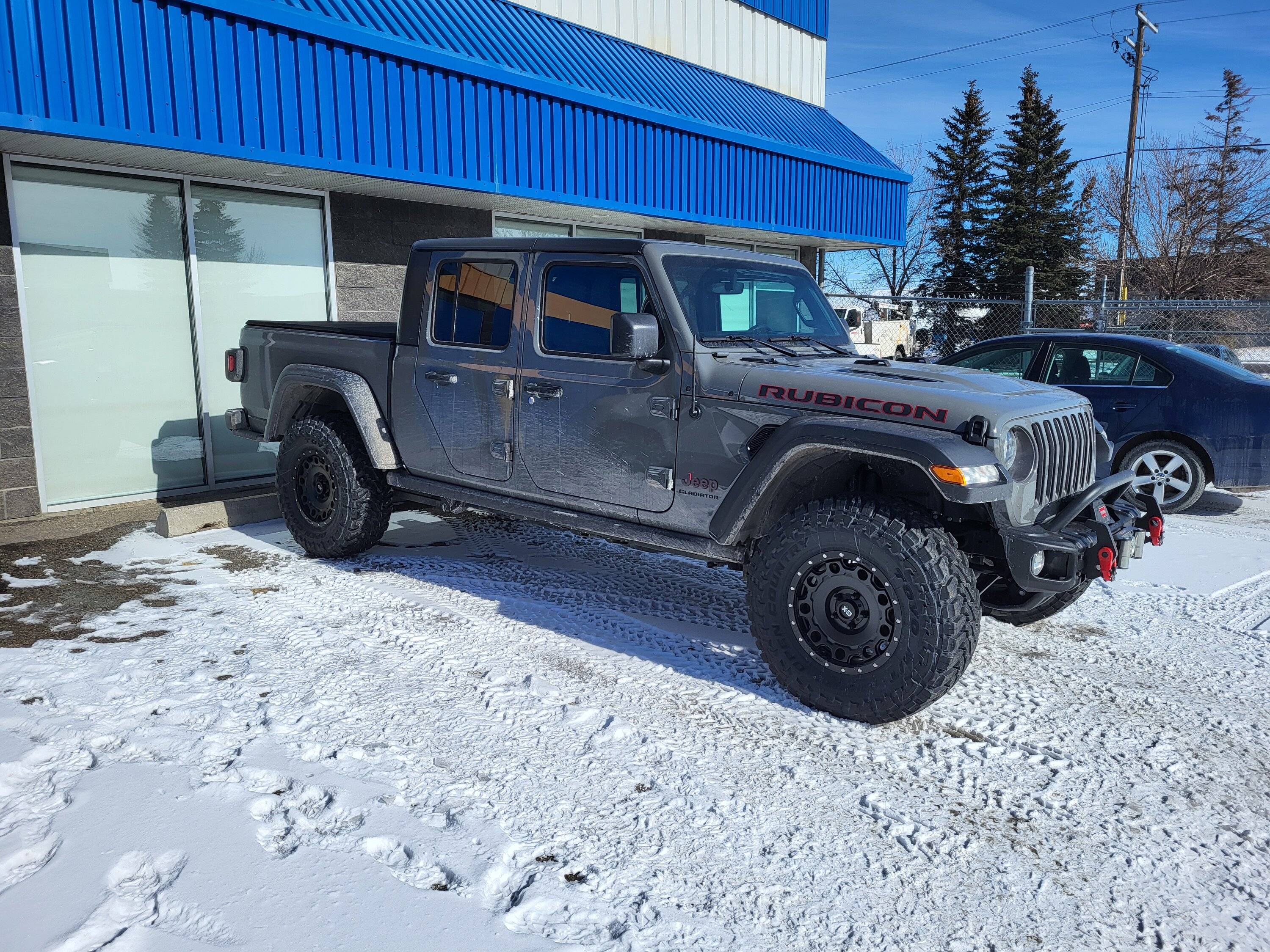

Aug 14, 2023
Canada
2005 TJ, 2010 JKU, 2023 JTR & 2011 Ram 3500 Dually

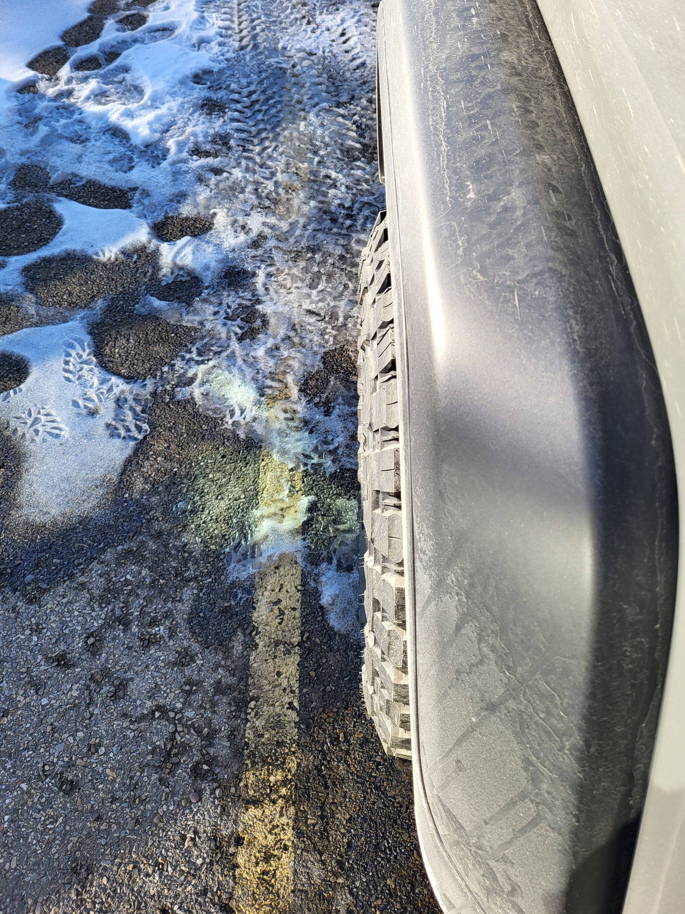

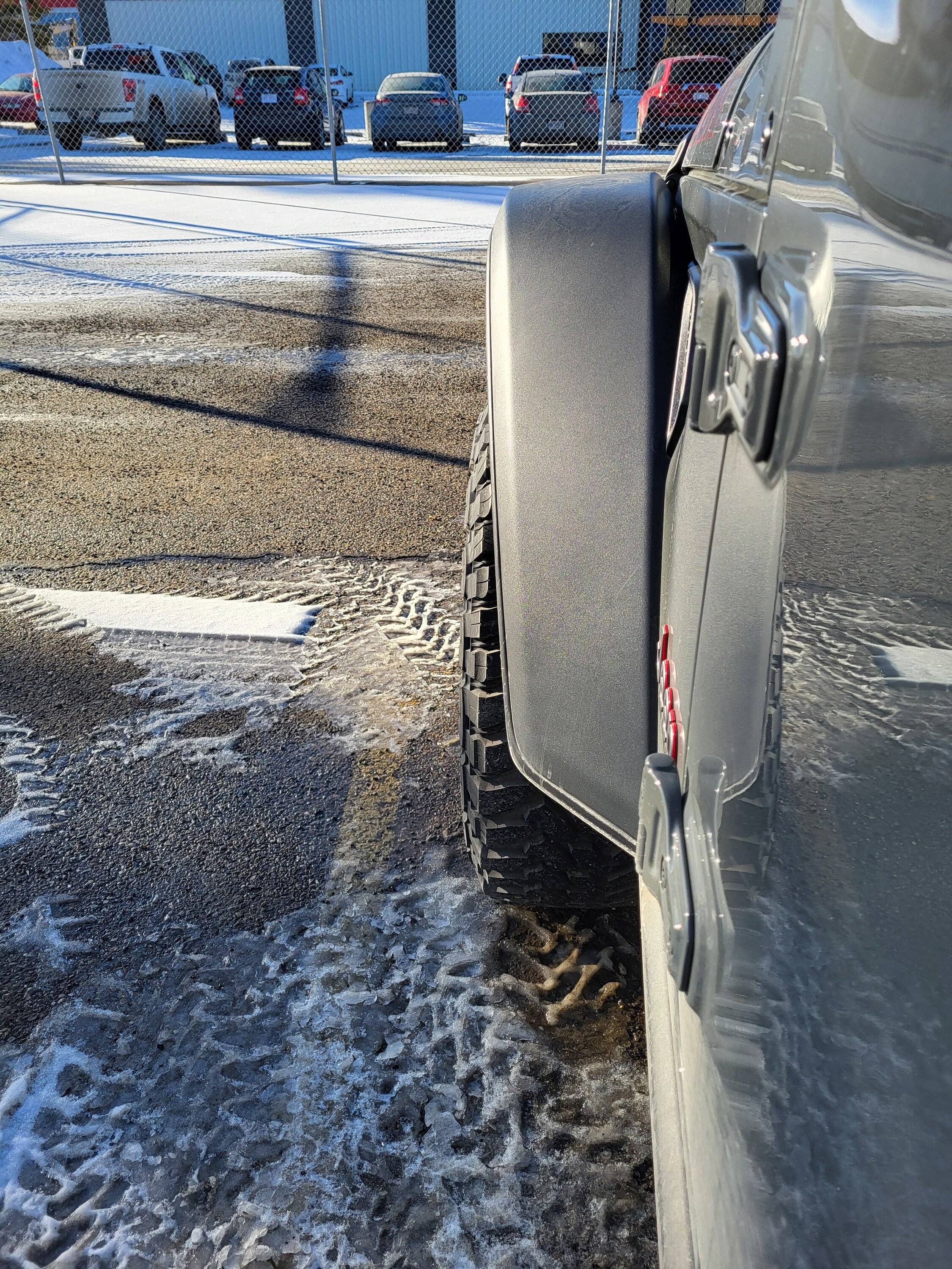

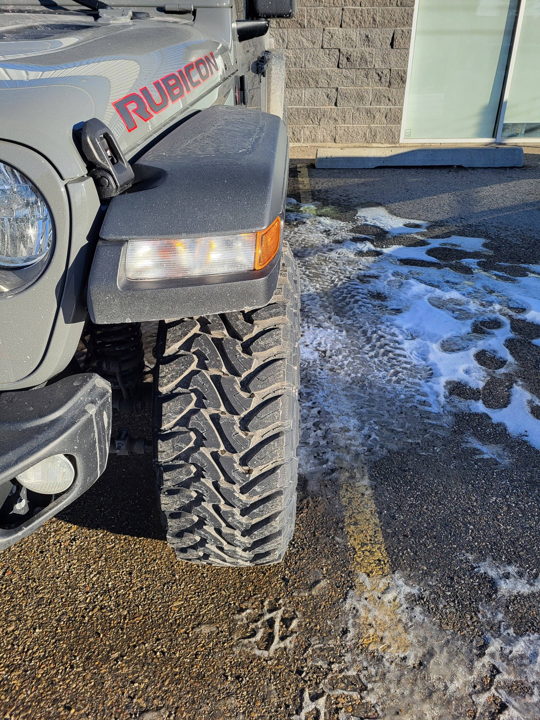

KMC XD129 Holeshot. 17 x 8.5 ET34 which is 6" BS. Toyo OC/MT 315's which measure 34.5" tall. The BS matches the factory rims so all the width went outwards with the clearance inside basically the same. It only pokes the shoulder of the tire leaving the tread under the wheel well. There is a TreaFlex 1.5" spacer in the front to compensate for the winch and level a little.
