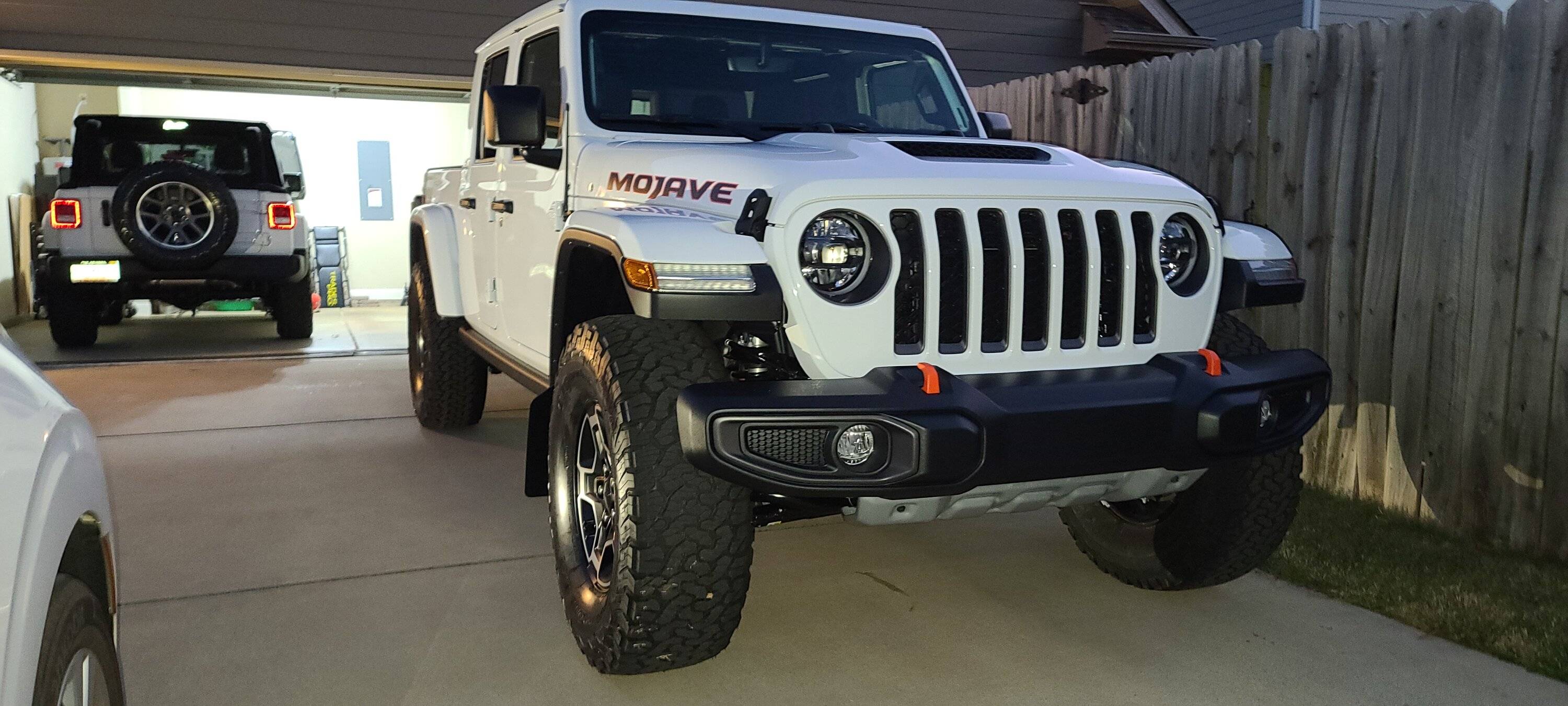

I'm planning to go up to 35s when these stock 33s wear out. My goal is to use the stock 17x7.5" wheels that came on my Mojave, and not add a lift kit. Recalibration of the speedometer is understood. My reference material is here: https://www.drivingline.com/articles/trail-tested-jeep-gladiator-rubicon-35s-no-lift/ -- -- -- The first article/video is about the Nitto, and the second is about the Toyo tire. I'm leaning toward the 35/11.5/R17 Toyo Open Country A/T IIIs.

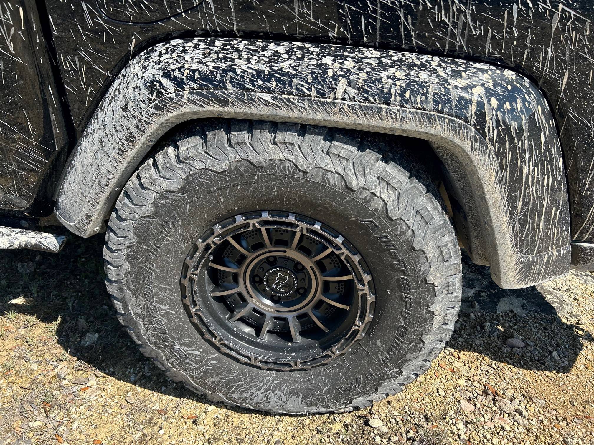

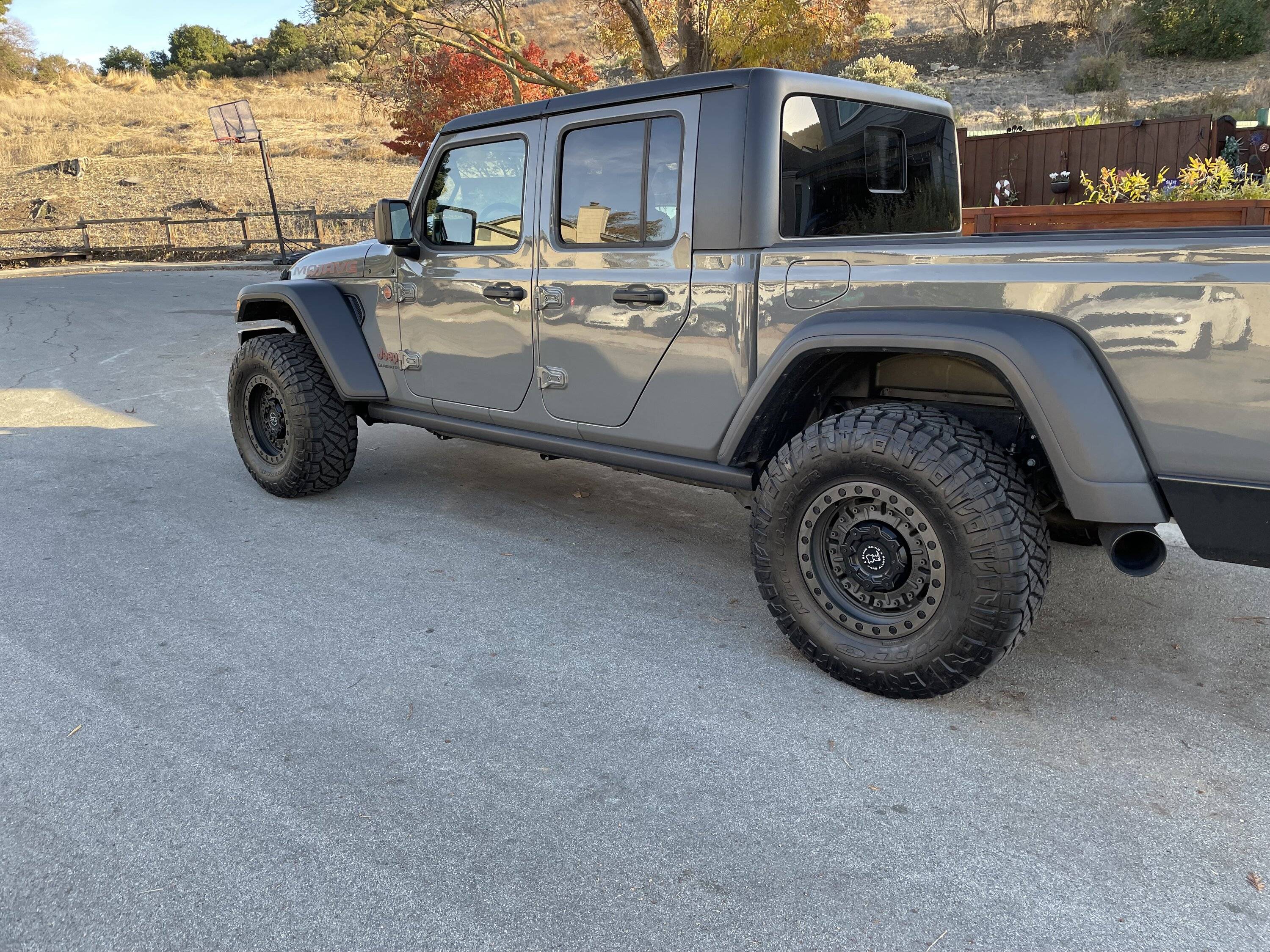

I went wheeling last weekend with the new 35" BFG KO2's with a 2.5" front level but no rear lift. If you value your rear fenders, they will not fit with the stock bump stops. I had to back out as the rear tires were wedged against the stock flairs. It is a wonder they didn't break.
I'll be looking into a small rear spring lift and longer bump stops.
The wheels are 17x9 with 0mm offset, tires are 315/70r17 BFG KO2.
That is the same setup I just purchased. What is your back spacing, mine is 5 inch with 0 offset. Also is your Gladiator a Rubicon or different model?

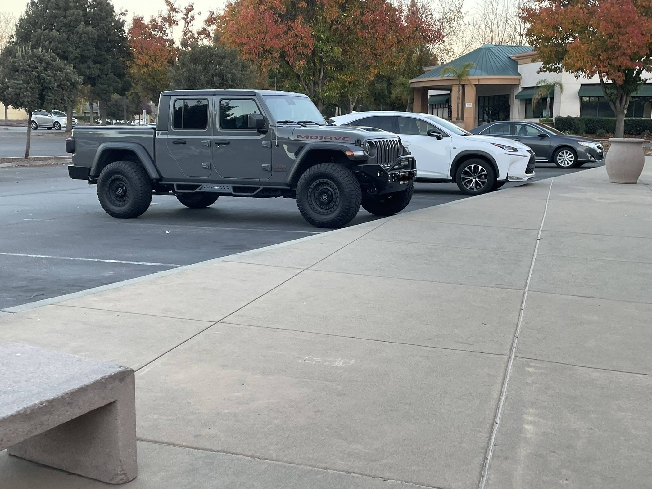

Looking to upgrade my Rubicon from 33’s to 35’s. Any reason to go to an 8.5 inch wide rim (assuming the right offsets, etc) other than a larger supply of tires and a slightly wider tread profile.
No reason, matter of preference. I have BFG KO2 35x12.5x17 on stock wheels without any issues offroading with my 21 Mojave.
