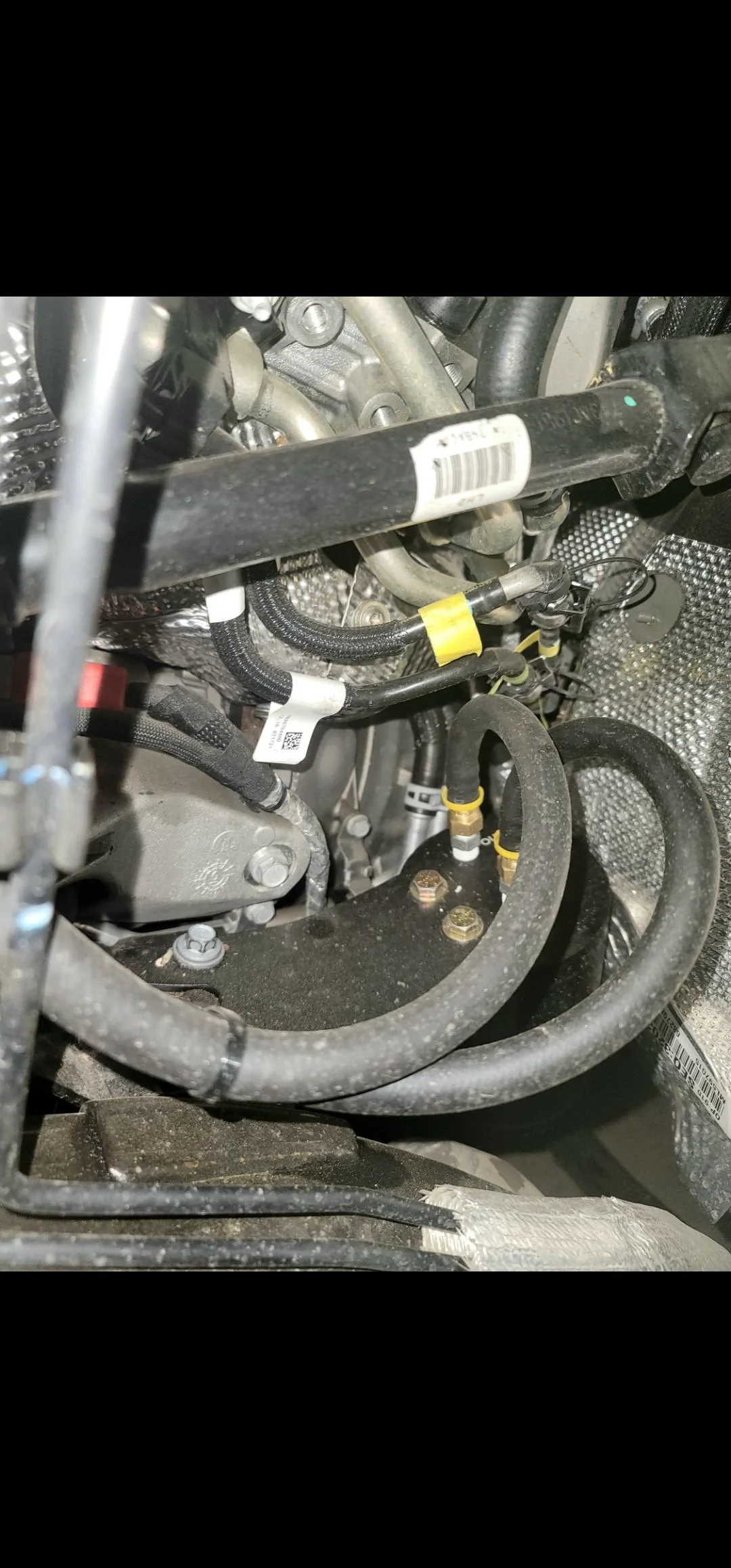

Soo here is the final update on this install. It’s uninstalled.
Both fans have seized up. And the filter housing is not sealing well. So the pros of the system are you can use a cheaper filter. You have access to oil for cooling” need more volume” but it did help. And the cons are have to remove for warranty work it’s another point of failure it’s not cost effective and it’s too low of a volume for any significant amount of cooling. It did indeed help keep the temps down however I didn’t derate before the install either. I think there are better options at this point. It did however keep the oil cleaner looking longer, which is what the system is supposed to do in the first place. So it worked as advertised. The fact my derale cooler fans shit out in 6 months or less makes me mad. If the system was installed in a dryer location they may have lasted longer but that too is an issue for us as we have very little space for that kind of stuff.
