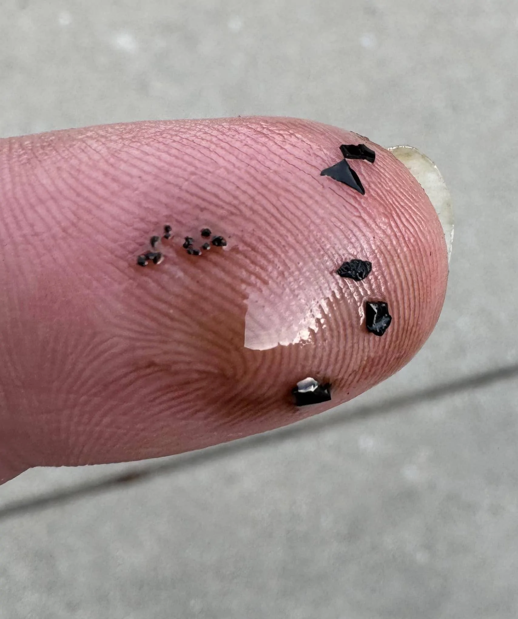

I received warning messages to service electronic throttle and service traction control, CEL for P00AF.
It sounds like the issues you had were not a design issue, but an isolated quality control issue. For example, the P00AF code that you experienced is a quality control issue. Very few EcoDiesel owners will have that issue, but those who do usually experience that code before 40,000 miles. The remedy as you mentioned is a turbo replaced under warranty.
I did notice a fair amount of tiny carbon deposits in the oil that came out. What I believe was happening was the oil pickup was beginning to become clogged from soot deposits like in this video. I never pulled the oil pan to confirm, so this is just an assumption (note, the video is of a Gen2 3.0 and the JT has a Gen3).
The carbon is from a copper fuel injector seal leaking. In short, the top injector seal doesn't let the compression gases escape from the head, so it forces gases under the valve cover. The hot gases cool and form carbon.
